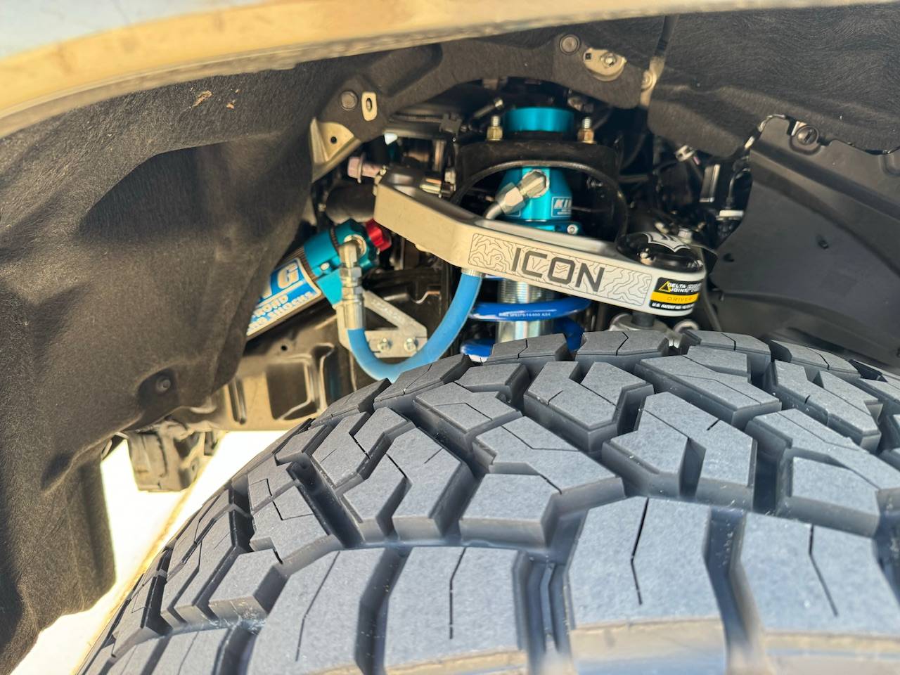

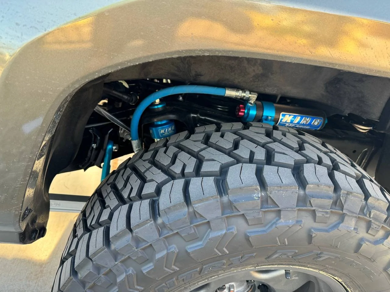

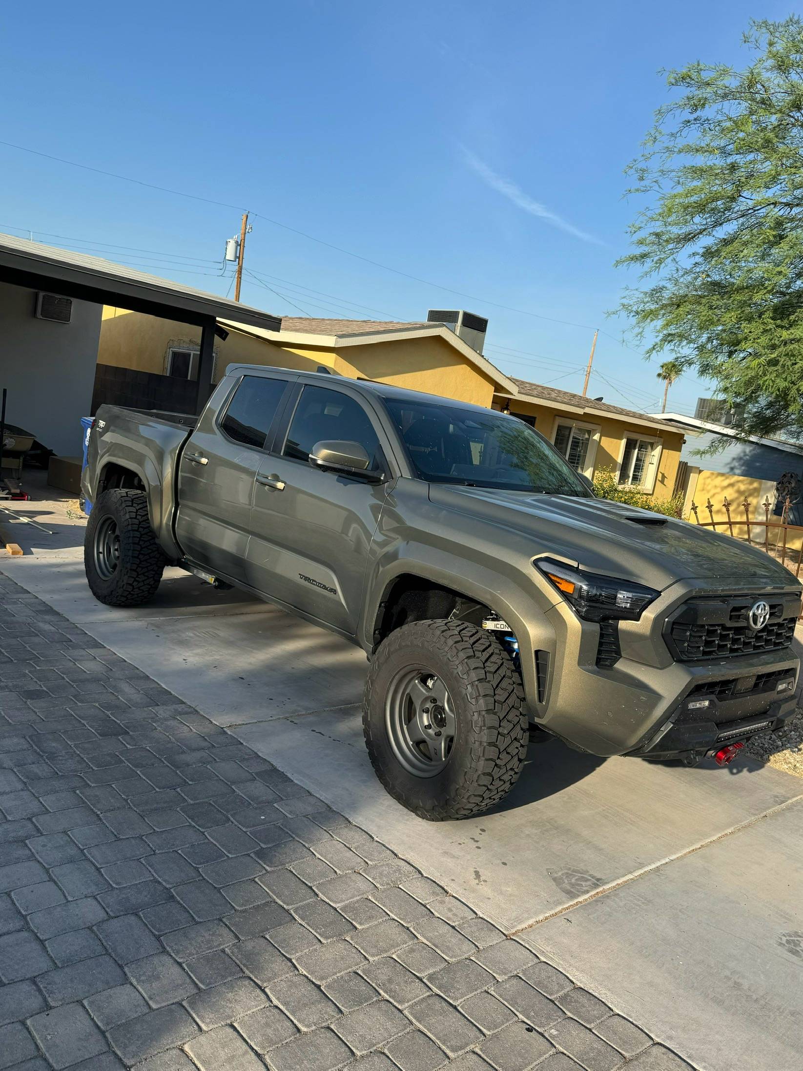

Just finished installing the lift. Went with king shocks, 600lb preload in the front. Icon billet UCAs, king rear sway bar link, icon billet upper and lower trailing arms. Just waiting for icon to release the rear springs to get rid of the slight rake. Toyo open country RT 295/75/17 rubs a little with the +10 offset

Thats an awesome setup. What Bumper do you have on it, is that the CBI?
I was looking into it but put it on hold since I noticed they are coming out with a simpler one soon. Curious as well what winch setup you got and if you had to relocate the control box? I'm super OCD and freaks me out to cut the bumper and the lines aren't good.

It’s addictive desert designs manufactured here in Phoenix. I have a warn evo 10k

That's the most amazing setup I have seen so far! I have TRD Sport in exact same color and haven't pulled the trigger on installing anything. How much was the Kings suspension cost + installation? Did you do any lift? I probably won't pull the trigger on everything just yet but can get at least started with suspension. Do you think that would make sense?

I did the king 2.5 with adjusters on the front and rear (you have to get the rear sway bar links as well):
https://kingshocks.com/i-30508060-25001-408a-2024-toyota-tacoma-2-5-front-coilover.html?q=
I did Icon UCAs, Track Bar, Rear Upper and Lower Trailing Arms:
https://www.iconvehicledynamics.com...billet-upper-control-arms-w--delta-joint-pro/
https://www.iconvehicledynamics.com...-tacoma-rear-billet-adjustable-track-bar-kit/
https://www.iconvehicledynamics.com...024-toyota-tacoma-rear-billet-lower-link-kit/
https://www.iconvehicledynamics.com...024-toyota-tacoma-rear-billet-upper-link-kit/
Kit was around 8-9k. Install was a lot easier on this gen.
I am still waiting for ICON to release rear springs.

Where did it rub? Was it an easy part to trim?
A little bit in the rear only on full turns pretty much went away when I adjusted preload on the kings although it may rub when I’m full turn off roading

34s with positive offset and a 2.5 lift rubbing seems wrong. I believe you but everything up until you says they will clear no problem. Crazy.
Those are SCS wheels so they’re probably
(17x8.5-10)
