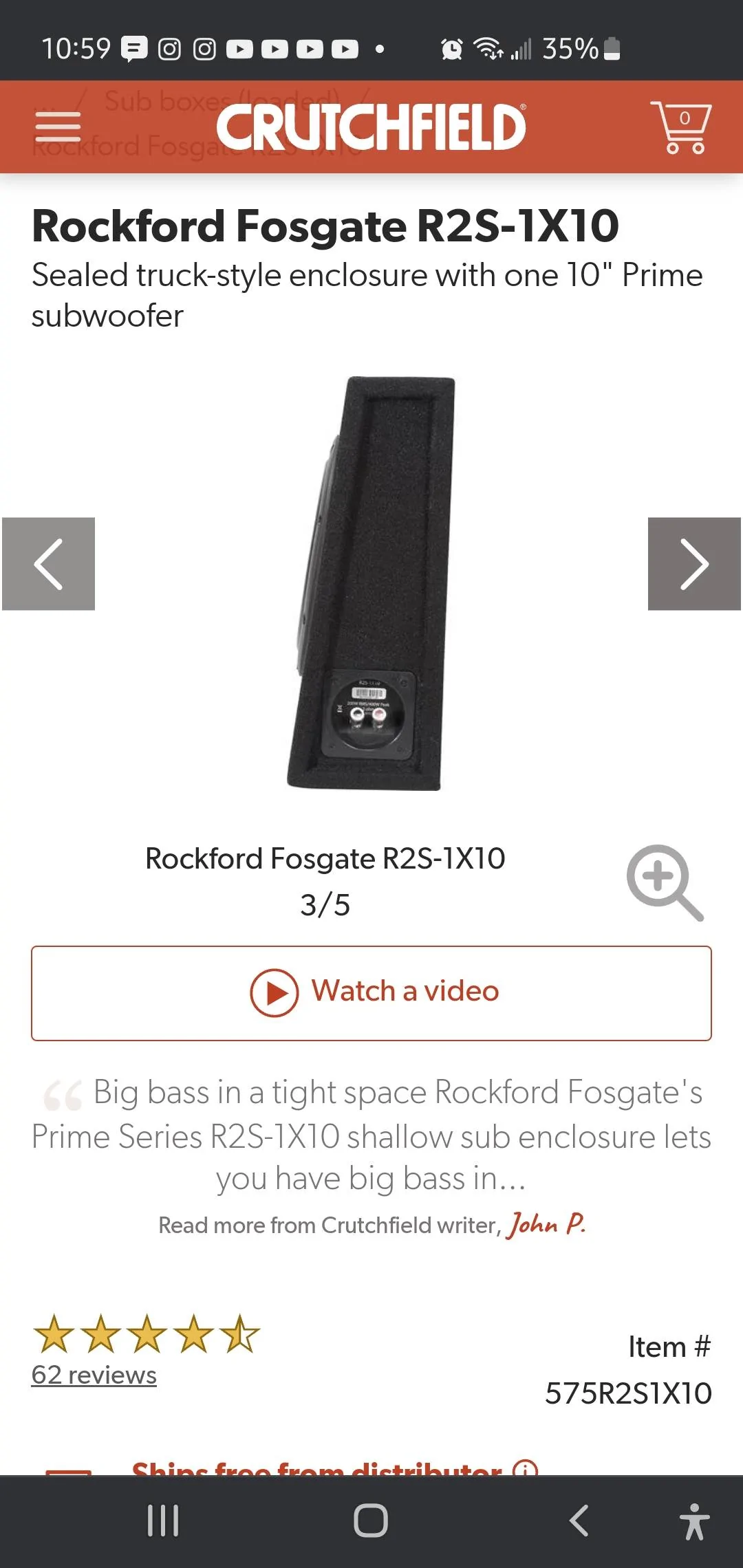

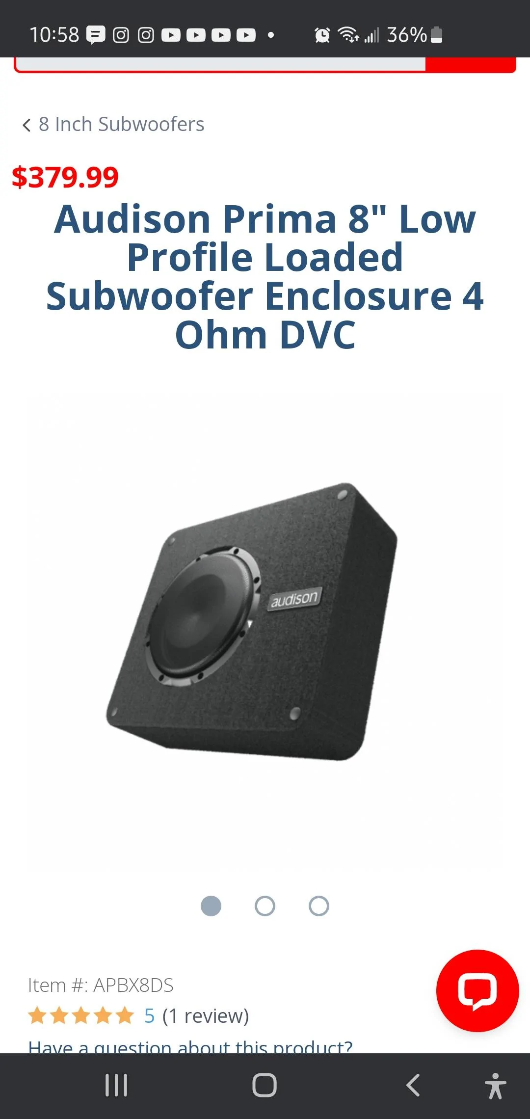

Not sure if you found a fix but my initial thoughts are and keep in mind this is with retaining use of existing subwoofer factory wiring..cause if you're open to running new wires then it opens more possibilities like sub under seat but anyway
1. Easy - add the Beat Sonic in dash amp to improve factory system overall volume and bass.
2. Medium - measure space available behind rear seat(s) and try for a low profile wedge shaped pre-built enclosure to replace factory sub.
3. More in depth - make an enclosure to house the factory sub to improves its bass potential or better yet buy a better shallow woofer and make custom enclosure and repurpose that factory bottle jack mount as a mounting stud for your custom sub box. Sure you'd need to find a new home for bottle jack but that's doable I'm sure. If you go this route makes use you double check ohm rating of sub so it pairs well with the JBL signal feed.
Here are a few screen shots of items mentioned in my examples. I'm not dure that the enclosure will fit you'll need to grab a tape measure but they are more examples than anything.
Keep us posted on your progression. I'm waiting on truck to land and I'll be upgrading audio once it does.
Good luck!

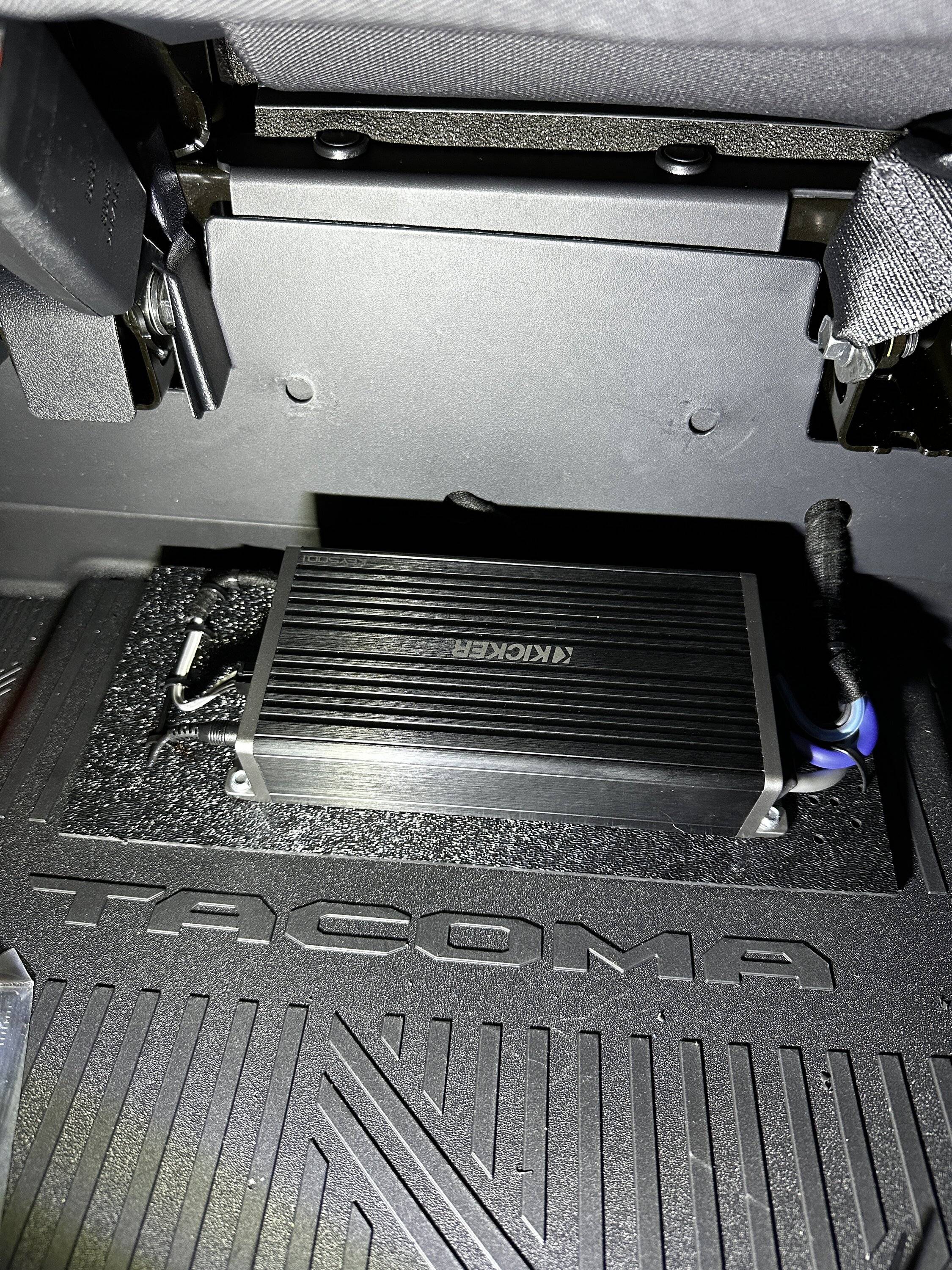

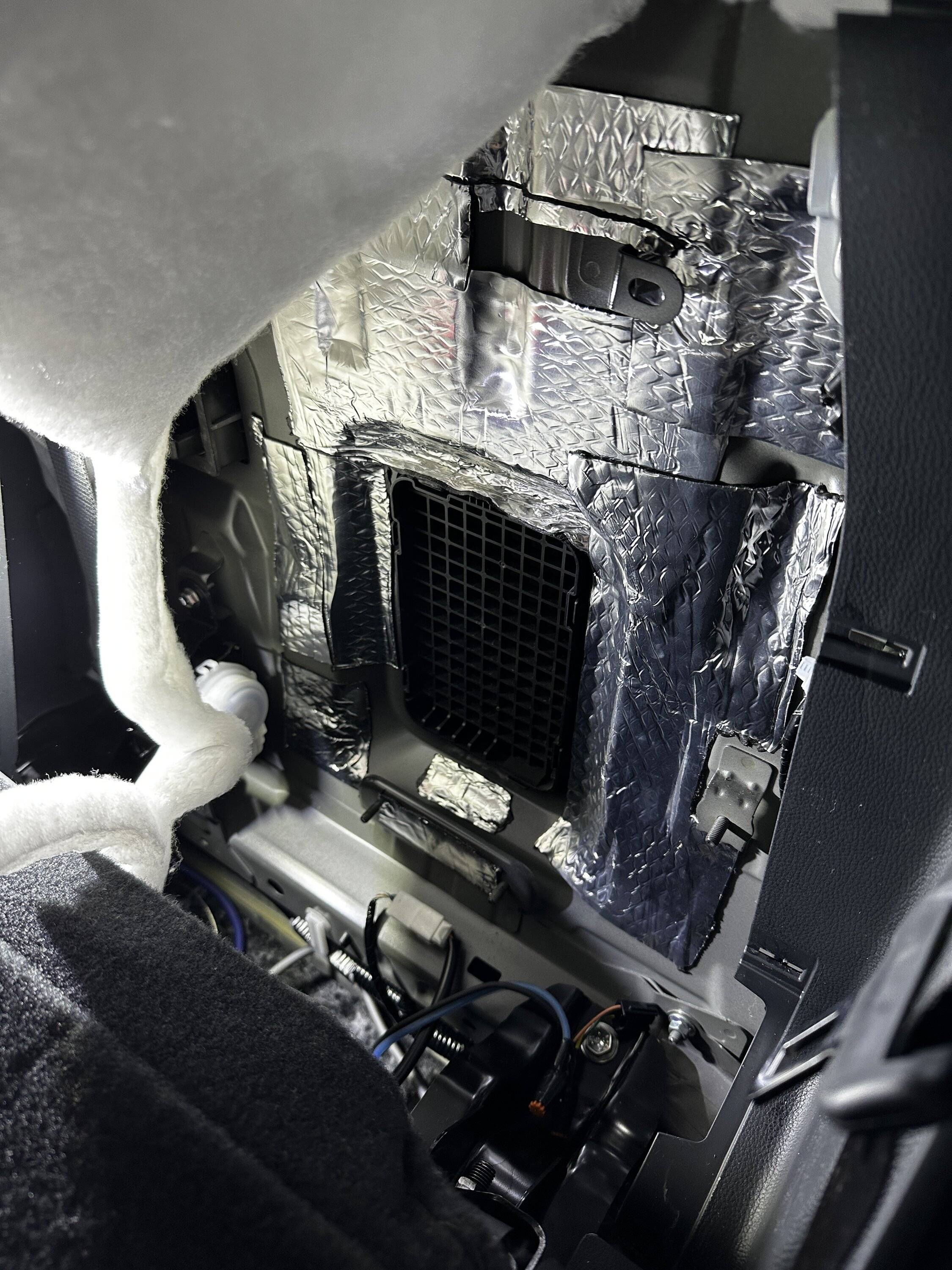

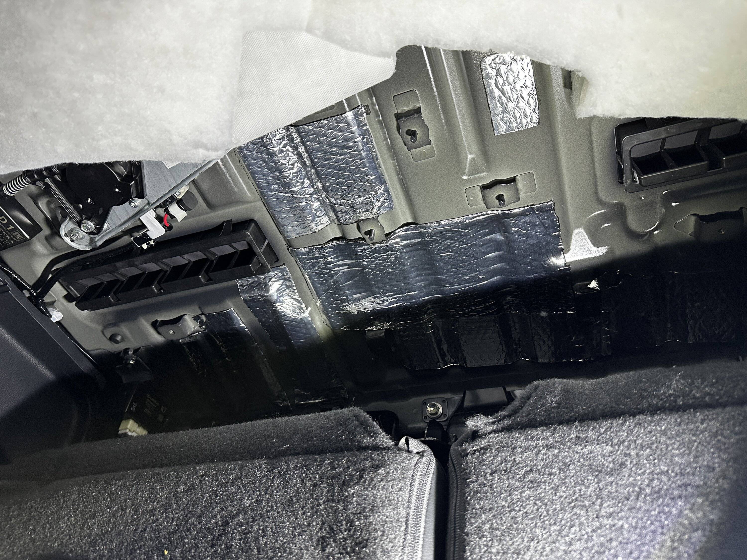

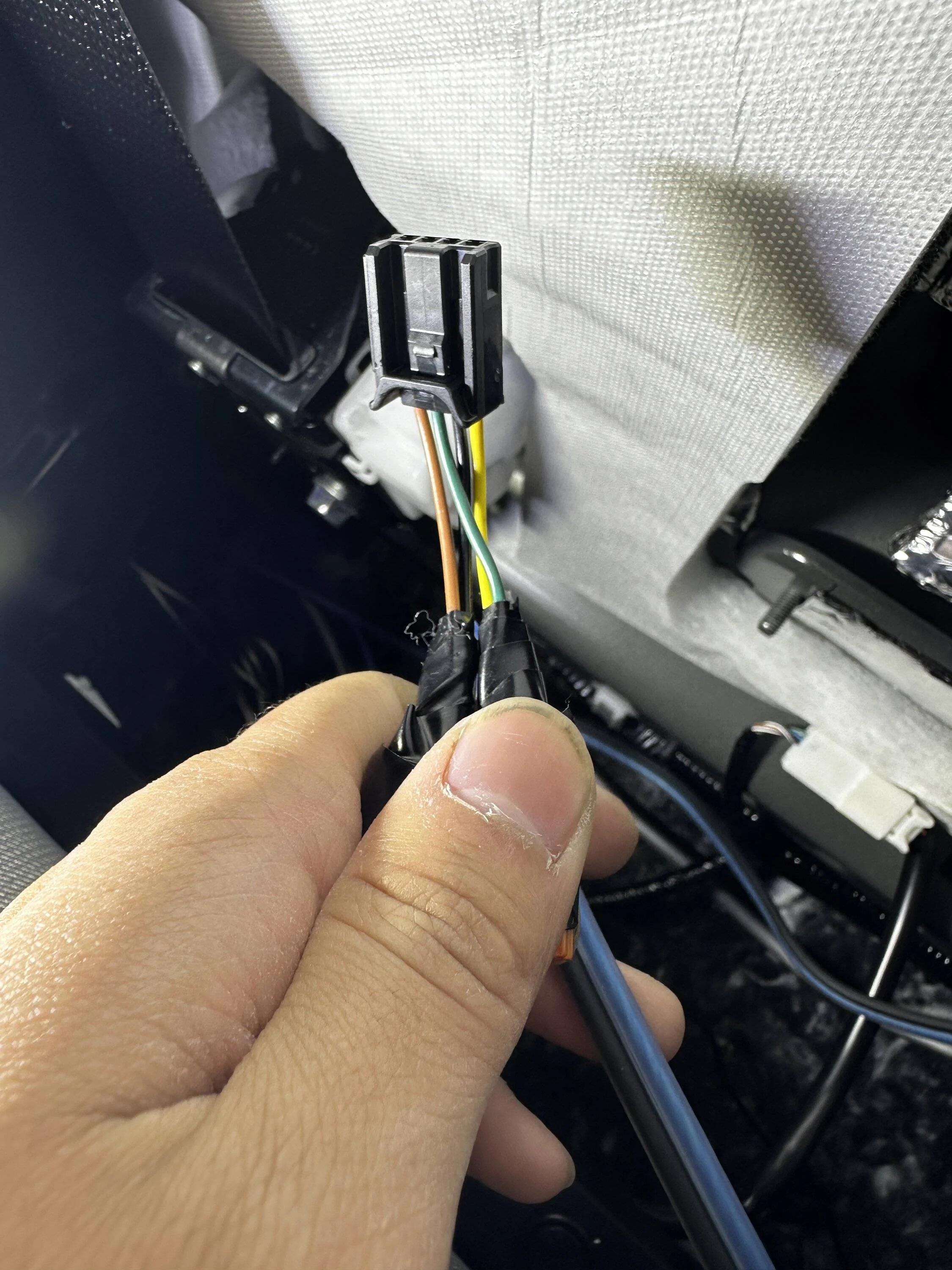

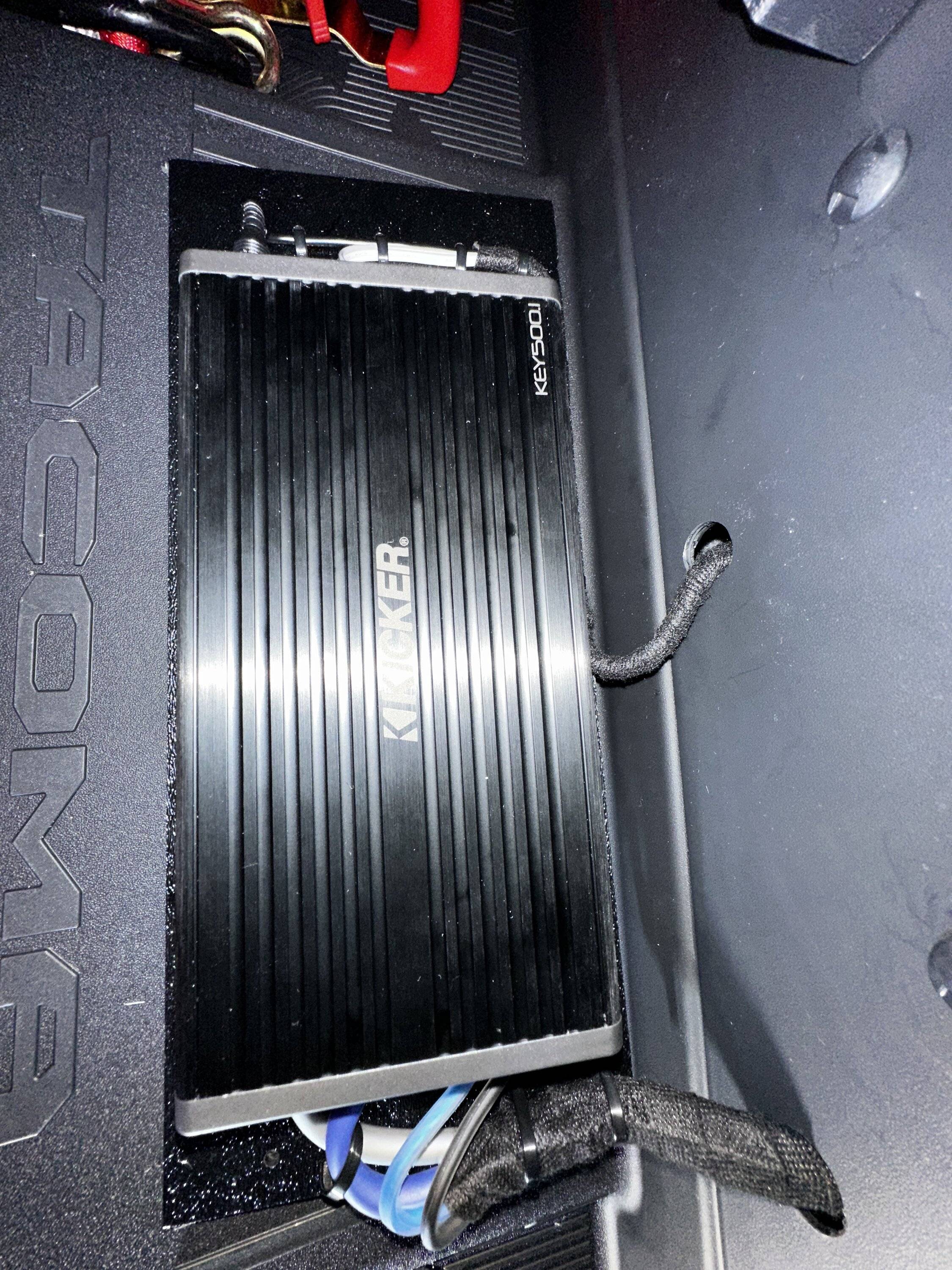

I was able to find a temporary solution that has satisfied my needs for now. I ended up cutting the wires feeding the factory JBL 10" subwoofer and adding in a kicker key500.1 amplifier. Used the factory wiring to get my signal. With both voice coils wired in parallel, I ended up getting around 5.5 ohms from the factory sub. I believe with this setup the kicker amp would be outputting around 150 watts as its closest to the 4 ohms rating. It definitely helps the factory subwoofer hit a lot deeper. I would say its better than having an under the seat powered subwoofer. After adding the amp, I did hear some rattling outside of the truck so I added some sound deadening on the wall. I also mounted the bass knob on the factory blank next to the jellyfish launcher. I've been leaving the knob about half way. I don't have a video of before/after but I'm sure video won't do it justice anyways. I'll wait until someone comes out with a custom enclosures for the 4th gen tacomas to upgrade the subwoofer at this point. I haven't found a enclosure online that will fit without significant cutting. There's only about 4.5-4.75" of clearance down where the seats mount onto, to the wall. The slimmest box I was able to find was still at least 5.5"
I have it mounted under the rear seat in the middle.

I used a NVX 4 gauge OFC amplifier wiring kit. On the passenger side behind the battery, there’s a factory grommet with a factory wiring harness. I just cut a hole and pulled the wiring through.
