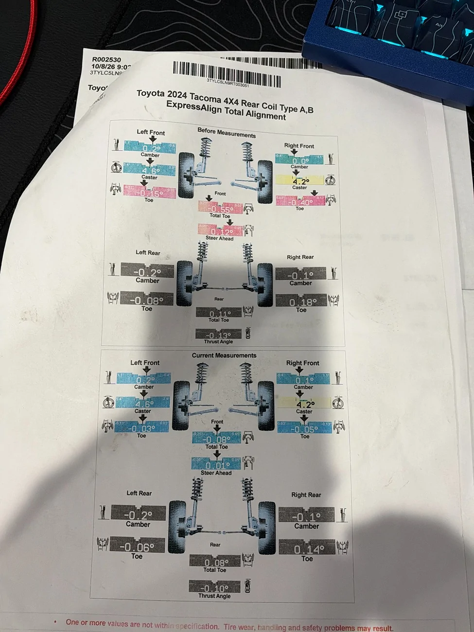

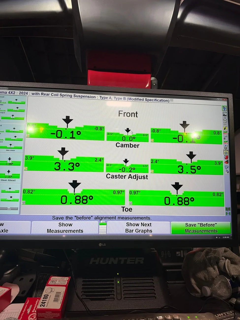

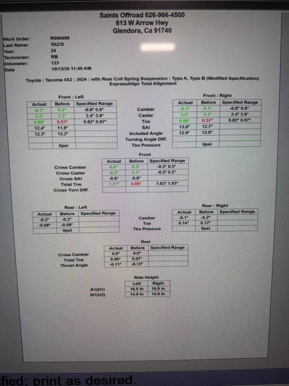

I have spent $ 1k on alignment this month, going to 4 shops in the greater Los Angeles area with no success. My truck is currently equipped with Dirt King UCA AND FOX PES.
Toe, for me, seems to be the big issue. A technician today left it at 88 degrees and stated that, due to the alignment machine they have it says its 88 but its 18, it's within the 18-degree spec.
I am exhausted of having to come home and check the torque spec of the cam bolts and having them always at 110 ft-lbs every single fing time instead of 207 ft-lbs
My last resort is going to the dealer because screw local shops, man; I'm sick and tired of their bs.
