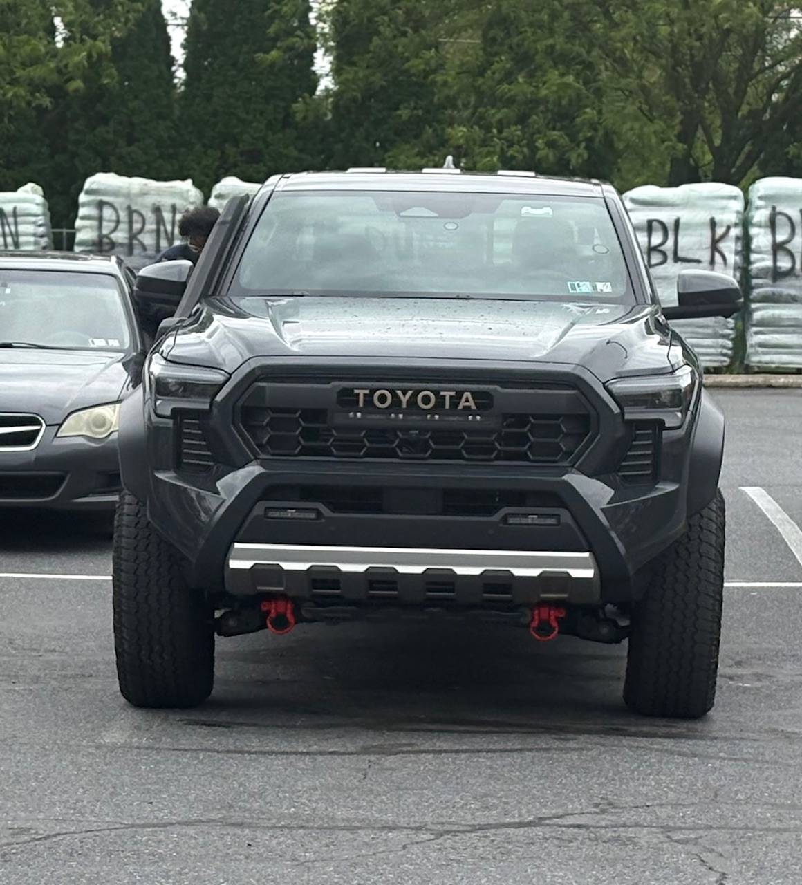

Hopefully, I can put this together without long summary. February 2025 noticed front tires wearing heavy on outside tread. For sure too much camber. Took it in for the 5000-mile check and yes dealer noticed this as well. So, they rotated back to front and took two days-two tries to align. Received the truck back and the camber is ridiculously too positive. Shown the spec and of course it is in range. This is what they gave me, and the front looked ridiculous with the pigeon toe look. Dealers started using sentences that this is what the alignment calls for. Nice picture ?
Front Left​
Front Right​
Actual​
Before​
Range​
Actual​
Before​
Range​
1.4​
1.6​
.07-2.2​
Camber​
1.4​
1.4​
.07-2.2​
2.9​
2.9​
2.3-3.8​
Caster​
2.6​
2.6​
2.3-3.8​
0.5​
0.61​
.43-.58​
Toe​
0.5​
0.87​
.43-.58​
Just returned from long road trip and mileage at just over 8100. The Front tires outside edge are cut down significantly. Keep in mind these were rotated in February from the back with no excessive wear. What the dealer found was no change from alignment completed in February. So, I asked why did the tires wear significantly. No answer. They did contact Toyota and this was their recommendation. Note the significant Camber change. It steers and ride is improved.
Front Left​
Front Right​
Actual​
Before​
Range​
Actual​
Before​
Range​
0.9​
1.4​
.07-2.2​
Camber​
0.7​
1.4​
.07-2.2​
2.4​
2.9​
2.3-3.8​
Caster​
2.7​
2.6​
2.3-3.8​
0.52​
0.5​
.43-.58​
Toe​
0.54​
0.5​
.43-.58​
I’ve had them open a TAS case and I opened a customer case. The simple question, if it was aligned to specification range, then why did it significantly wear the front tires. I am pushing them for tire replacement.
