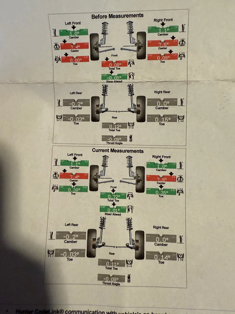

Took 25 OR in for alignment after installing ADO springs front and rear. Technician says caster cannot be adjusted due to 1.5" lift. Not thrilled with alignment shop.

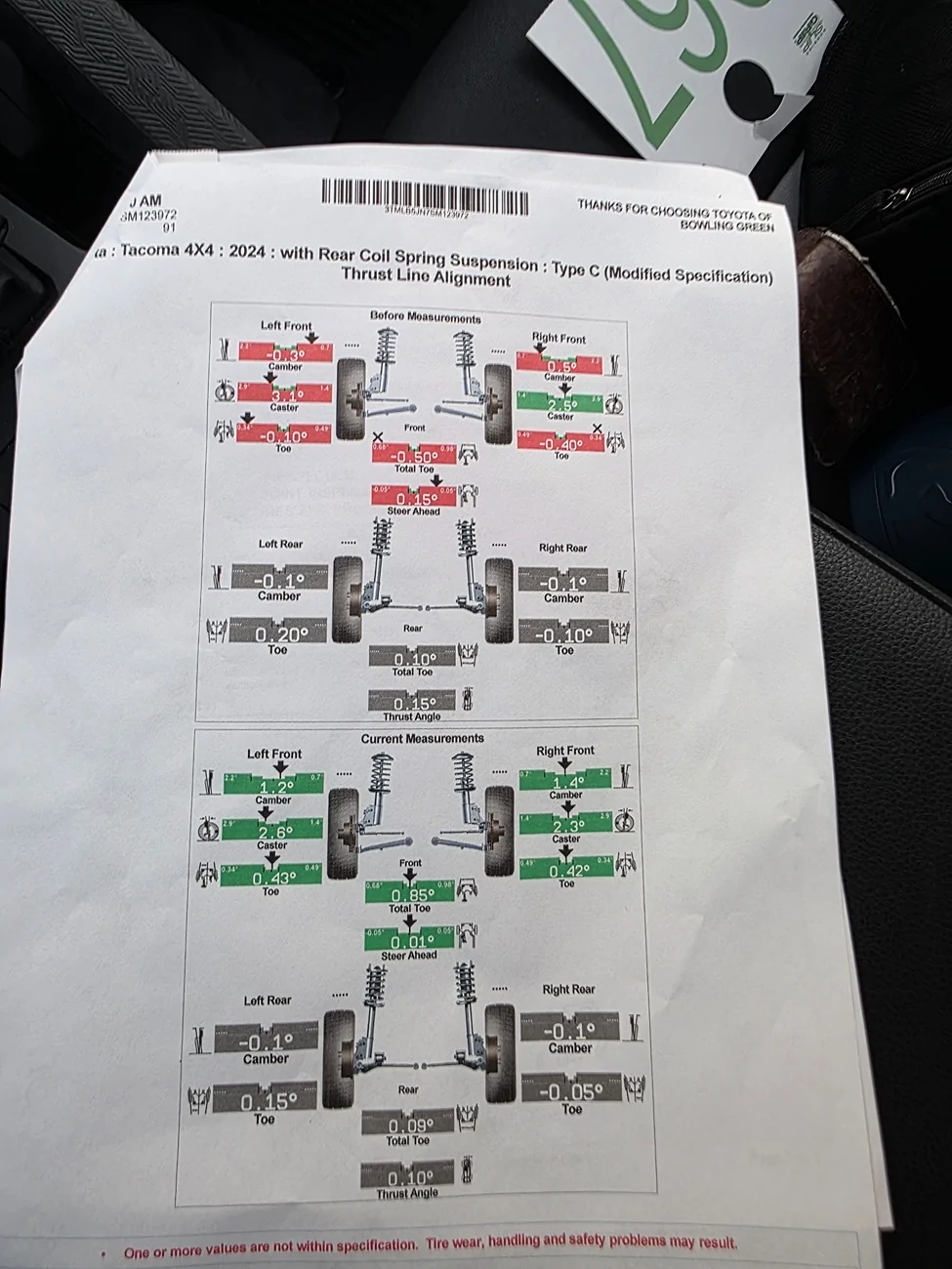

I installed a couple weeks ago just the front Alldogs on my 25 sport and went to do a alignment on the Hunter machine we have at work and the actual specs where not in it for my 25 but the 24 was. Same truck I'll just use them.... we'll there was multiple choices depending on height measurements which I really didn't understand. So I manually adjusted close to what I thought and figured I would take it to a Toyota dealership and let them do it , seeing that they are more familiar with vehicle. I did tell them I replaced front springs and needed a alignment.
Picked up the truck and it was perfect. You will notice on my paperwork they chose option C for the alignment which I think is a lifted truck because on our machine it did ask whether option A B or C .
