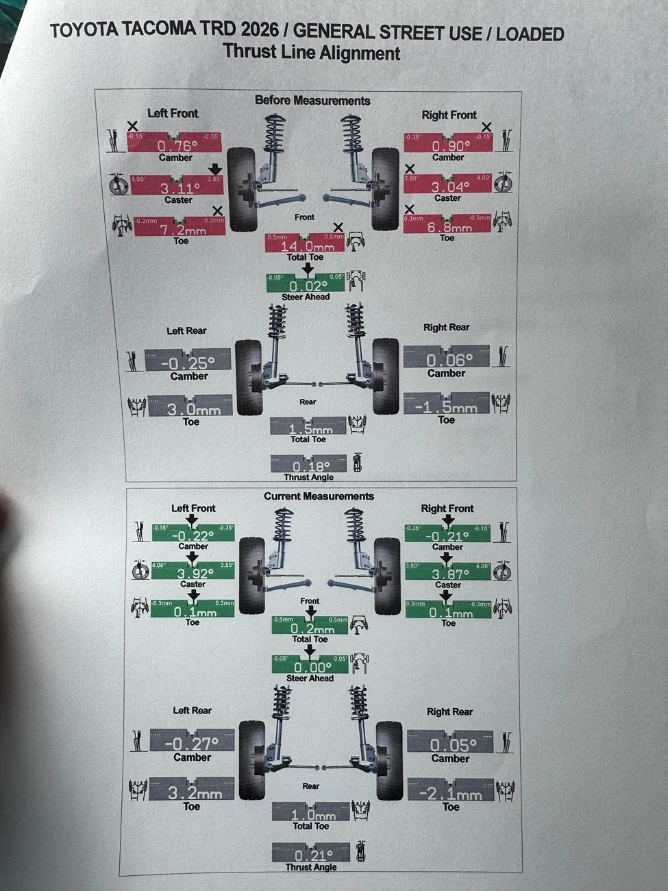

I installed bilstein 5100s this weekend at the 1” (lowest) setting with a total lift of 1.25”. Just got back from the alignment shop and had to argue about the cam bolt torque specs. The tech said “I tighten by feel”. Then I started down the rabbit hole on alignment specs. Seems to drive fine but wondering if they just followed industry standards and not specific Tacoma specs.
2024 Tacoma Alignment Specs after 5100 leveling IMG_4569

The after specs look great especially camber. Zero to -1 will serve the outside of the tires well. I have the full TRD Pro suspension and the +1 camber killed the outside of my new tires. It drove great though.

Alignment tech is an idiot. 4th gen cam bolts are 206 ft/lb. My alignment guy torqued them to the 3rd gen spec - 106. The shit creaked like a 100 year old floorboard. Shocker: that all went away when I torqued them to 206.
Yeh I went home and checked again. They lost a customer.

To me they feel like a significant improvement.
