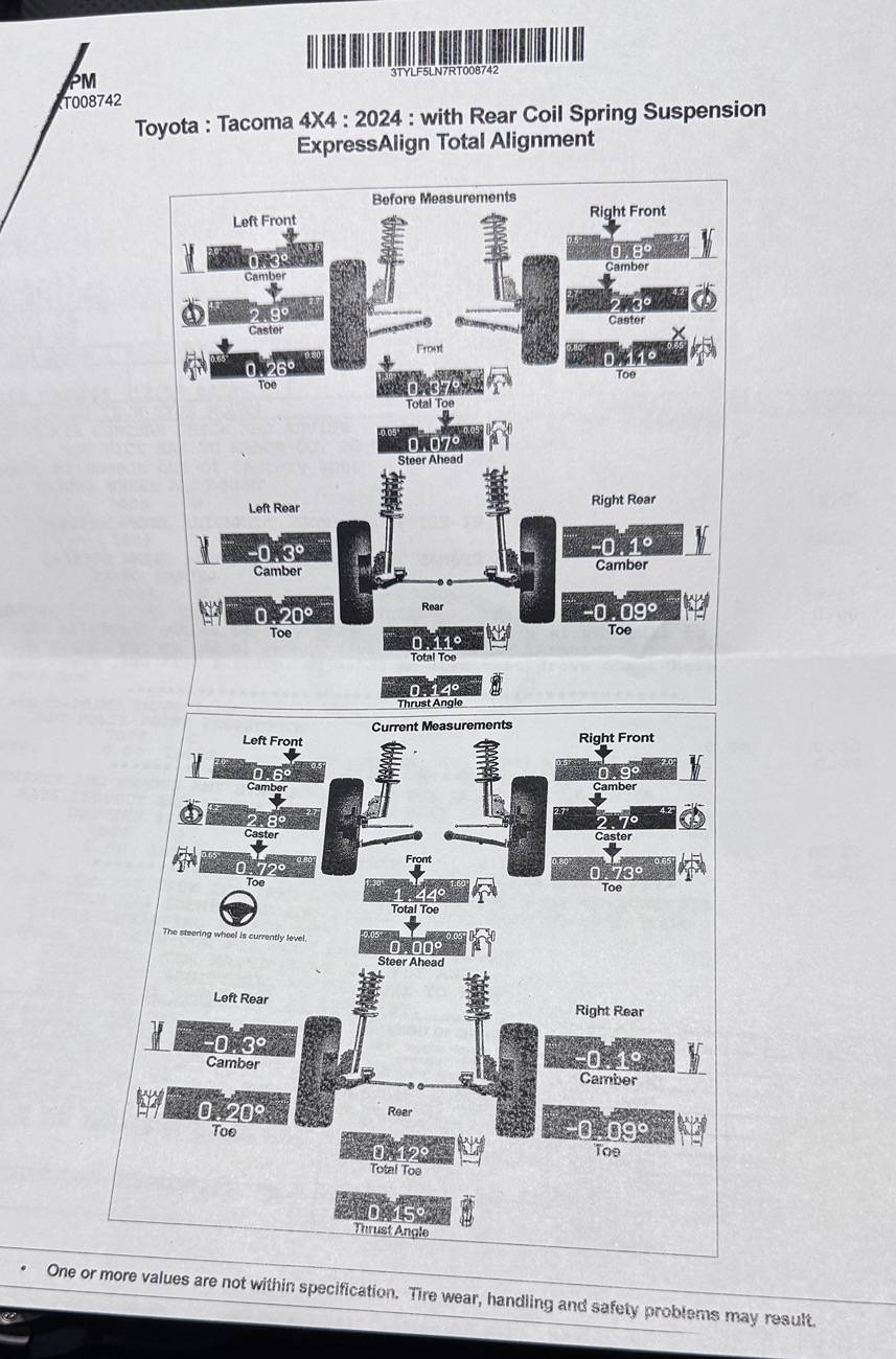

Service dept showed me this and said alignment doesn’t need any adjustment because the “steering wheel may have been turned” - could be the most dumb fuck thing I’ve ever heard - I don’t know how to read this - caster being positive is fine because that gives tire clearance - but the left camber spec is bugging me - any thoughts ?
2024 Tacoma Alignment spec bad?? IMG_6880
Edit - caster is not postitive enough! What idiots !

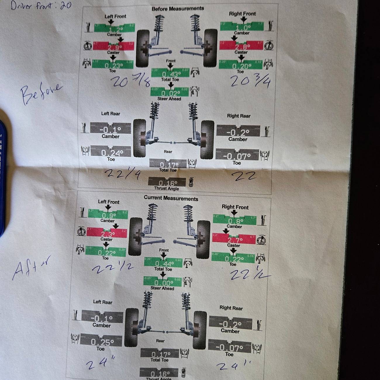

here is mine for example. Top is stock Off Roaad suspension and bottom is after swapping springs
I hope that helps

Because of camber or thrust? From what I understand you can’t change thrust.
Camber, will pull to the side with the most positive. Also camber is a tire wearing angle as is toe. Caster on the other hand is not a tire wearing angle but it will keep your vehicle going straight.
