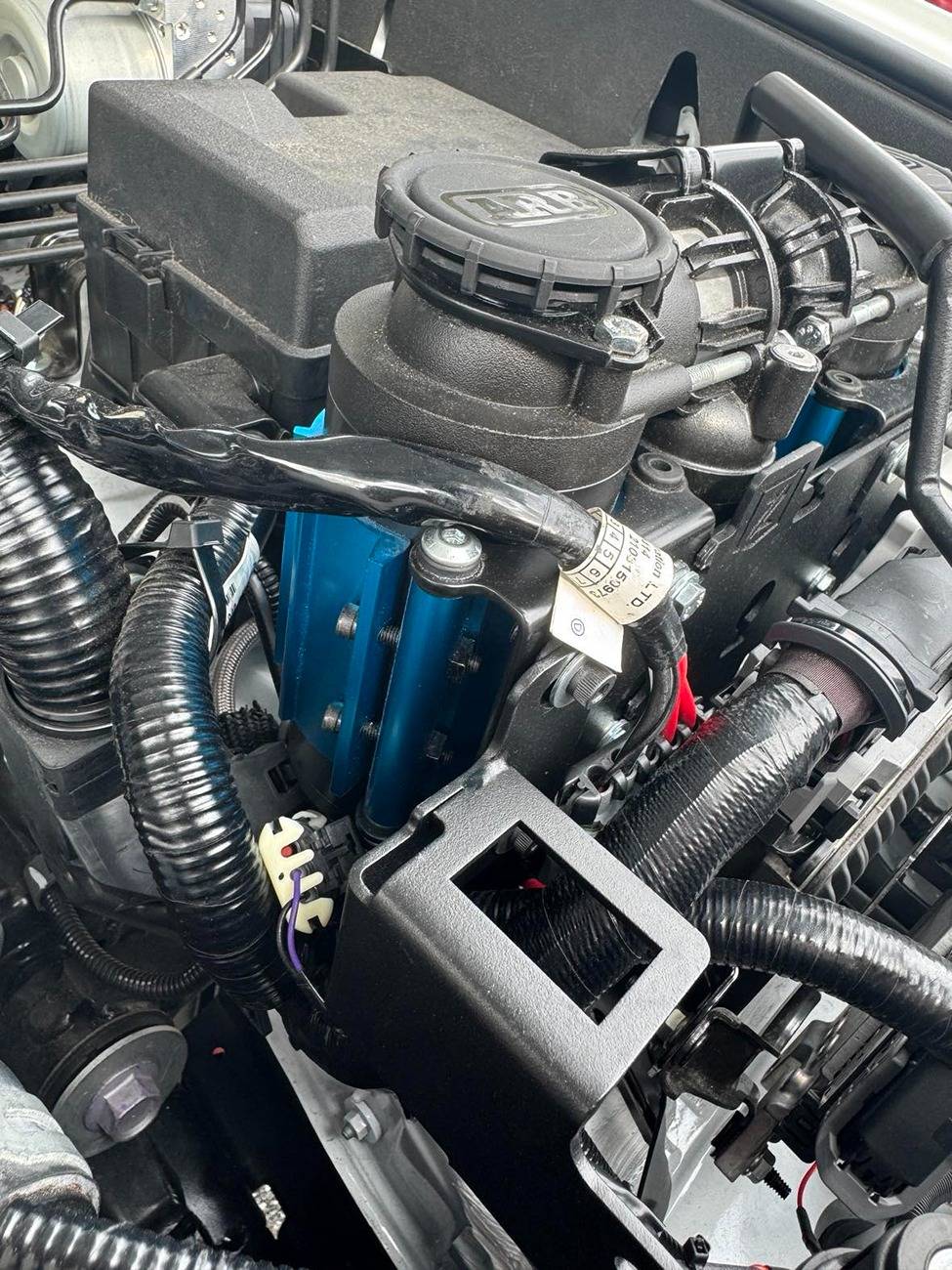

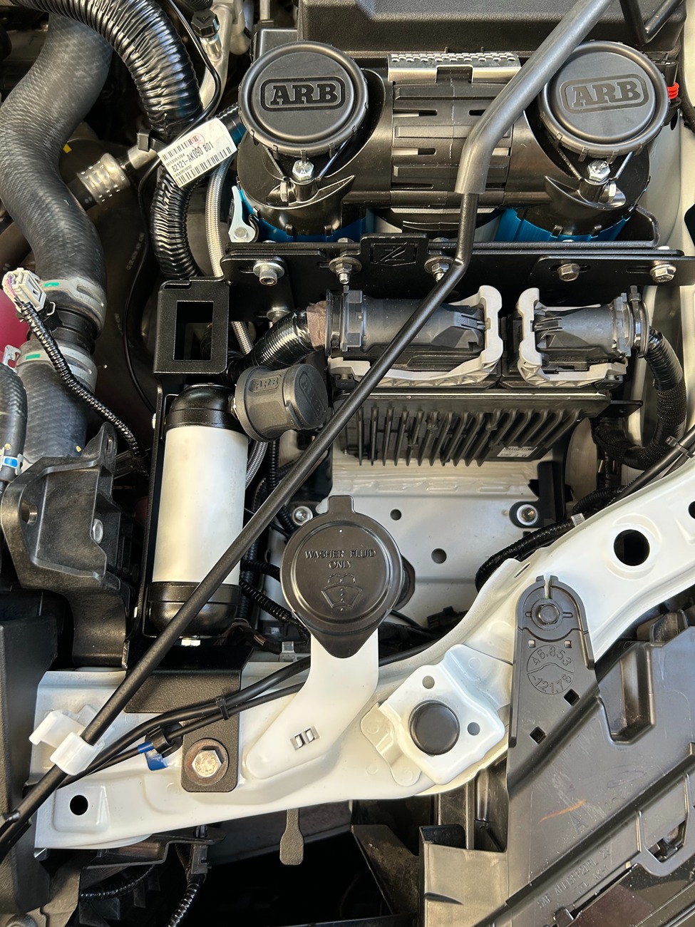

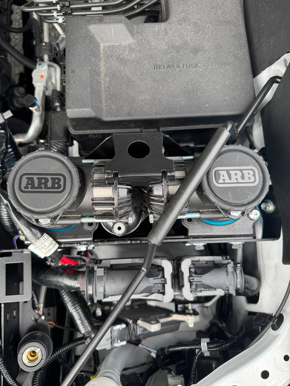

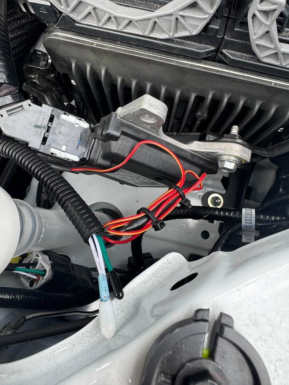

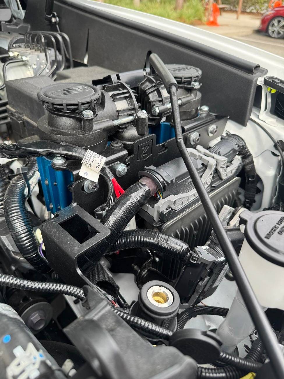

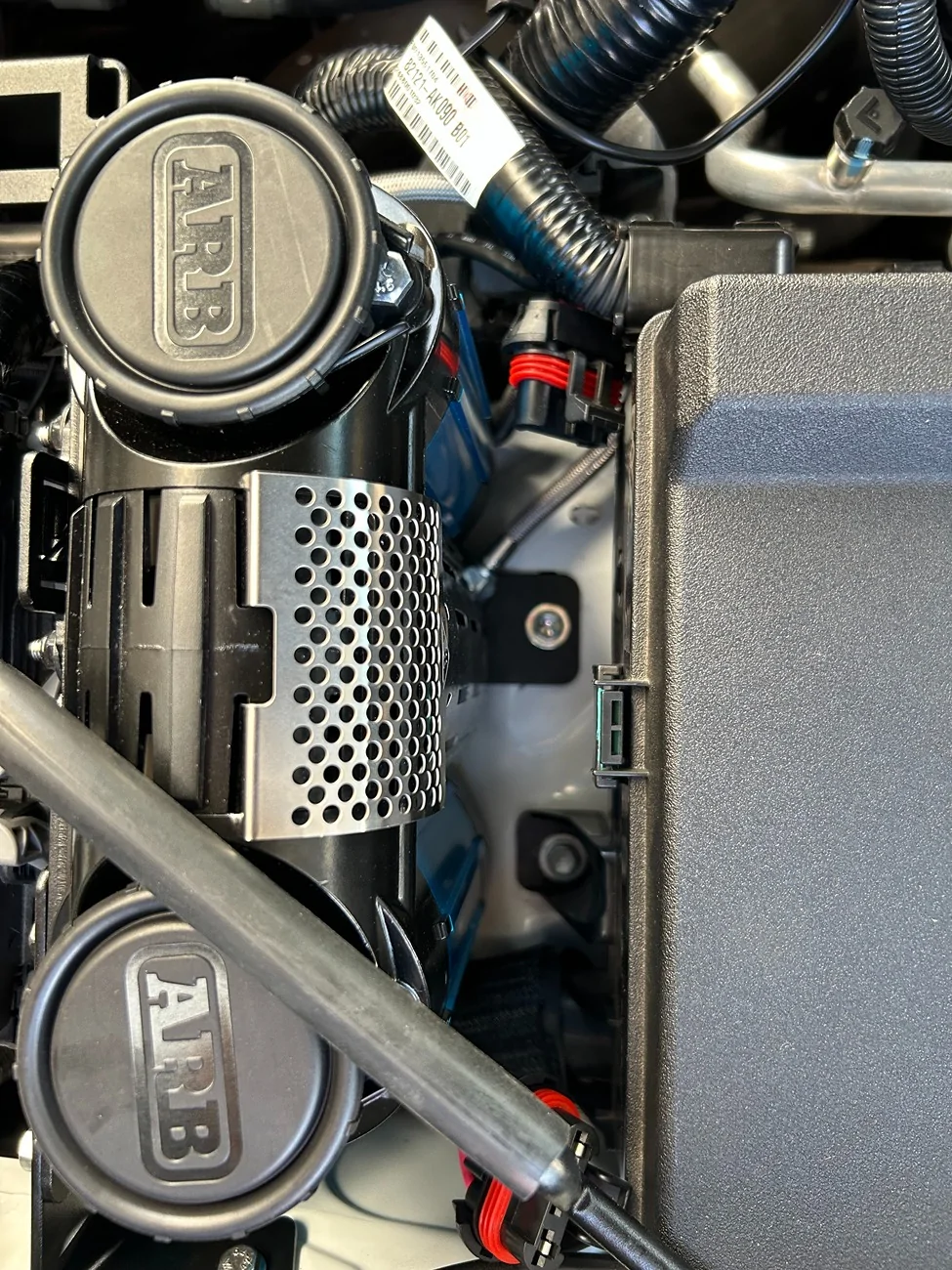

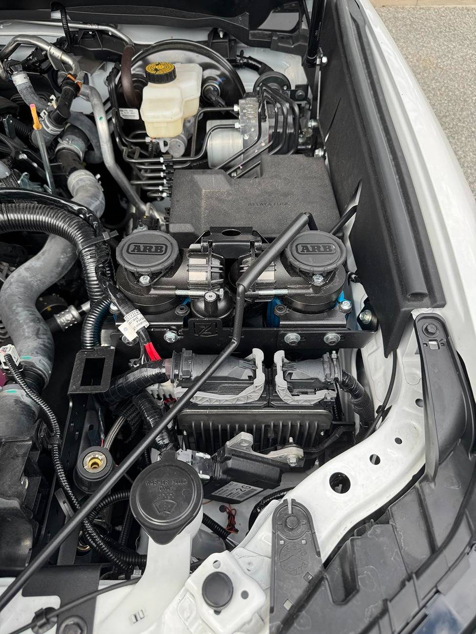

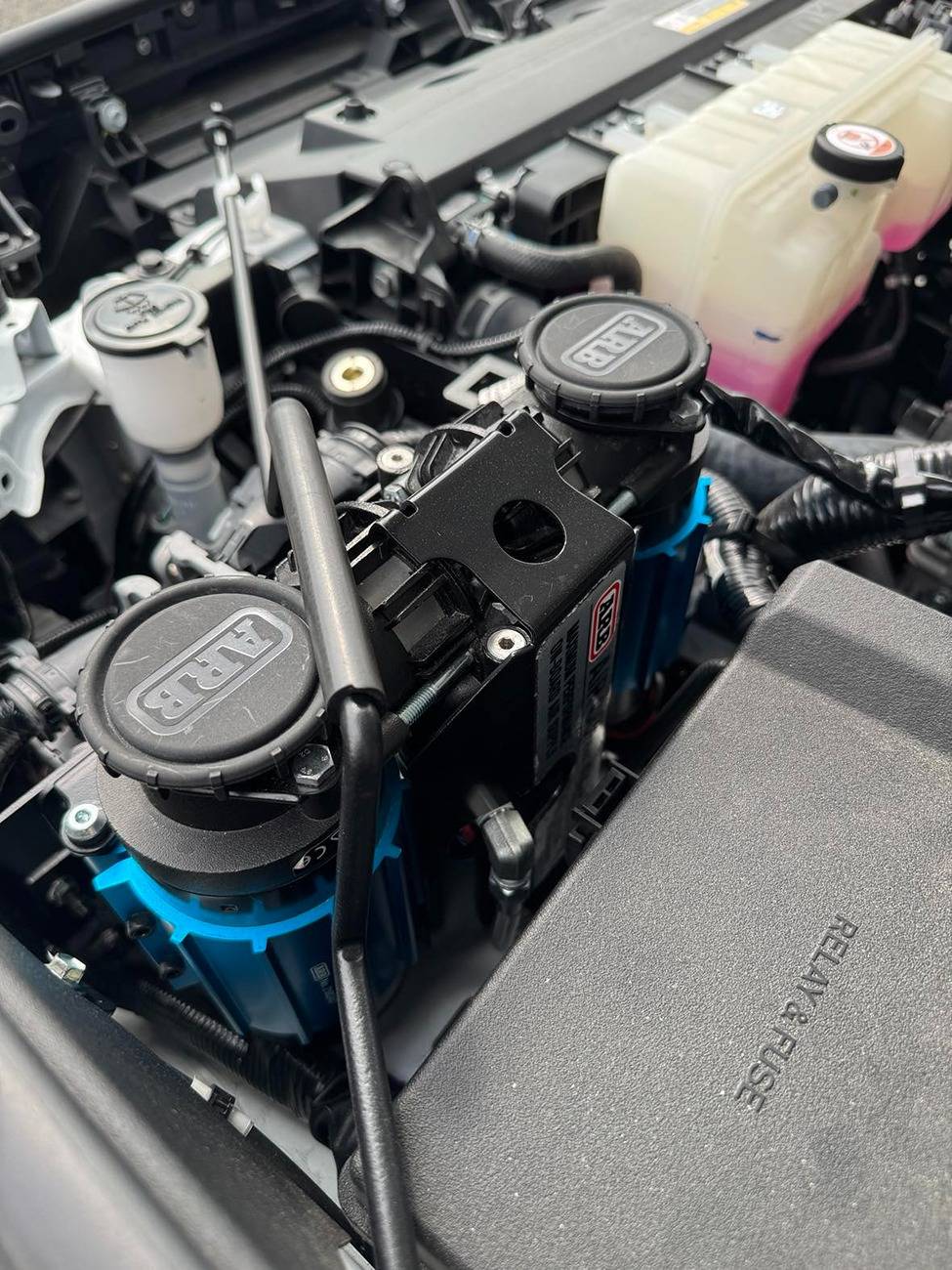

I linked the guides I used to help with wiring. I ended up scrapping the majority of the ARB harness except for the main power and switch wire because I do not plan to run air lockers. Wife & I 4WD has a simple wiring video where you can use part of the switch wiring (with diode from harness) for simple on/off function. I wired it to AUX 1 on my factory AUX switch.
ZRoadz Compressor Bracket:
2024-2025 Tacoma ARB Compressor Bracket
Videos I used for wiring install:
ARB Compressor Simple Wiring
4th Gen Tacoma Factory Aux Switch Wiring
Finished Product:
2024 Tacoma ARB Air Compressor Bracket Installed 475183864_1145916990404446_591467866832891574_n
2024 Tacoma ARB Air Compressor Bracket Installed 475268682_642443195112182_101781807293966567_n
2024 Tacoma ARB Air Compressor Bracket Installed 475654349_927618312913628_5580481640786788528_n
