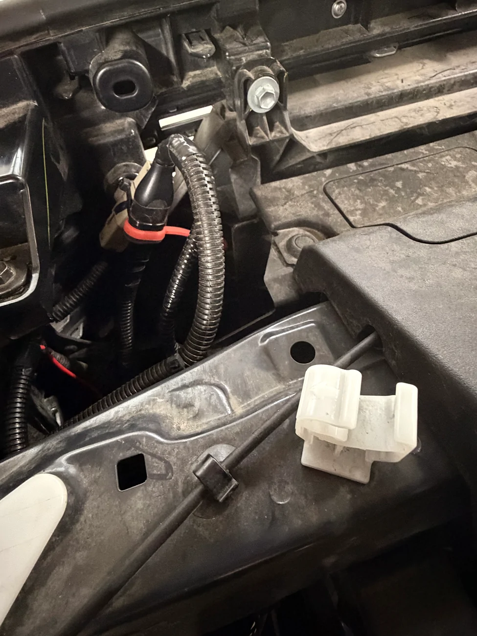

I don't understand why the auxiliary wiring would be different hybrid vs non-hybrid. Here is a pic on my auxiliary plug next to the washer bottle. Note that I'm plugged in.
