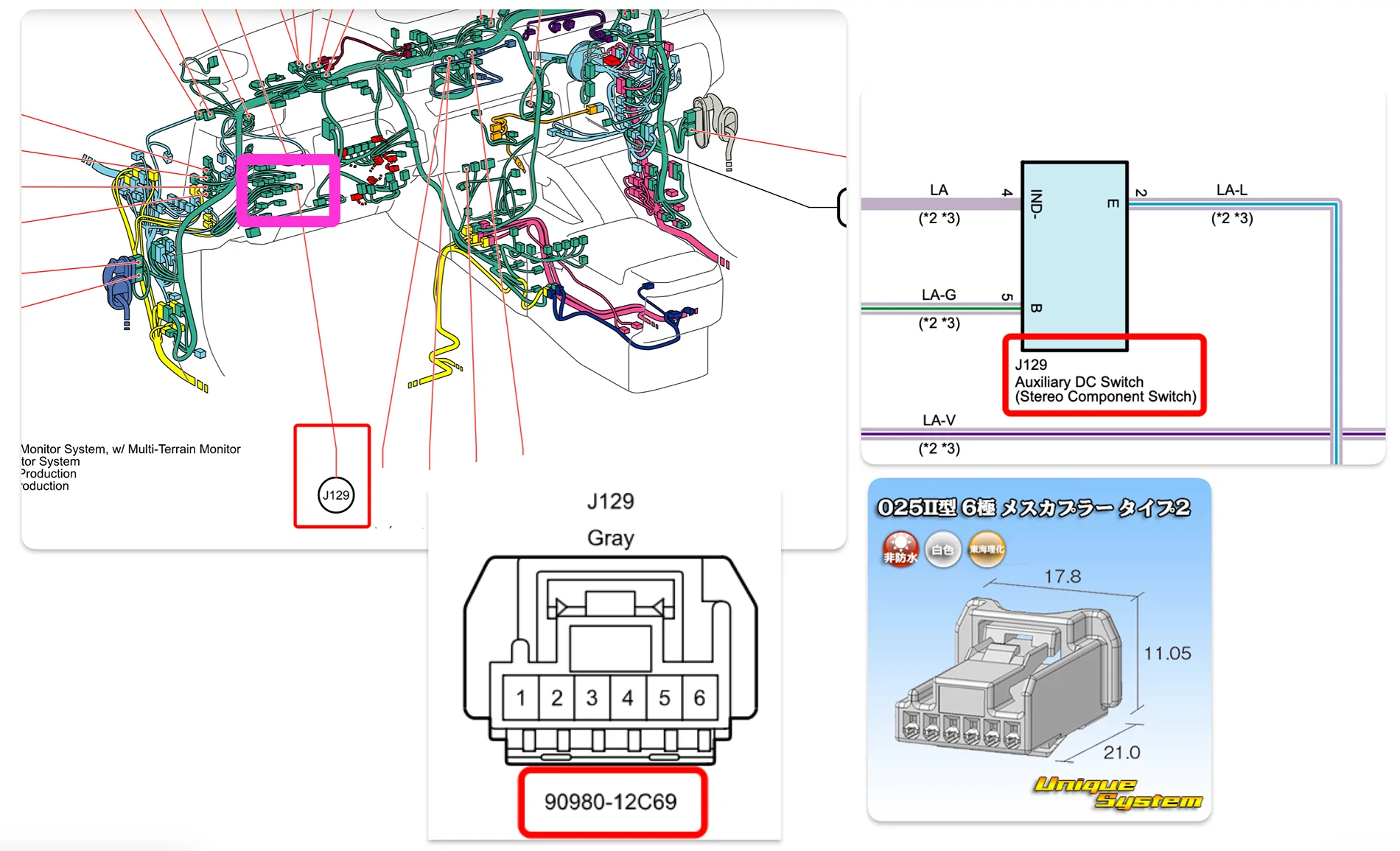

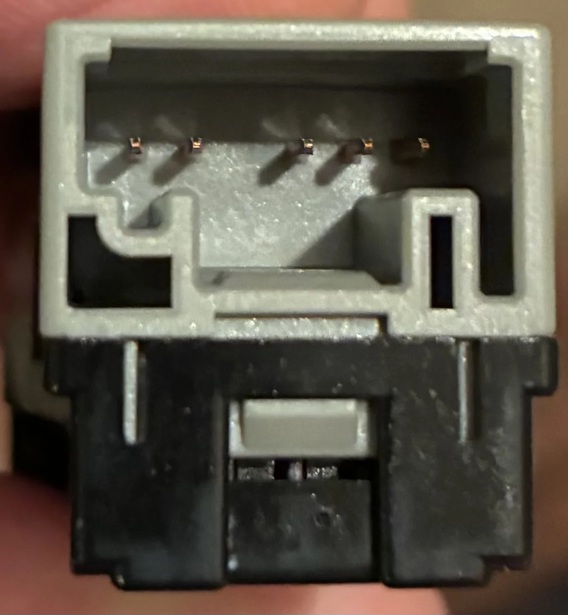

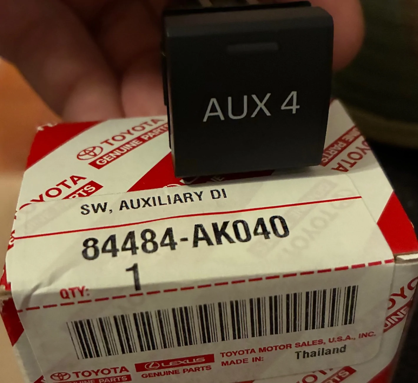

Hey dudes, trying to add another Aux circuit to my 2024 and thought it would be cool to get an OEM switch.. so now I need the oem wiring plug that inserts into the back of it. And seeing how the part I desire is part of the Tacoma’s wiring harness, this may deem it pretty difficult to find. So I’m reaching out to you yahoos for some help. So if y’all know a part number for this plug, let me know. Thx and Merry Christmas you filthy animals.

So what you’re saying is order the harness above and the switch at the top and the 4th auxiliary switch is plug and play??

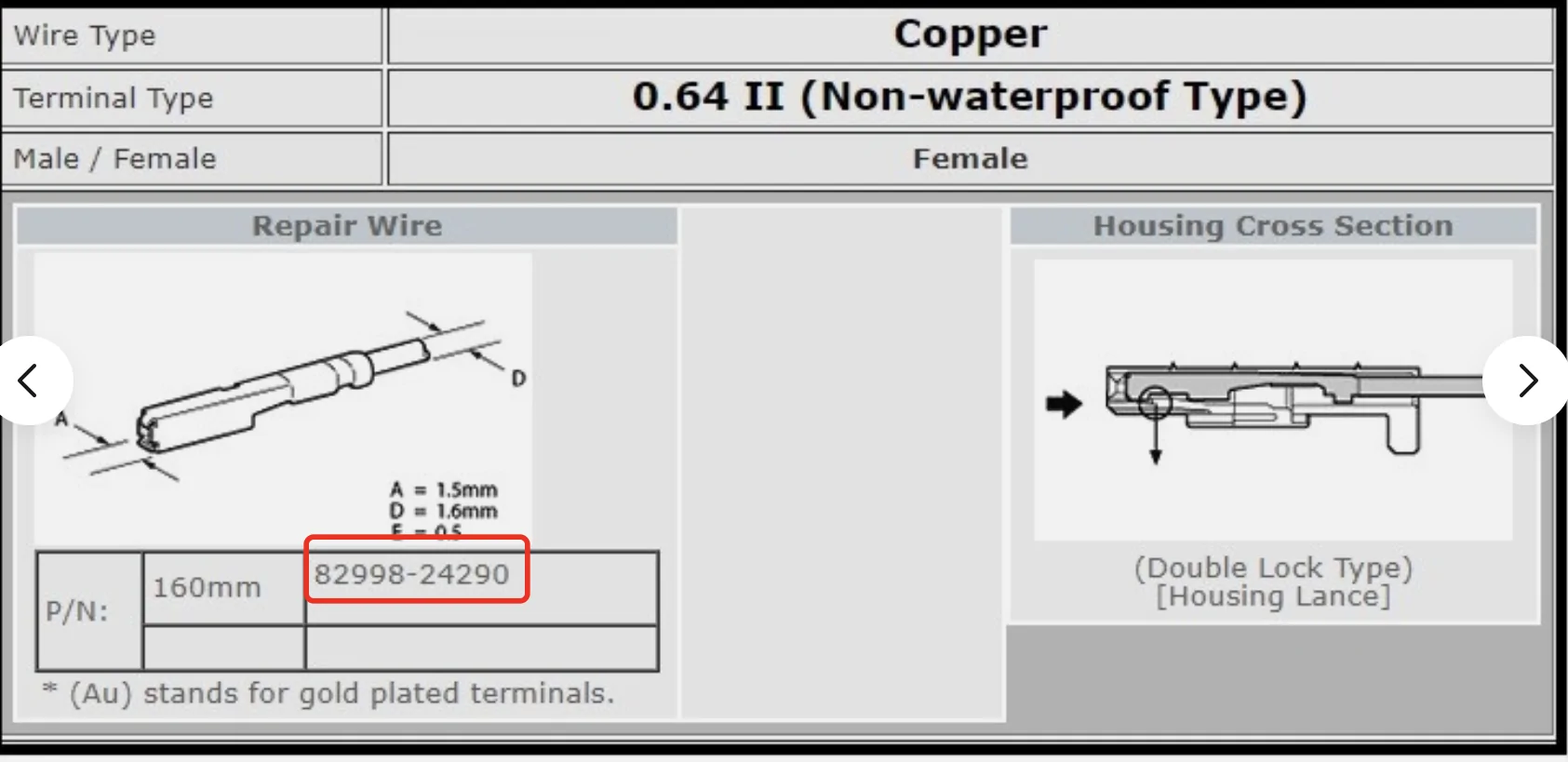

Didn’t realize it was the bare connector until I searched the part number. Wish I knew what standard the pins are. Wouldn’t mind just wiring it as a separate circuit.
Here you go:
2024 Tacoma AUX4 Dash Switch-Wiring Harness terminal
(And no problem OP, happy to help.)
