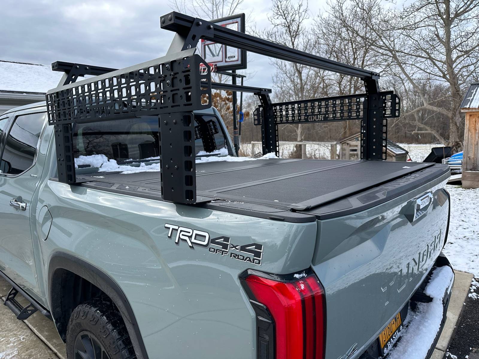

We have had a couple customers get creative to fit our bed rack with the OEM cover. And our bed rack actually allows tri-fold covers to open unlike most others. These pictures are of a Tundra but its pretty much the same cover just larger, as well as the same utility rail system.
We also think there is another way to accomplish it using Elevate T-Slot rails sandwiched between the bed cover rails and the bed side. It would require the removal of the weatherstipping on both rails, but some silicon between all the joining surfaces should suffice, or work even better.
Our rack would then mount to those T-Slot rails.

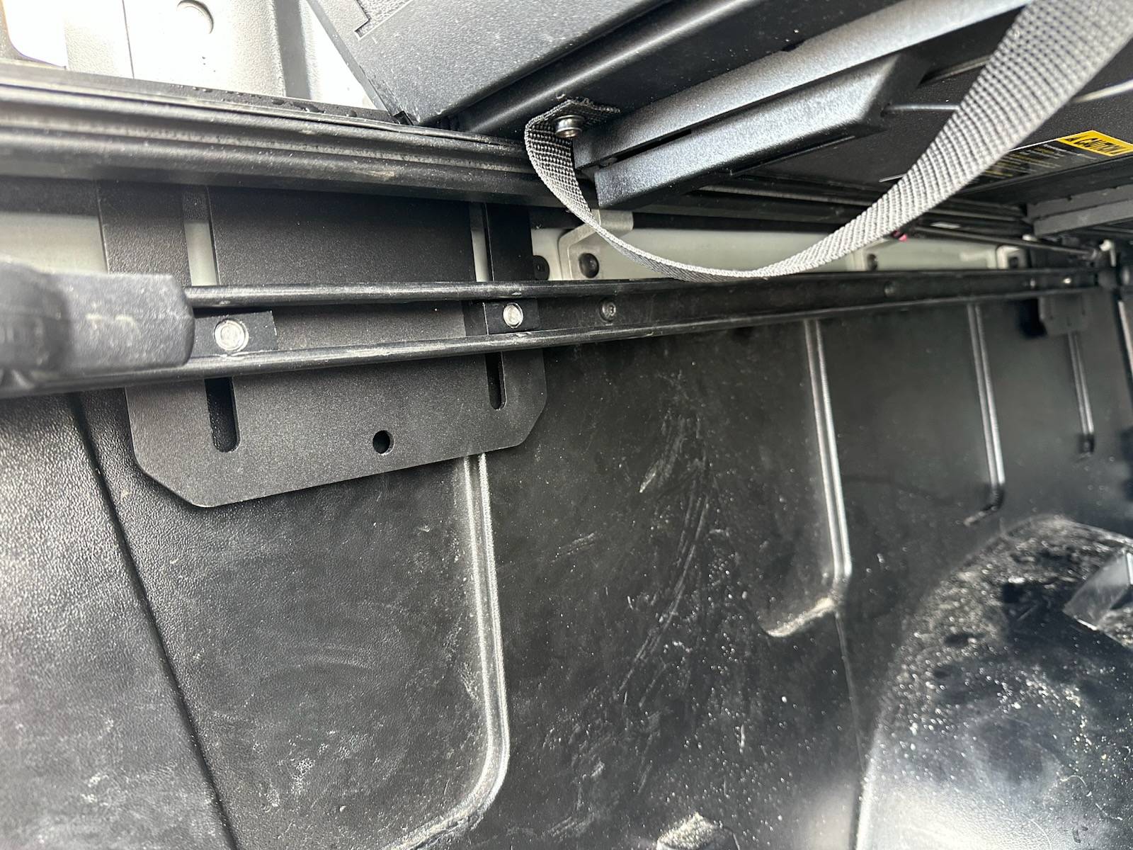

I was going to try using the Elevate T-slot rail system and making some mounting brackets to work with my factory tri-fold. I chickened out and decided to go with a Retrax with the rails built in. The T-slots are nice so you can easily remove the rack if you do not need it.
One thing to note is that the factory tri-fold move the mounting rails in the bed out and down, so the bracket mounting position for any add-ons is moved and may not work.

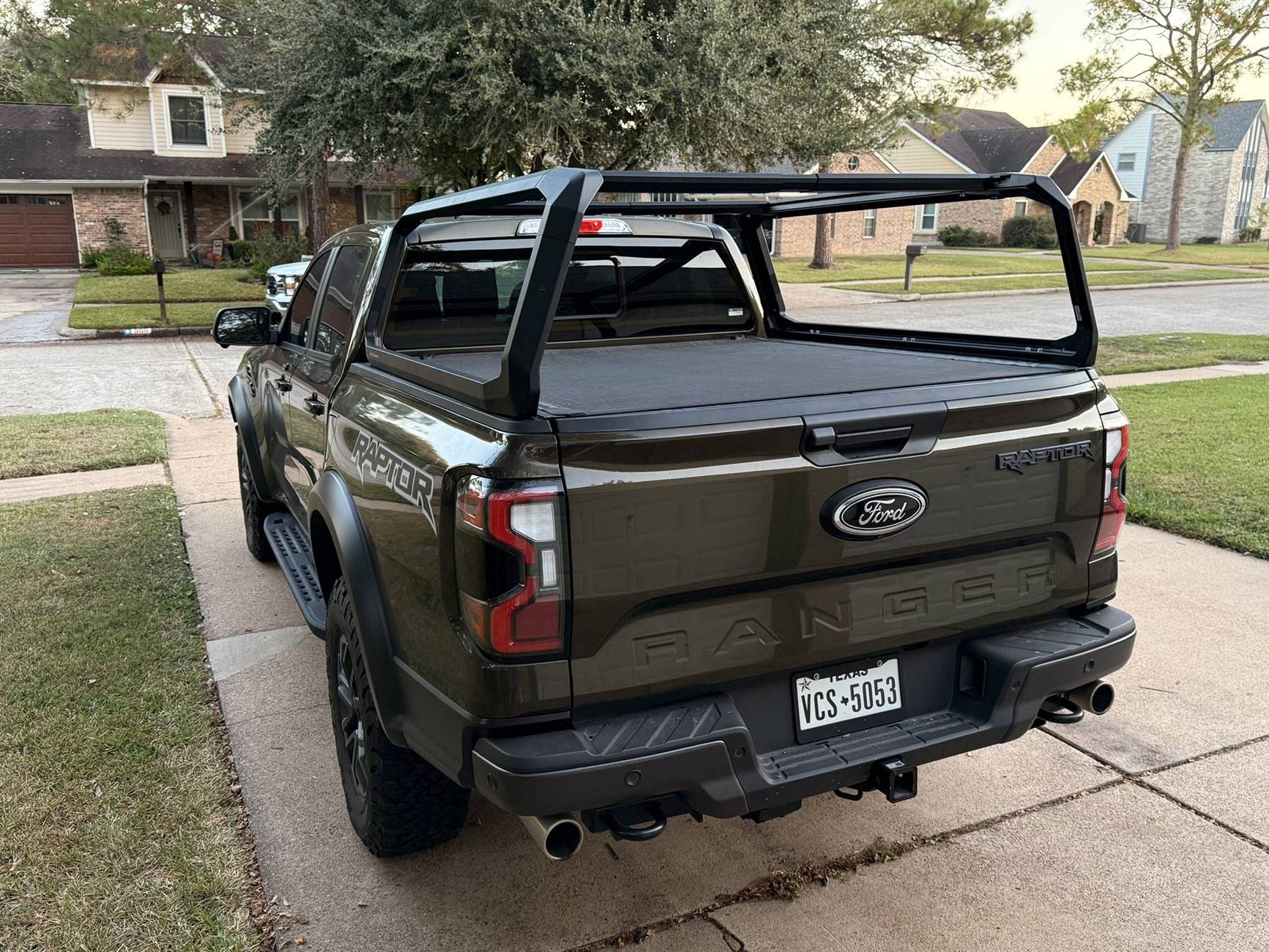

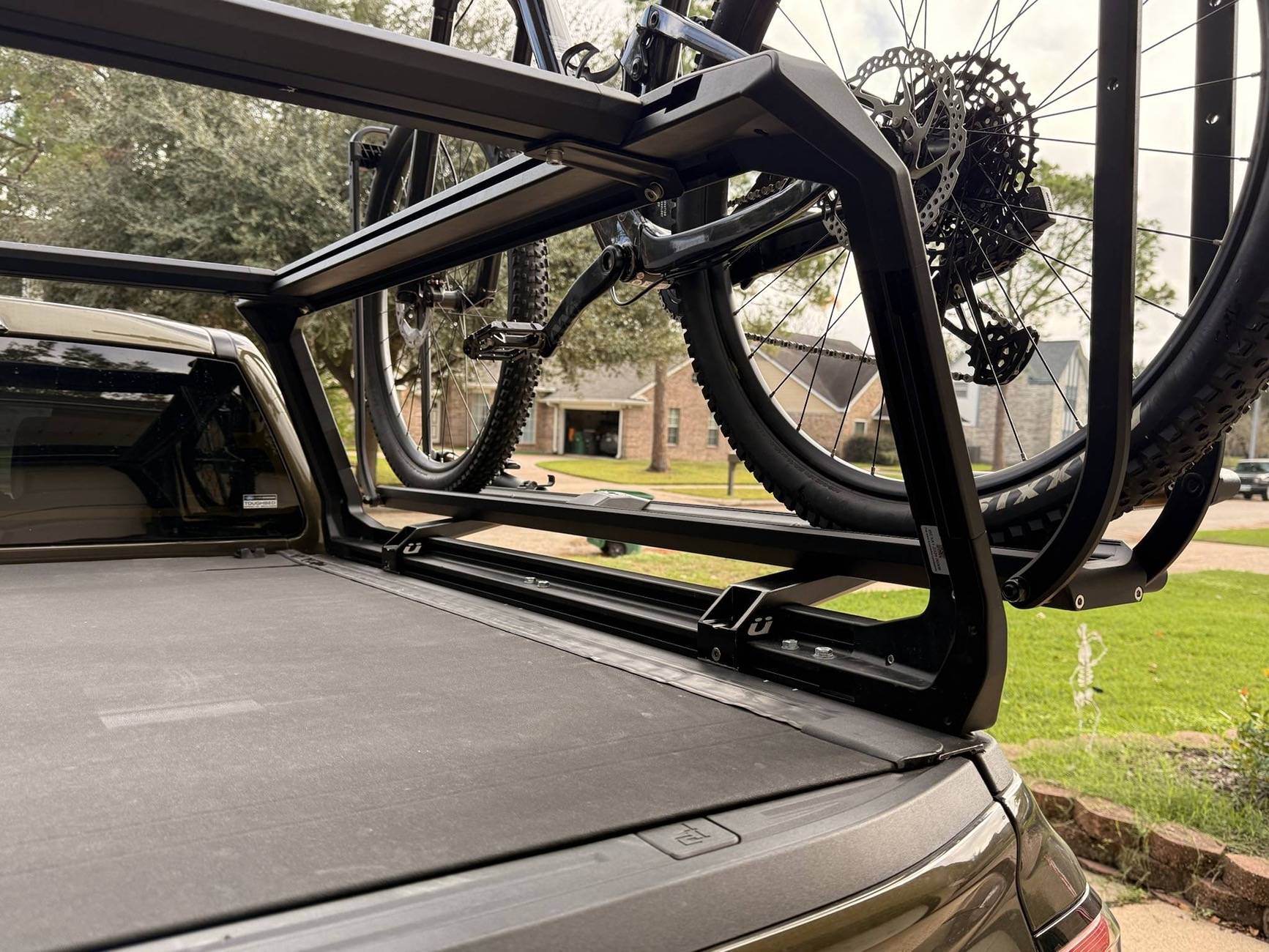

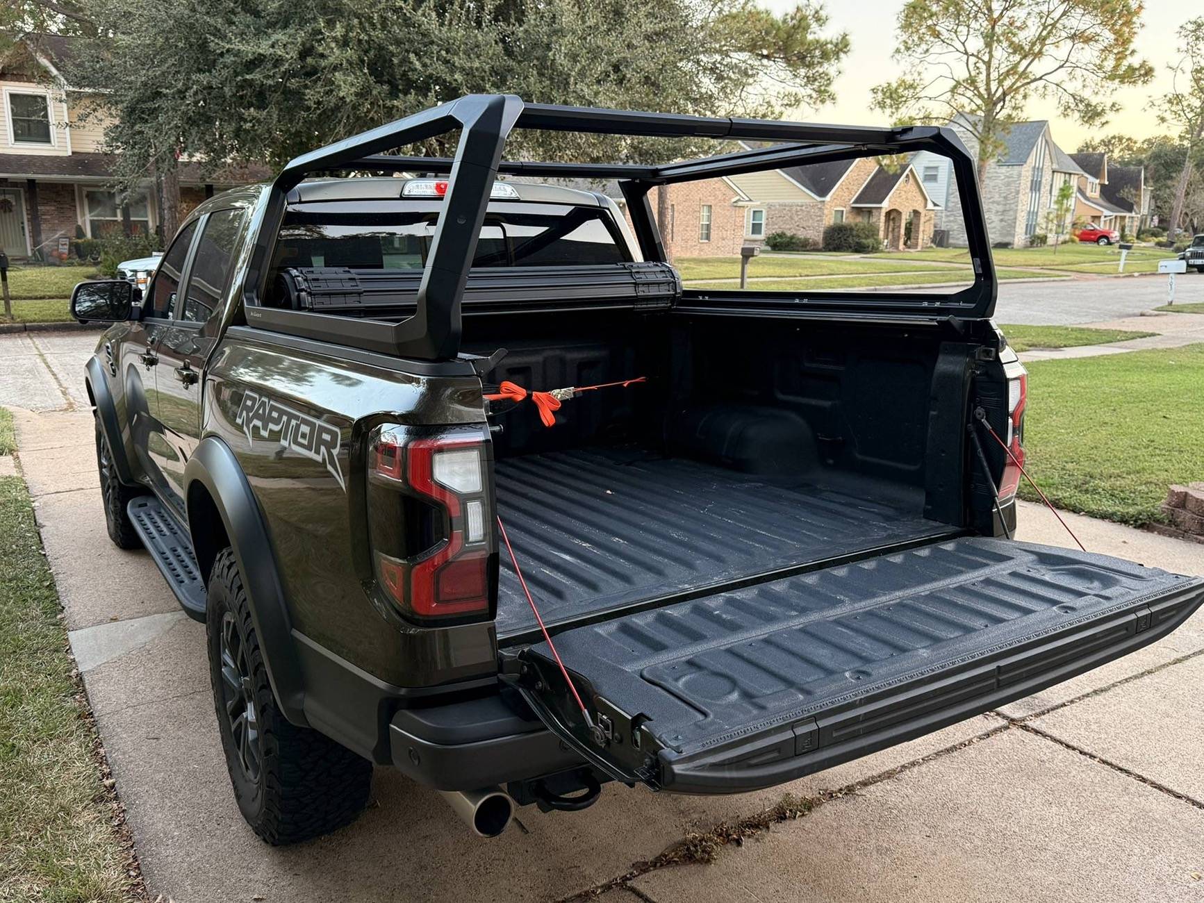

I went with the BAK Revolver X4TS with a T-Slot system…. A Ranger Raptor owner got creative and was able to adapt the Küat IBEX bed rack to the roll up tonneau! I’m hoping I can do something similar with my roll-up tonneau…
This looks great. Can the trifold open completely? Or just the first section?
