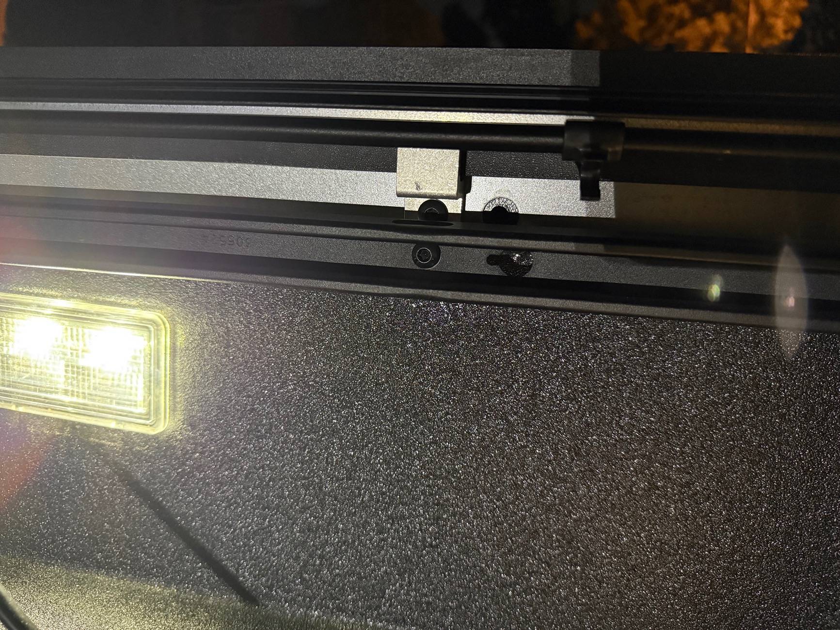

My rails and cover were installed by Toyota, so I don't believe anything is relocated with the exception of the rails being about 5/16th" away from the wall because the cover S hooks are using the same mounting bolts as the rails. All looks to me to be the same for the rails with or without the cover as the cover doesn't use the rails except for the S Hooks mounted underneath. It sits just above the rails. I also use my rails for Bed Tie Down Anchors and they don't interfere with the cover since they don't rise above the rails.
I have the OEM Toyota Tonneau cover and I installed these mollie rails with all pre-drilled holes fitting properly. You will need to drill 1 hole on each side as per their instructions towards the rear bottom on the side panels since there is nothing in the area to hold the molle panel rear bottoms. I am still fitting items on my panels, but I already have a hi-lift, recovery boards, RotopaX gas and water canisters. It is very sturdy and is heavy gauge coated steel.

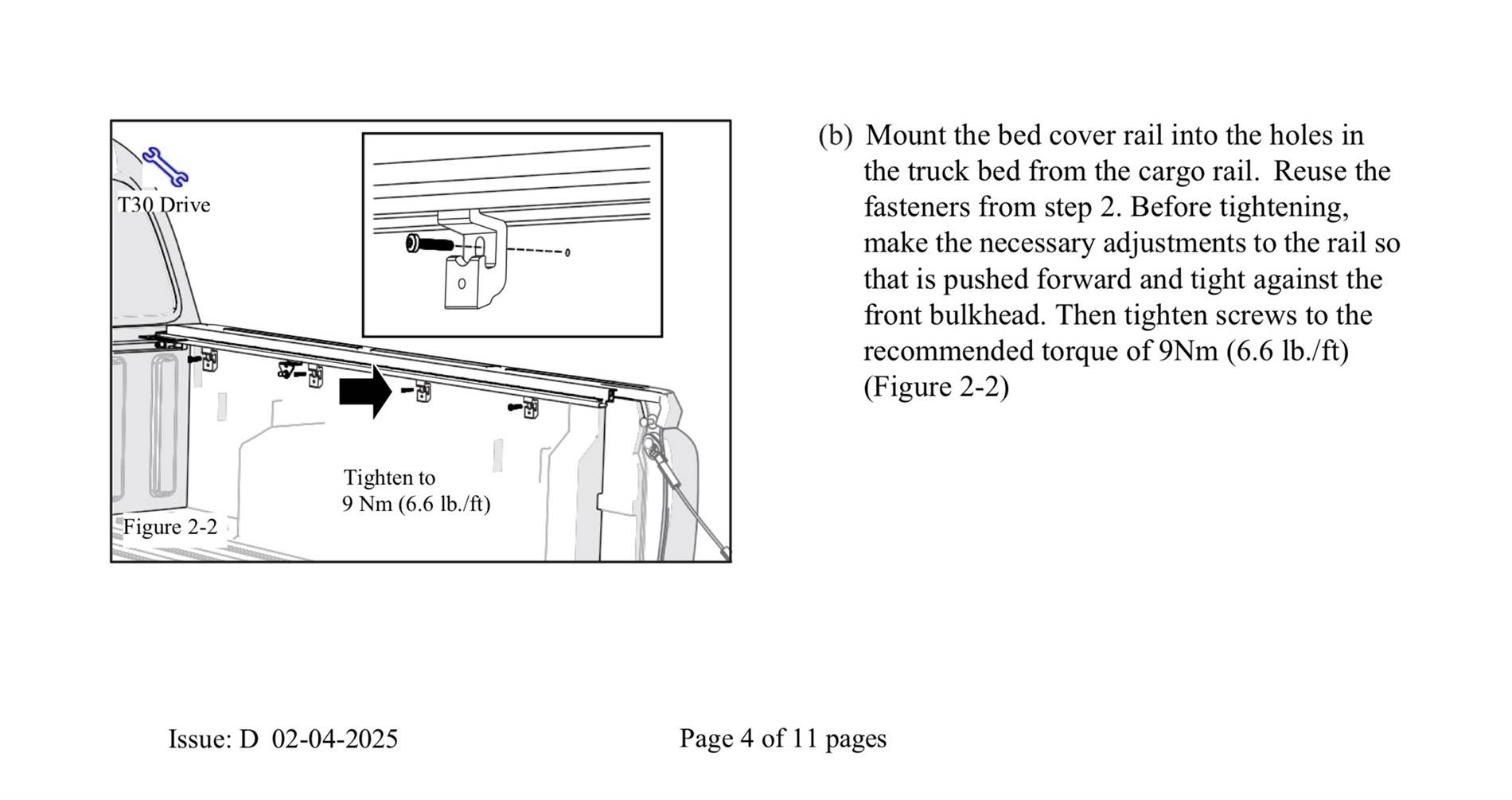

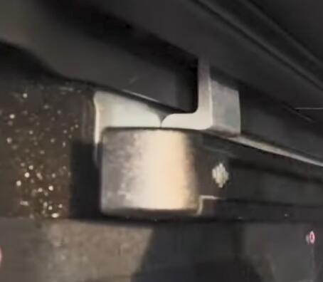

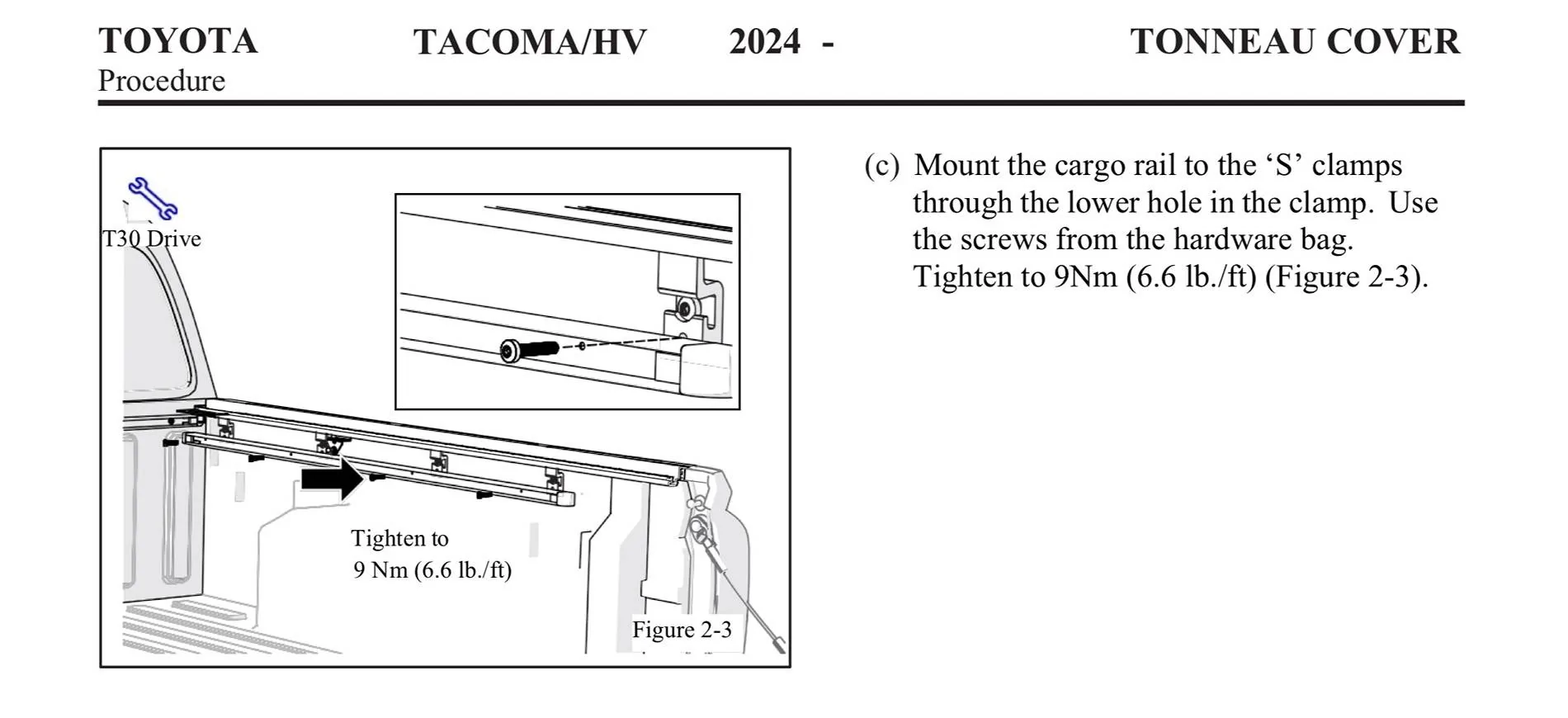

Oh wow. There might be two versions of this cover. Mine had to be relocated lower in addition to inward.
Here’s the instructions from Toyota That shows the S hook mine uses.
https://toyotaparts.sparkstoyota.com/install/PT954-35240inst.pdf
The one in the instructions is the type I have.

I will go out in the garage tomorrow and take a closer look at mine. In either case, the Rough Country Mollie panels did fit, but they do touch the bottom of the bed which is what I was expecting anyway so it didn't make me believe anything was different or wrong.

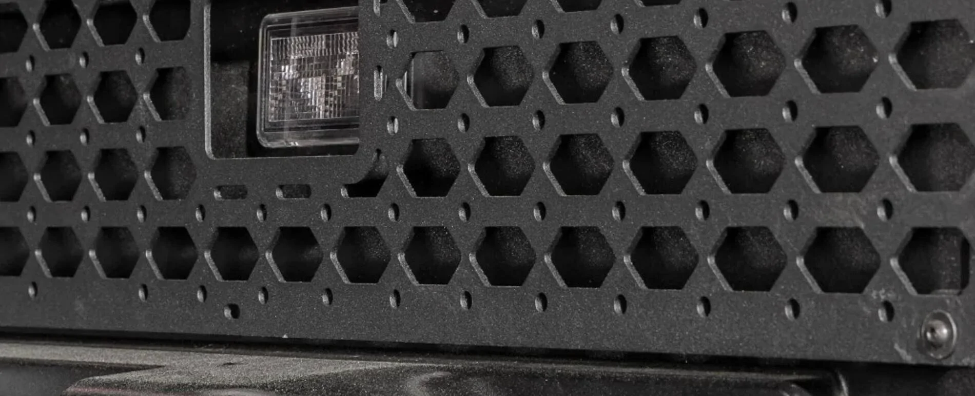

Thanks for all the inputs. I have been researching panels. It looks like the front panel is not constrained by the cover since you don't move the rail.
I really liked the Rago side panels as they go the whole side. They are expensive and they have a lot of bolt holes that have to line up so likely not to fit
Since several here had said Rough Country fit, I took a good look at their online photos. It looks like the gap at the bottom is sufficient to offset the movement of the rail.
2024 Tacoma Any Molle panels that work with the OEM Tri-fold Tonneau cover 1749936535910-7o
I liked the Toyota OEM panels. There is a gap at the bottom, but not as big as on these Rough Contries, based on the photos.
So I will order the whole set from Rough Country. I could order a different front but from what I was looking at, they all seem to have the same utility just different styles. I think its better for the styles to match.
