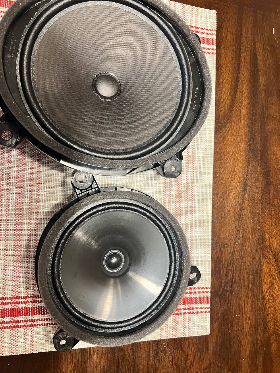

So I finally dug into the front and rear door speakers for the non-JBL system. The front looks like a very weak is a 6.5ā€and the rear is 5ā€.
According to Crutchfield
you can do a 6.75ā€ front and rear…they’ll both need adapters There’s no wiring harnesses for a plug and play at this point in the game, but you can splice it in.
