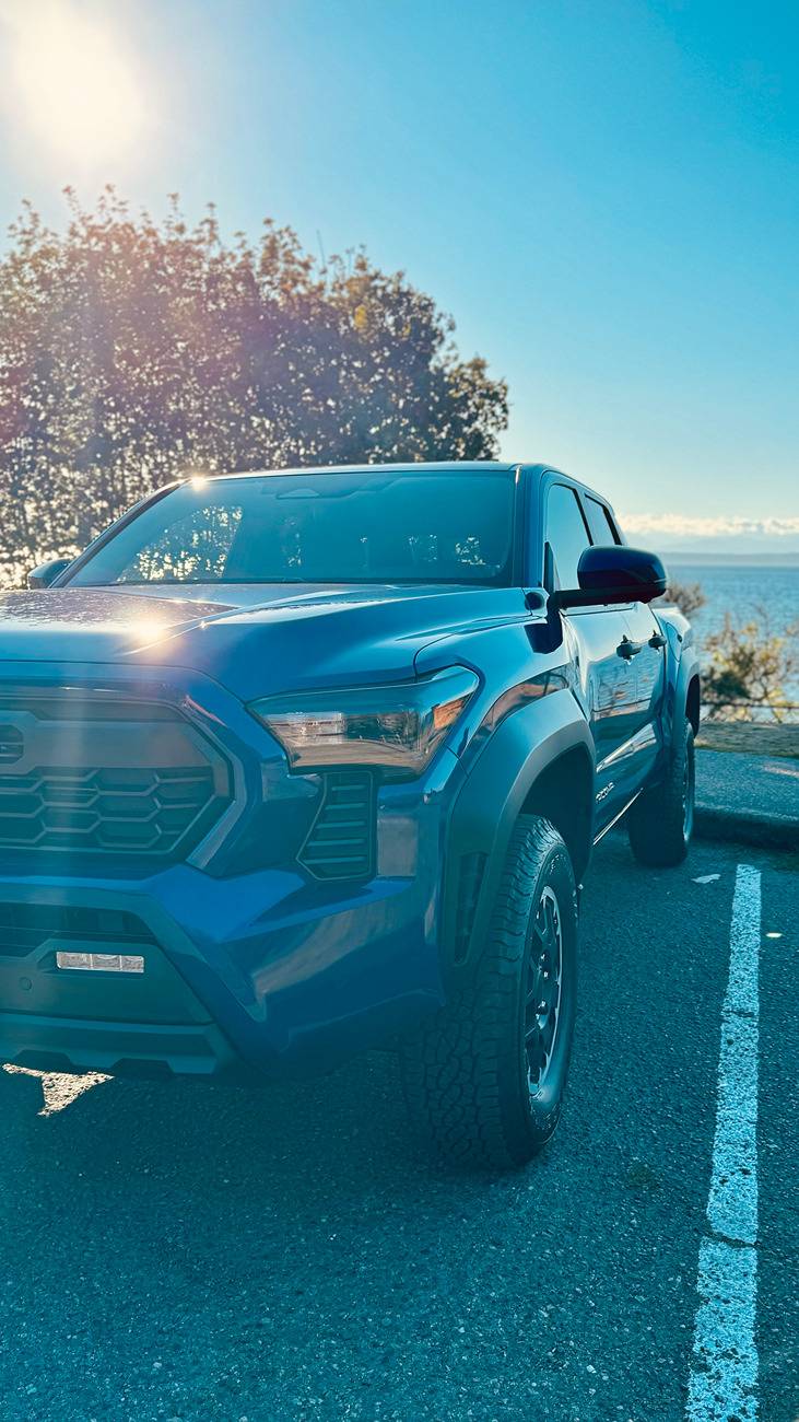

Blue Crush 2024 Tacoma w/ hood & bumper PPF, FormulaOne pinnacle ceramic tint, Air 90 front windshield tint.

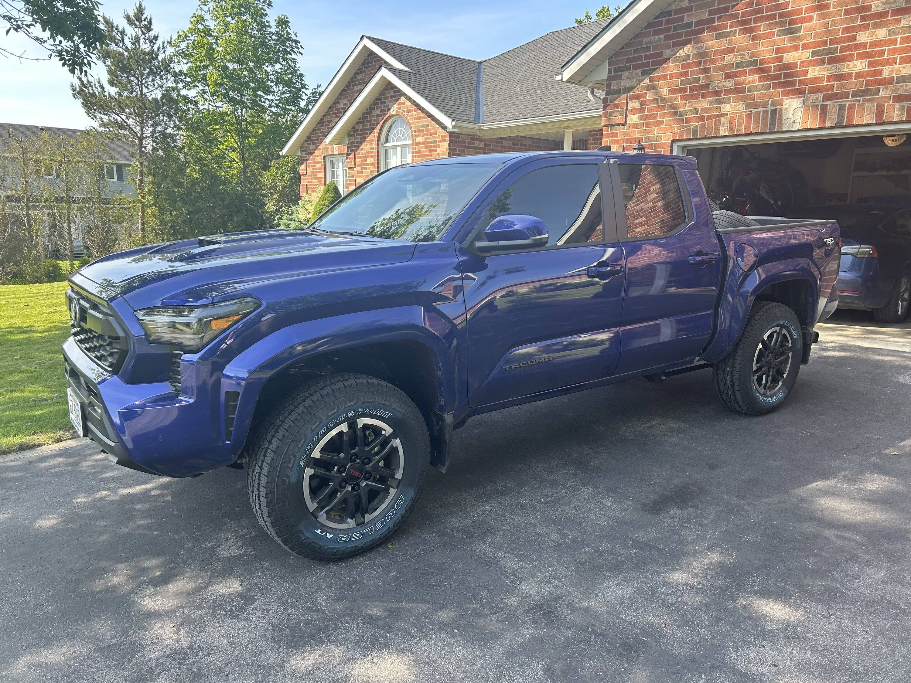

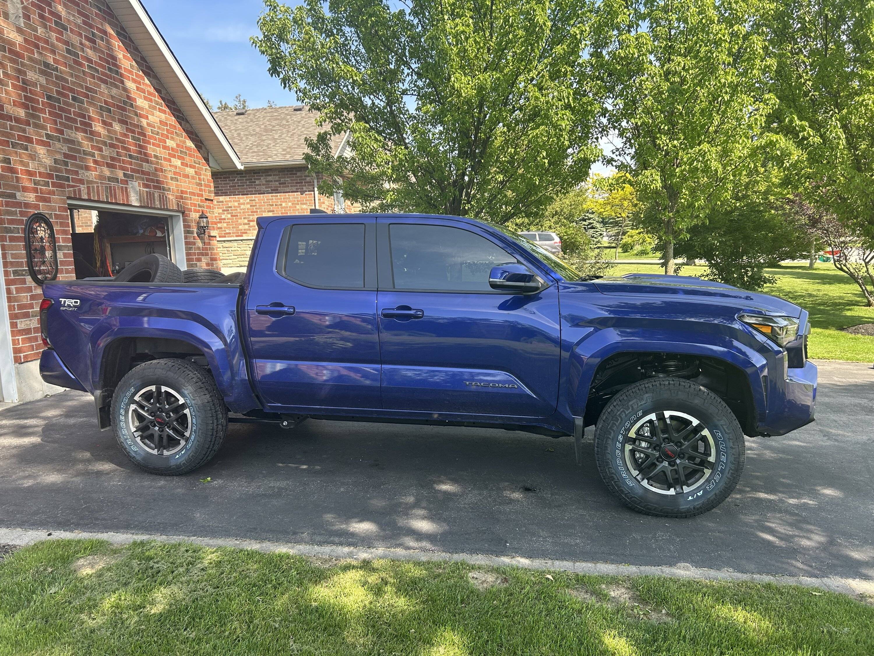

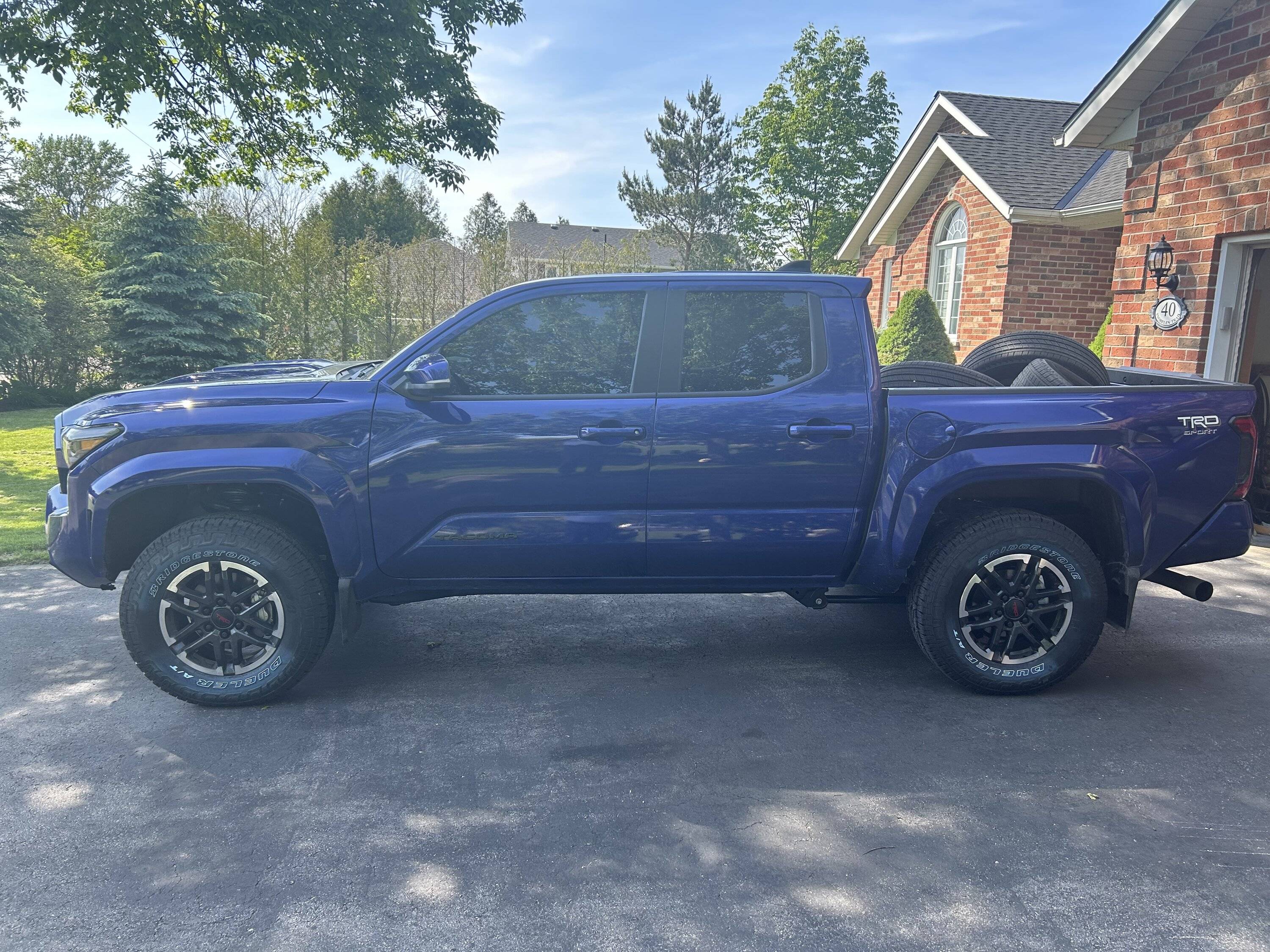

My dirty Blue Crush 6MT Sport , RC level kit and Bridgestone Revo 3 265/70R18 on stock rims (largest / lightest tire combo I could find without going too too big)

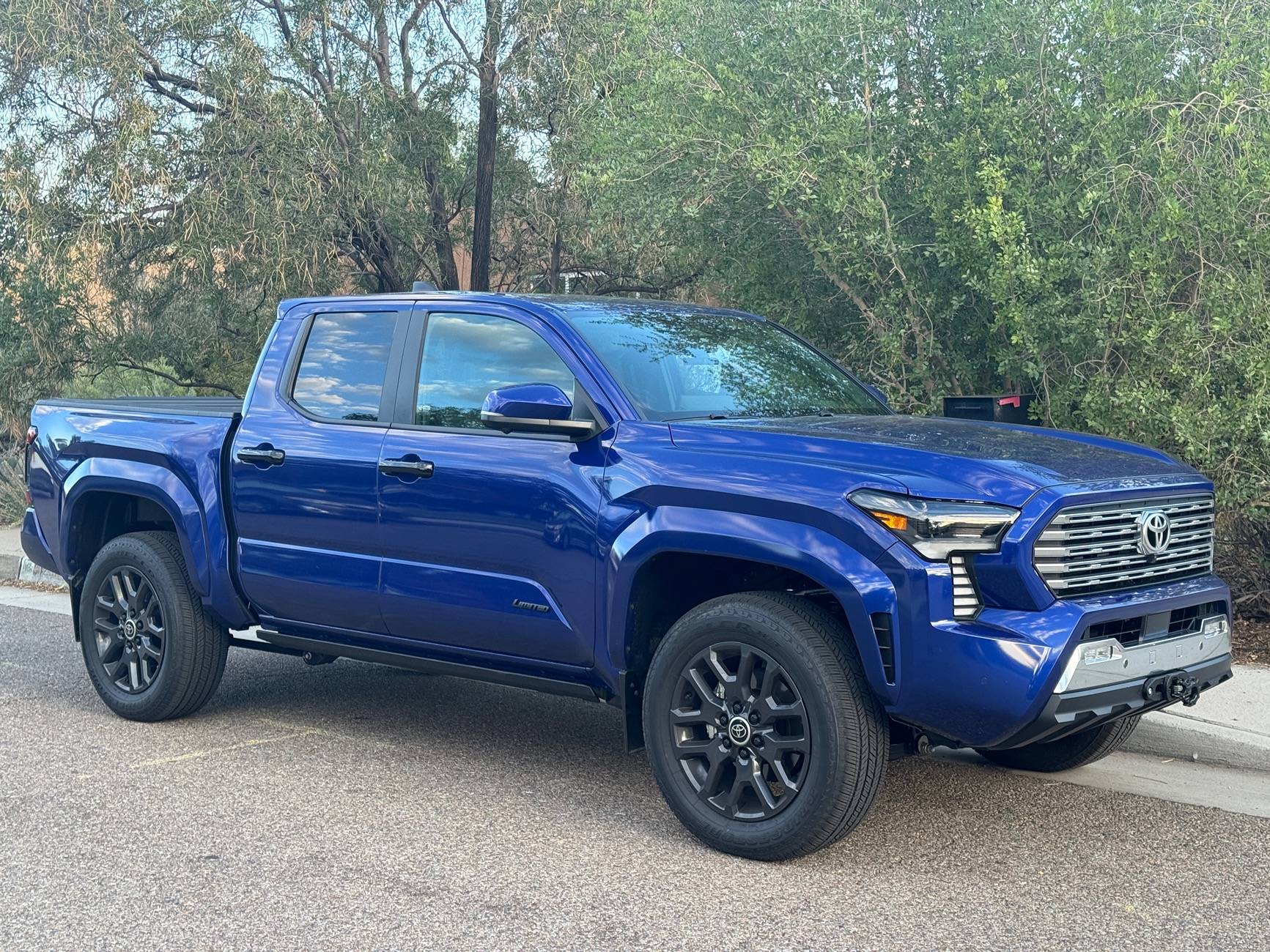

In the great dechroming of my Limited, I found a spectacular local deal on a set of 2023 Tundra takeoffs ($500 for wheels/tires; prior owner had bought these for a 3G Tacoma and found they didn't fit). The big question: do they fit our 4G? It's surprisingly hard to find definitive information on this question. After a bit of research, it appeared they would probably fit, but I couldn't find anything here on Tacoma4G from anyone that took the plunge.
Given the price, I figured it was no-lose on my end. Just mounted them up this morning, and the fit is identical. Same offset, same bore, same BCD. Stock lug nuts tightened the same number of turns (about 8-9). As far as I can tell, they also have the same offsets and are positioned in the wheel wells same as stock.
So, 2022+ Tundra wheels fit our 4Gs. These are 20" Tundra wheels, and rolling diameter is about 1" larger. Will give a 2mph error in speed at 65, but I can live with that. Personally, I think the dechromed Limited is better looking.

Finished the chrome delete on my 4G.
20" Tundra wheels
OEM color-matched mirror covers
OEM "Limited" badge covers
Black Chrome Exhaust
OEM "TACOMA" tailgate inserts
Plasti-dip rear door handle surround
Black ABS door handle covers
I didn't bother with the front grill. I'm ok with this portion of the Limited. I did install a Rough Country hidden-winch.
