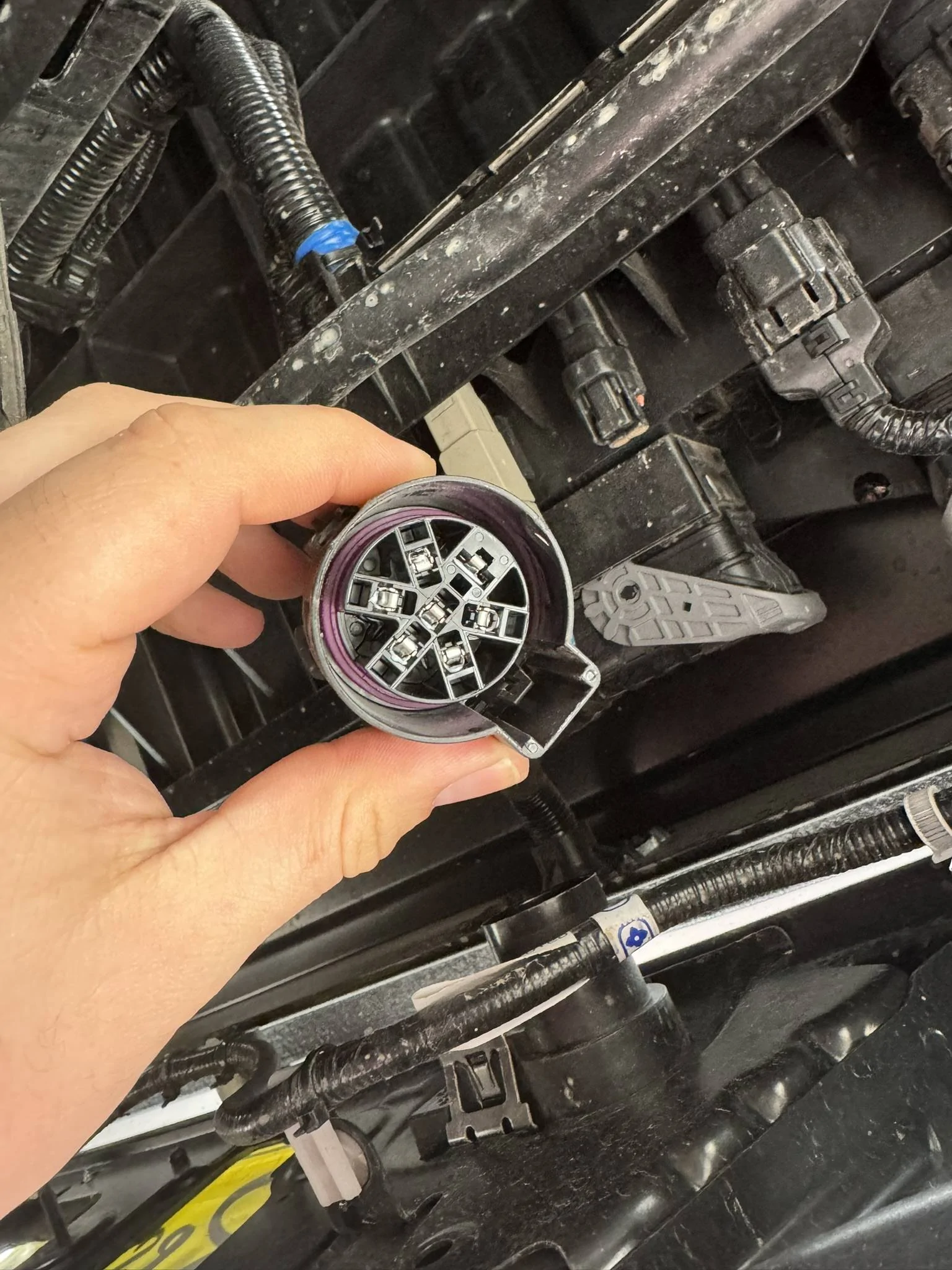

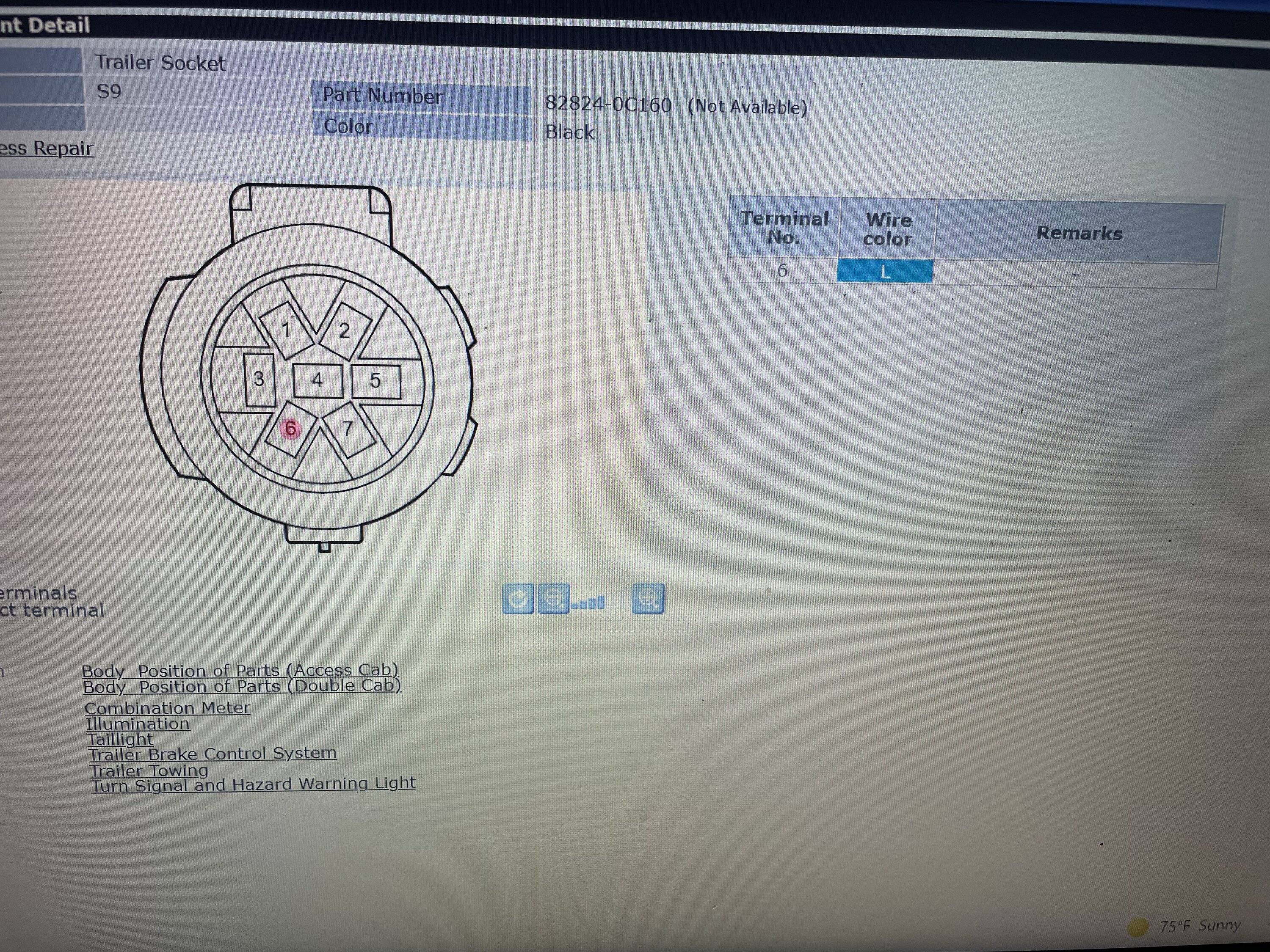

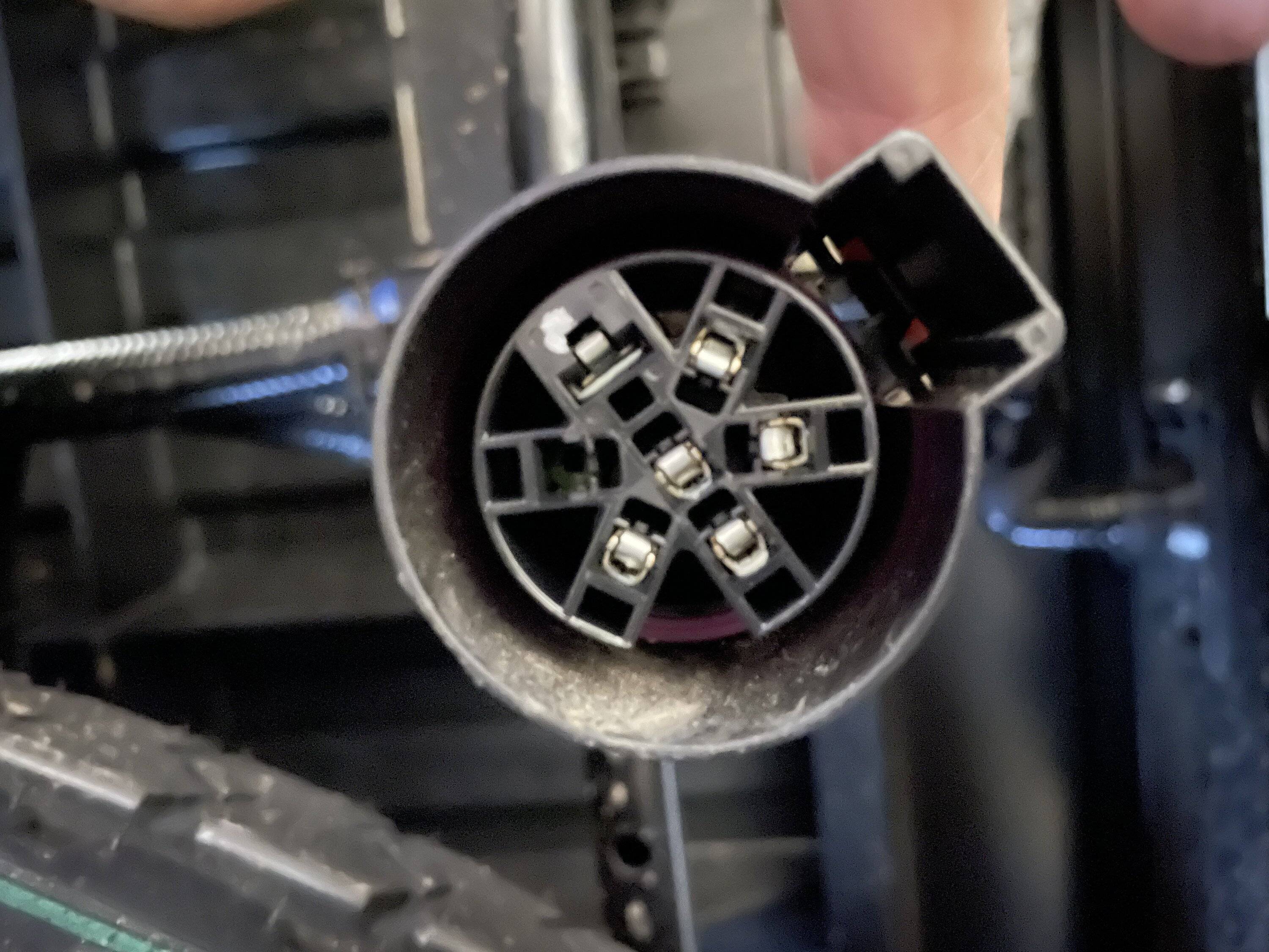

Update: after hours of looking at wiring diagrams and pulling panels off to see what my truck doesn’t have. Finally found that this pin is completely missing from my truck
I had an interesting discovery just a few minutes ago on my TRD OR. Your post prompted me to go check mine. I sure enough have a pin in that empty location and a nice larger gauge wire that goes back into the wiring harness. Hoping to find where it goes today. Fingers crossed.

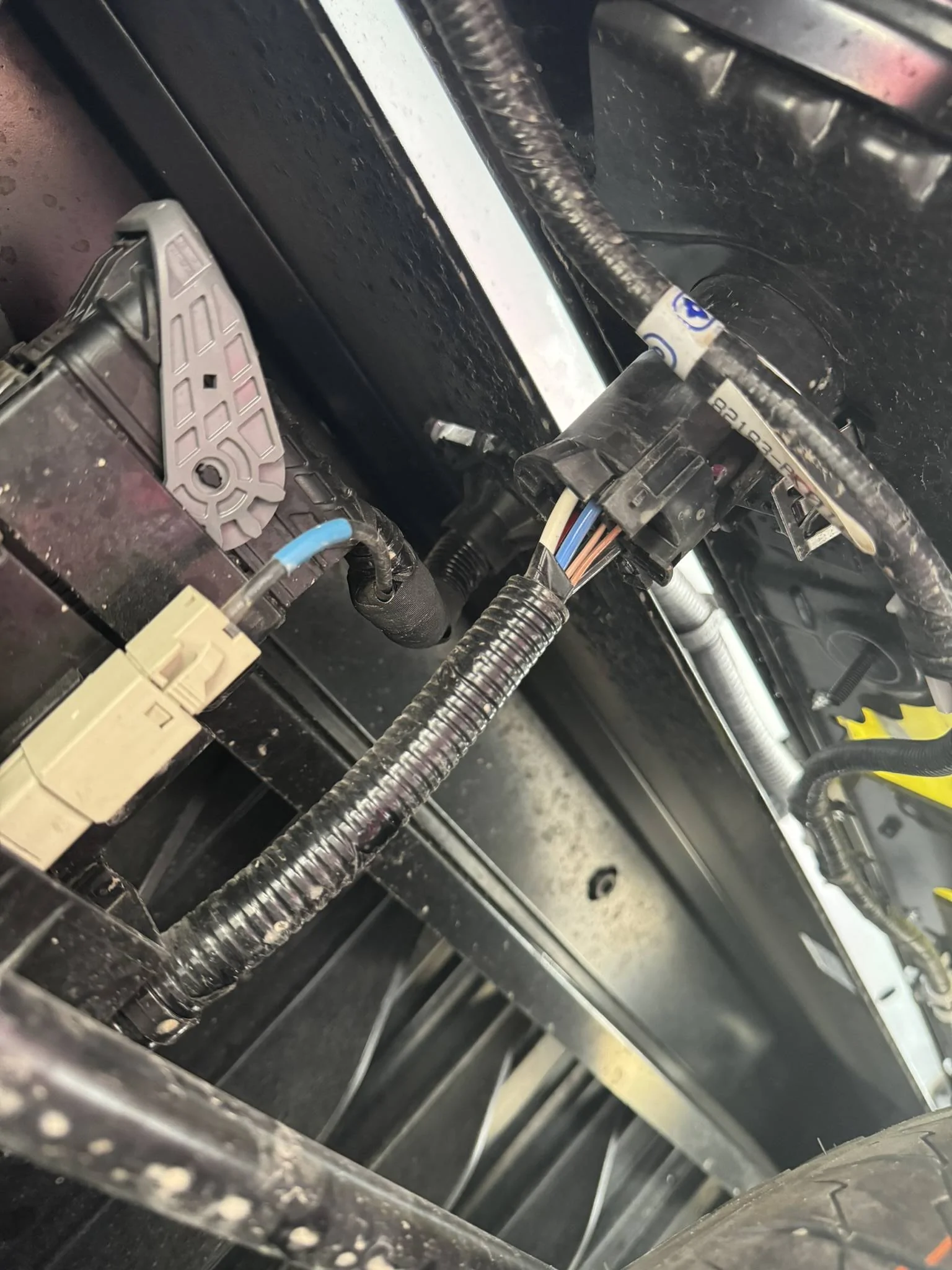

Here's the pics, I forgot I was waiting for them to sync to the computer and forgot. This is a base level TRD Off Road (no factory brake controller, cloth seats, etc.). However it does have the 14" screen and heated seat upgrade. I wonder if those might have something to do with it.
2024 Tacoma Brake controller harness for 4th gen Tacoma? IMG_1057
2024 Tacoma Brake controller harness for 4th gen Tacoma? IMG_1059
I did track these wires also to that crazy junction box under the passenger side rear seat...but I'm not 100% certain the trailer brake wire that I have goes there. There are some wires that split off under the bed and go to the driver side. I'm going to look around under the driver side dash today and see what I can find.
