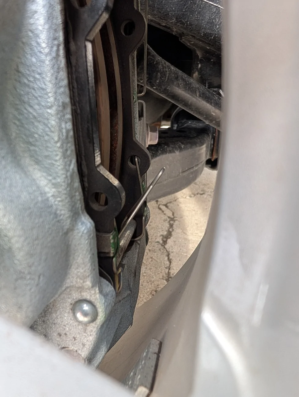

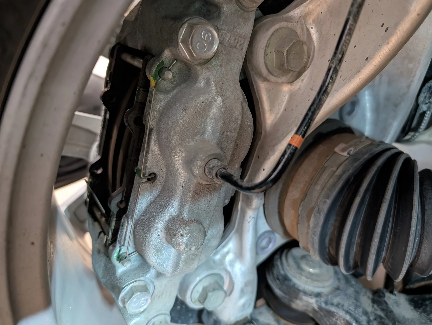

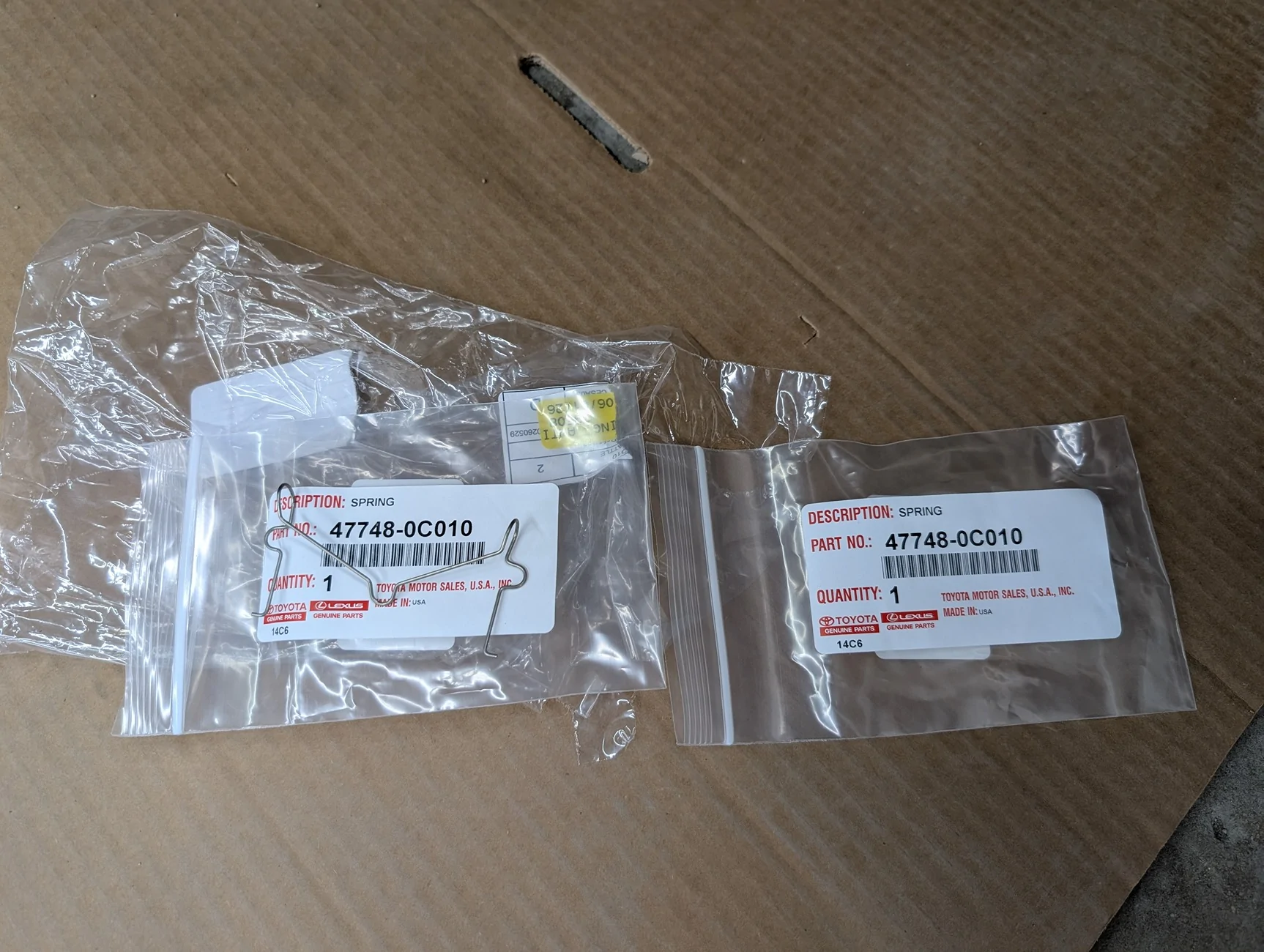

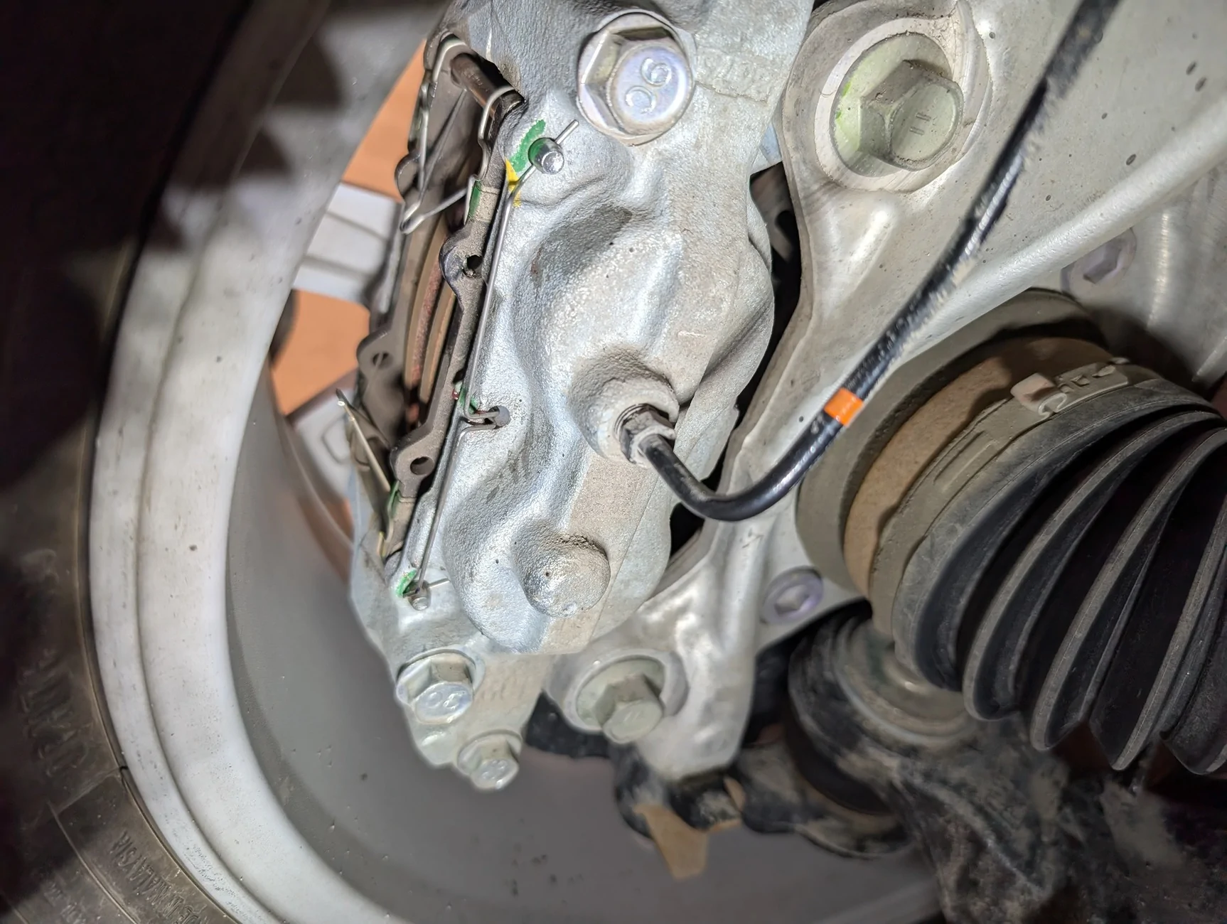

Found the part number. Funny enough, they are called anti rattle springs. Took the pad pins out. Cleaned and greased them. Installed the additional springs. No more rattling. Quiet ride
Pictures are part number, before and after install.

Didn't even have to take the wheels off btw.
