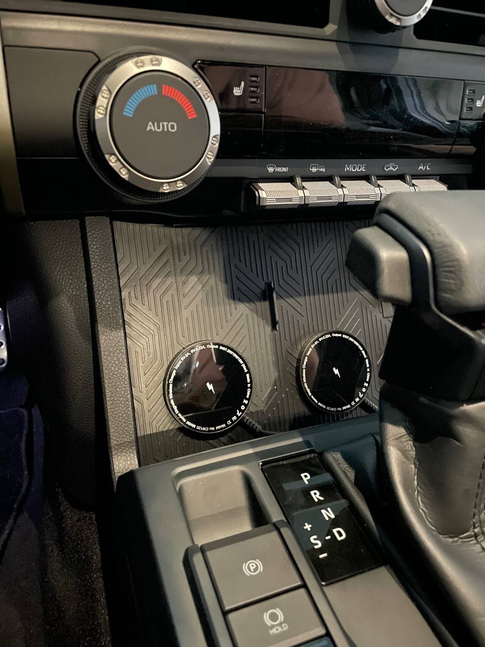

My sport did not come with the wireless charging but I did end up adding my own. Picked up two MagSafe chargers from amazon and fit them into the space where the wireless charger would be. Now my wife and I can both charge our phones while we drive, and since they are the MagSafe ones, we don't have to worry about our phones sliding or bouncing around. $20 well spent in my opinion.
Link to where you got it. Any modifications to get it to fit or it just works? I like the wireless carplay but when using waze it drains the battery and need it to actually charge.
