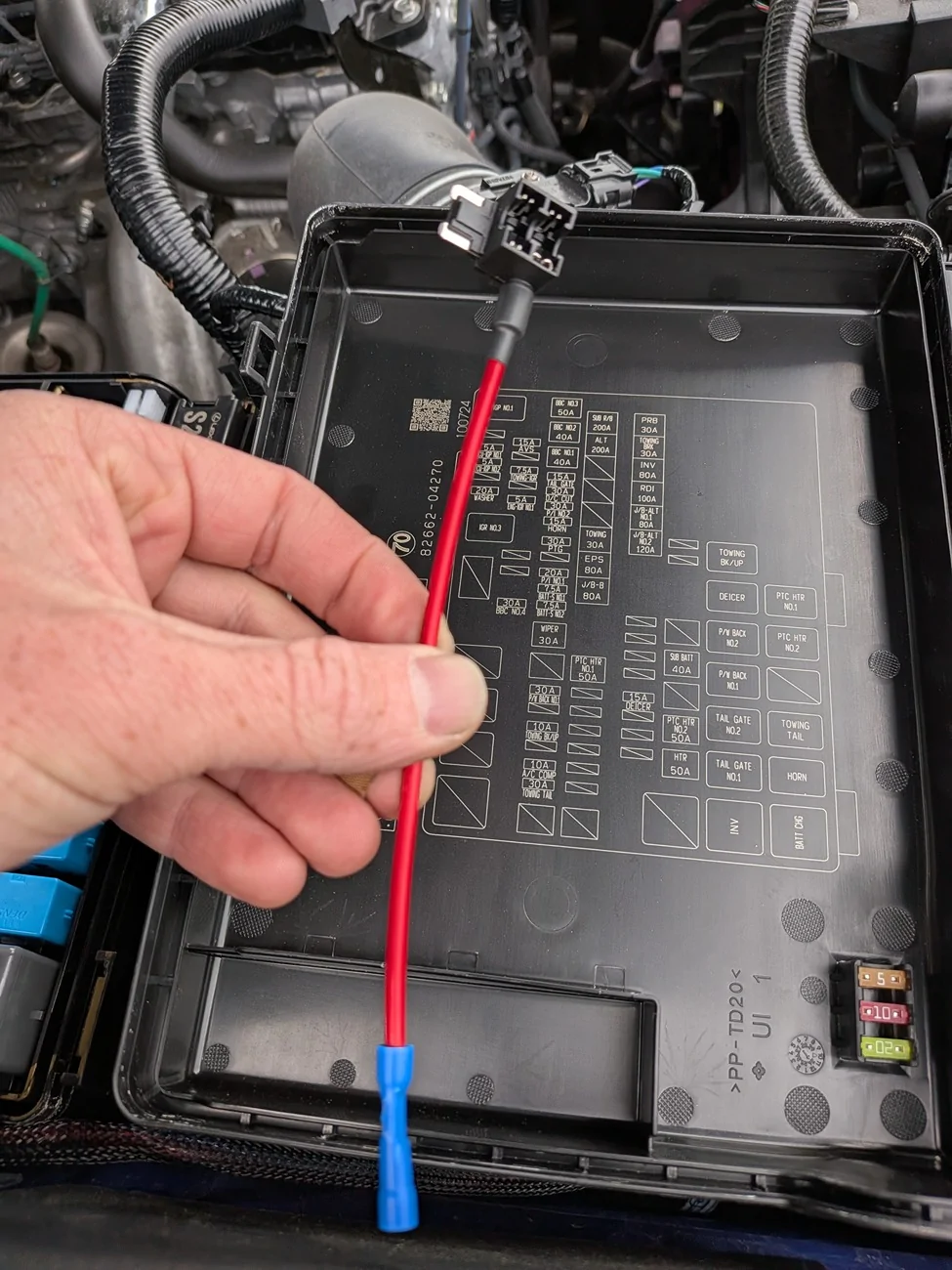

Alright, so my neighbor is an electrician and tested this slot for me. It's putting out 12v so I could put an add a fuse there with a 7.5 mini, but what is "towing IGR" ? There is currently no fuse in it, but only gets power when the ignition is on.
Ignition switched power for towing lights, etc.

Talking to myself at this point but hoping someone might have some insight 😂
So put an add-a-fuse on towing IGR, works great in that the Lightbar will now shut off when the truck does, but I was expecting it to power back up when I start the truck if I left it "on" when I shut the truck down. Instead I've got to hit the button at every start to turn it on. Something in the relay ? Switch ?
