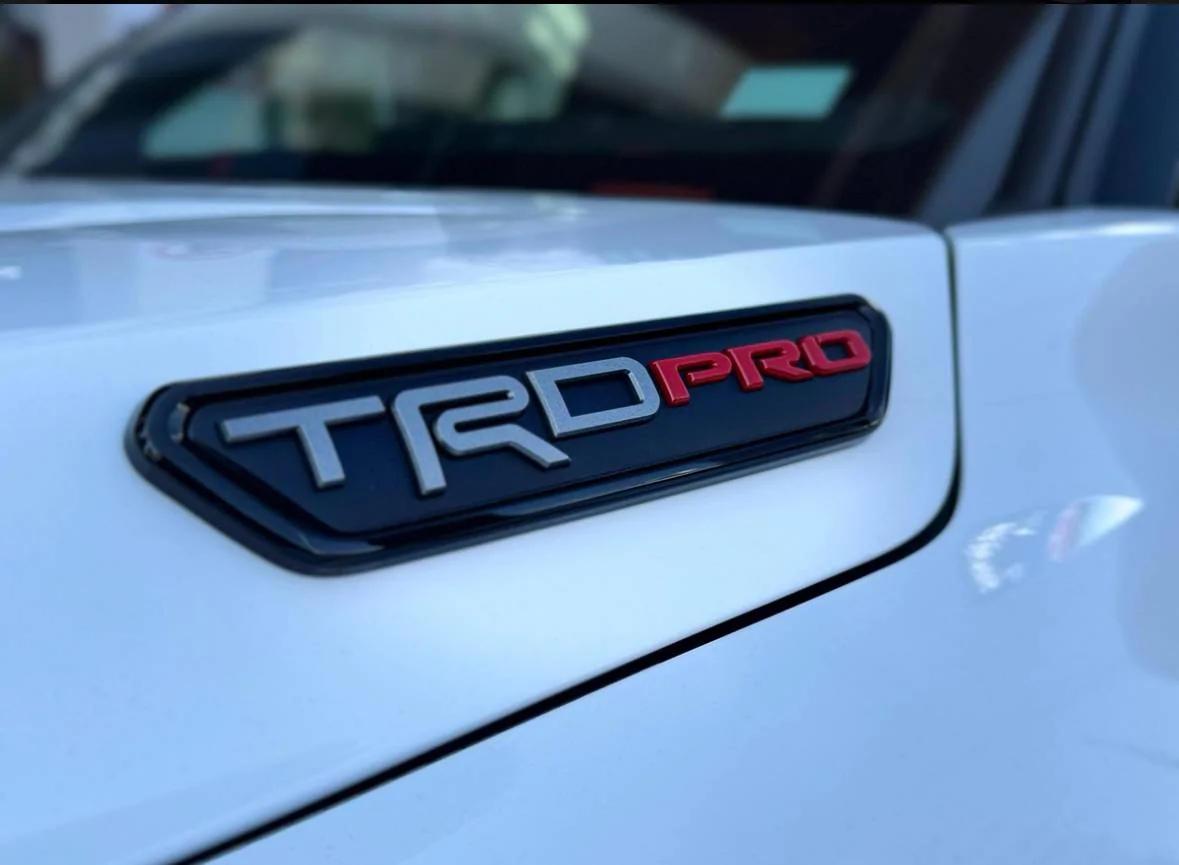

2024 Tacoma Can you remove the TRD PRO emblems from the hood? IMG_2459
Hello guys,
looking to remove the hood emblems on the TRD pro? Can they be removed safely without leaving any holes or cutouts behind as in they are only being held by double sided tape?
Thanks!
JC
2,226
2,846
That should be possible. Emblems like that are almost always just double taped onto the paint and you can use something like dental floss to cut under them. Then any tape residue can be removed with something like Goo Gone. All of that goes better on a hot day, which you should have in Texas.

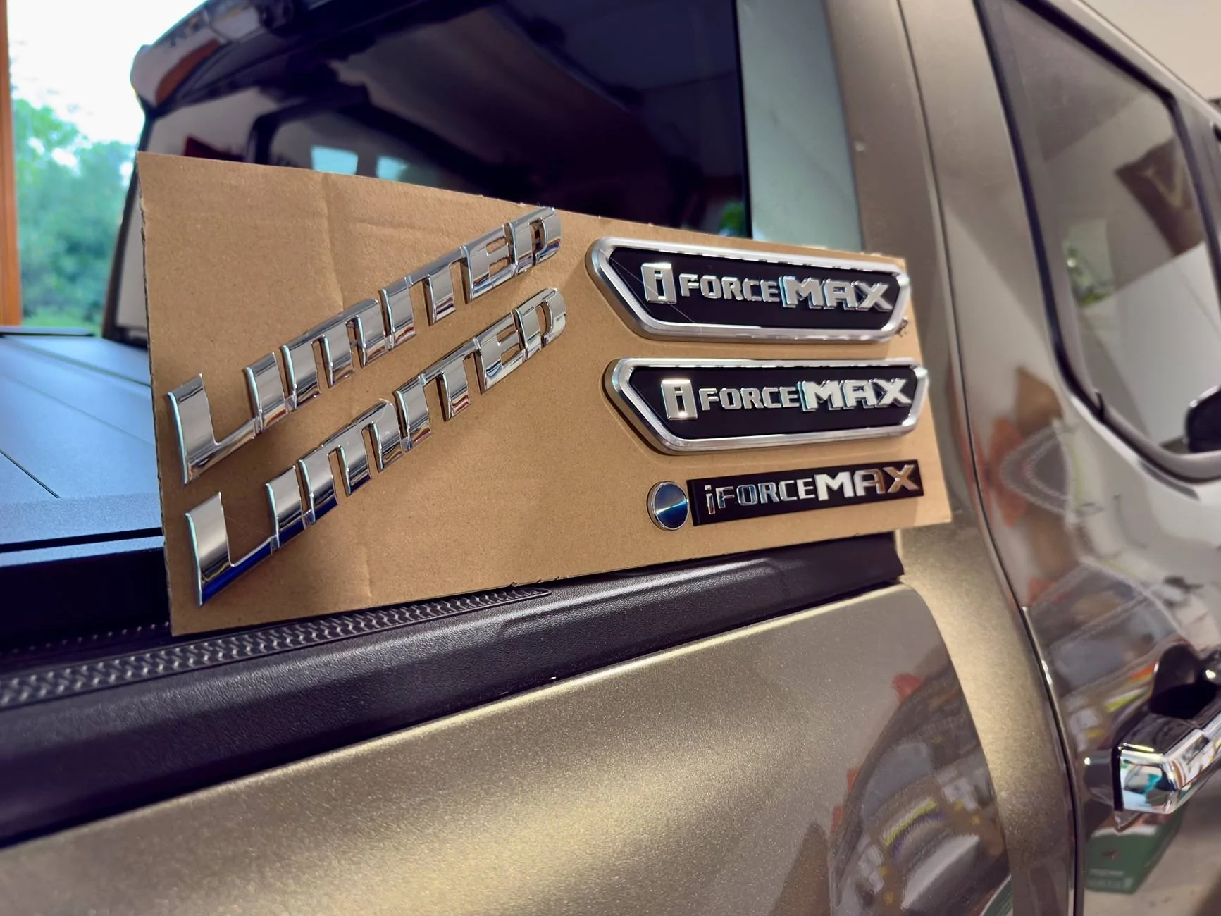

The hood badge is pretty tough to get off. The adhesive on the back is about a half-inch thick.
Grab some guitar picks to help. Warm the area with a hair dryer, and insert pics into the adhesive. Continue to warm the area. The pics will allow more heat behind the badge. Keep pushing the pics in until they're about half an inch behind the badge. Then use floss to free the badge.
I took a video debagging my i-Force Max. I'll try to have it up next week.

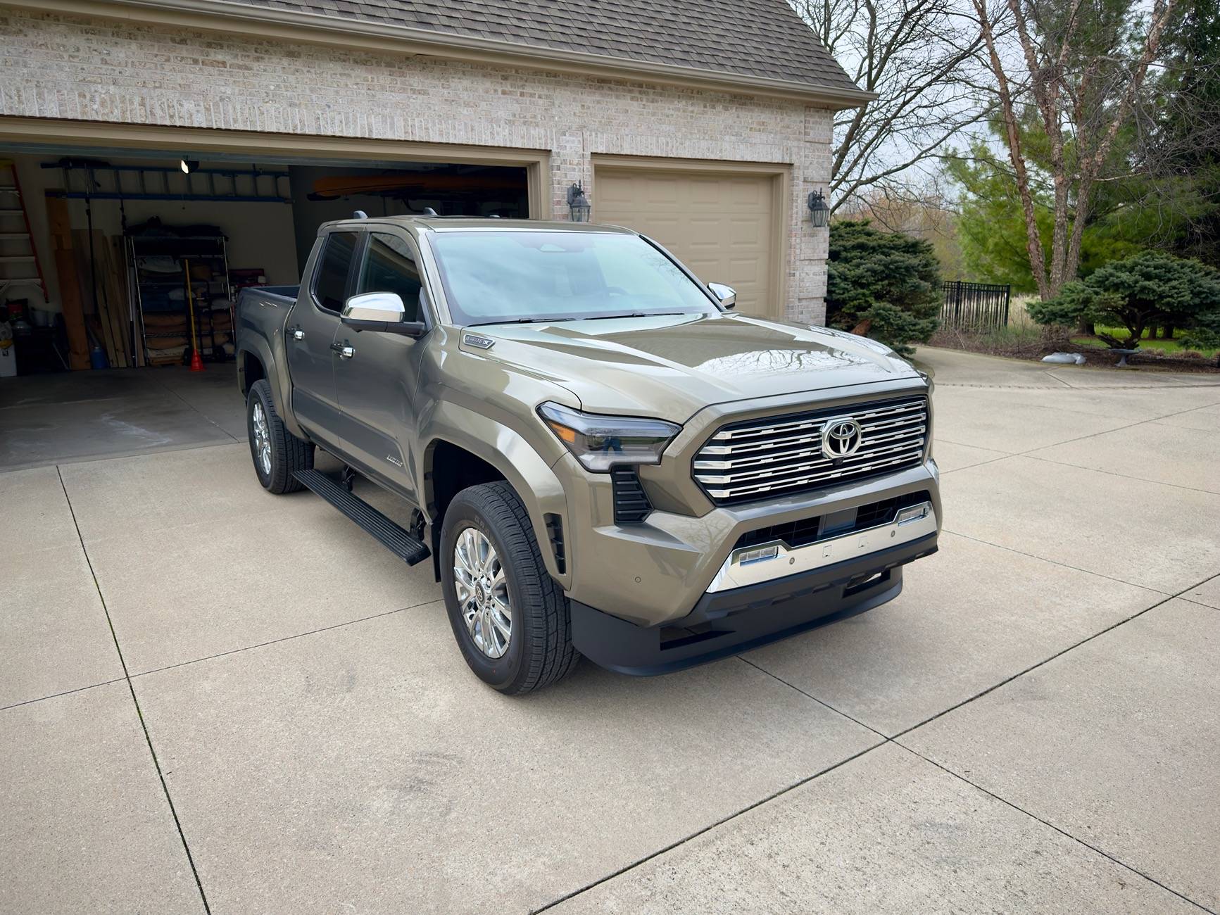

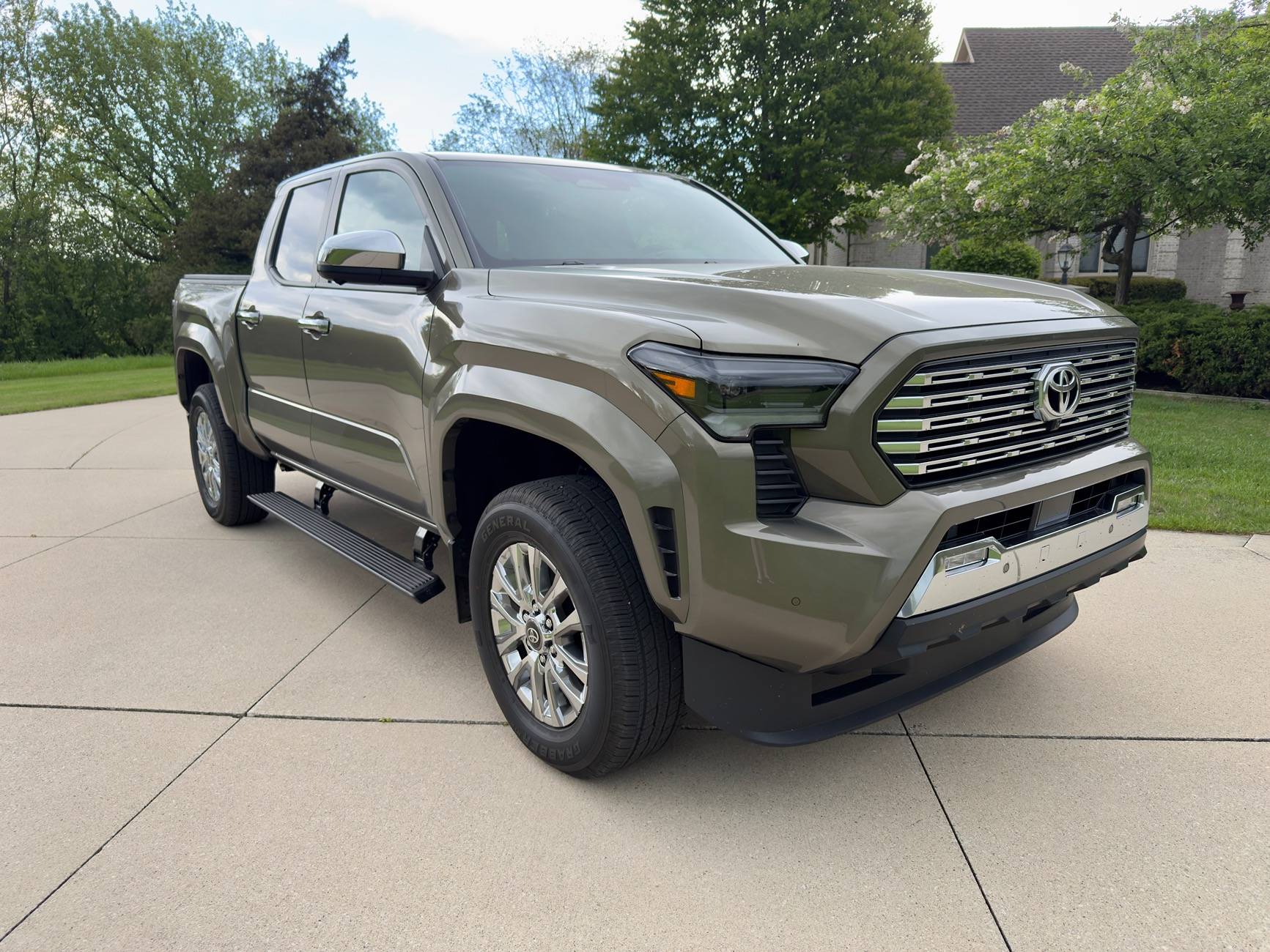

Before
2024 Tacoma Can you remove the TRD PRO emblems from the hood? IMG_0905
After
2024 Tacoma Can you remove the TRD PRO emblems from the hood? IMG_0996
Unnecessary badges removed.
2024 Tacoma Can you remove the TRD PRO emblems from the hood? IMG_1002
