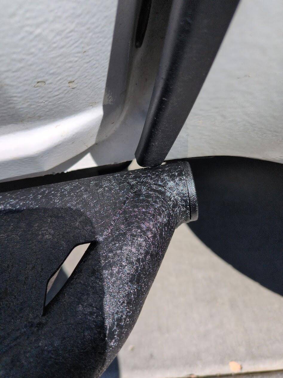

I remember few years ago where they ran a Tundra into this obstacle course where it's going high speed over bumps, and you can clearly see the bed wobbling. Granted this I have a Tacoma, and it might have been a 1st or early 2nd gen Tundra. I recently purchased and test-fitted a running board/step for my as I have the Off-Road, not that tall so needed a step to assist. However, I noticed that in the back, it's very close to the bed already. It's not touching, but less than 1/2" clearance:

I'm not planning to go fast off-roading or anything like that, just trails here and there, but will this be a concern if the bed does move?

I tightened everything up, moved it as far forward as possible and it's actually a lot closer to the bed now. Personally, it's too close for comfort and I don't want to regret it down the line.
Plus, I measured the ground clearance and it was at 11". Then I measured my 01 4runner's OEM running board and it's at 14" (w/ 1.5" lift). So definitely want something with higher ground clearance

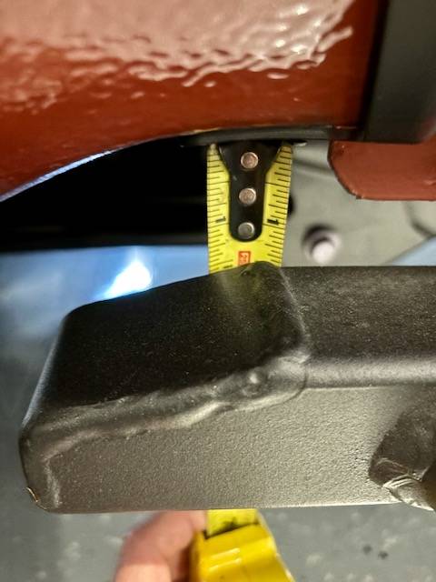

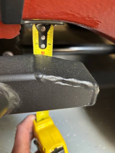

I agree. My RCI sliders sit under the bed just a bit, and they would touch if they sat as high as yours do. Here are a couple of pictures showing that I have about 1.5" clearance between the sliders and the bottom of my bed side.

I wouldn't feel comfortable at all with it like that. I'd be fearful of even trying to test it.
