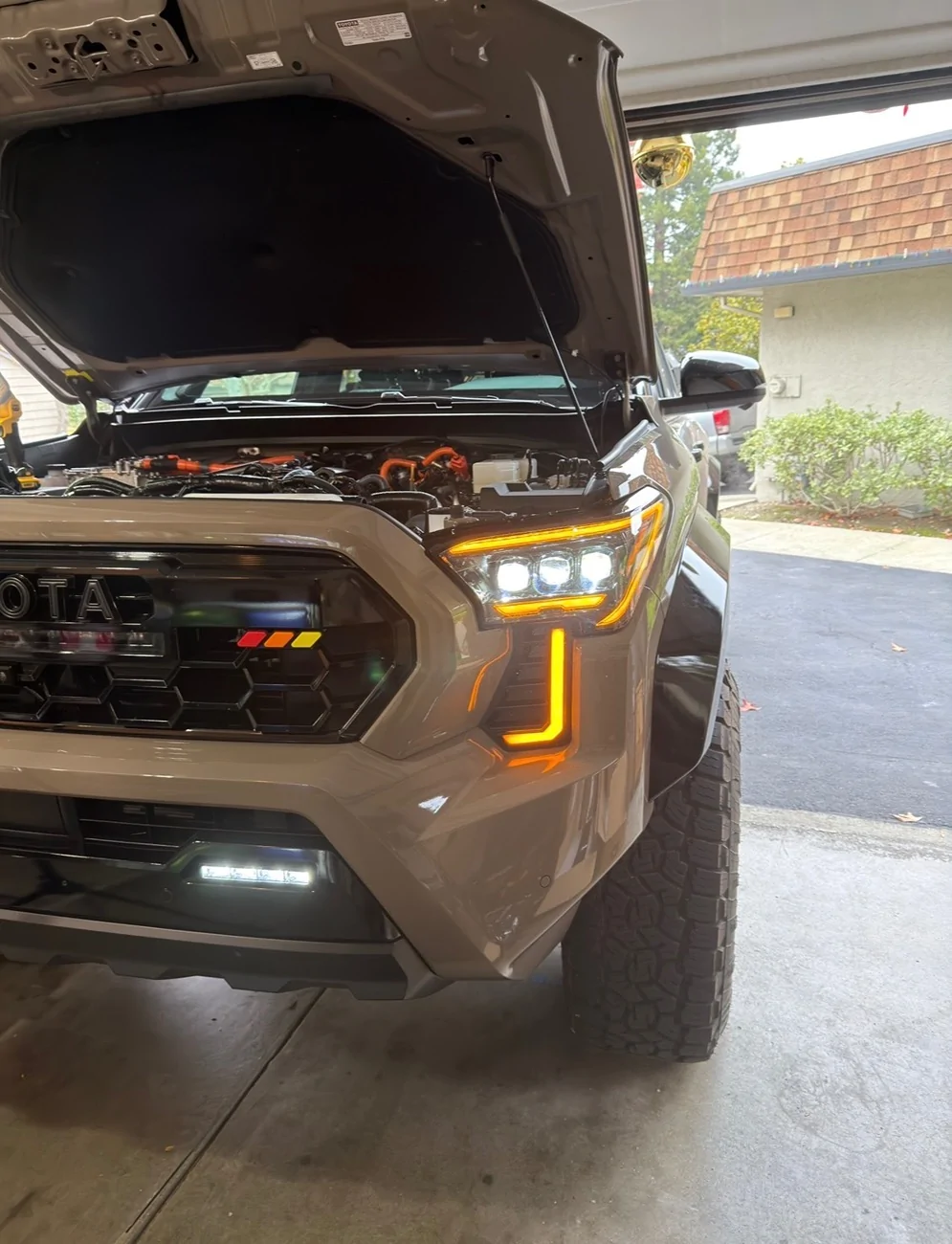

So, this is very weird. Recently I added the AlphaRex lights on the truck. Everything has been fine but randomly the low beam and high beam on the driver side light has stopped working. DRL works fine.
I’ve checked the connections and all seem well. I haven’t checked the fuses as I can’t find which fuses independently control each light. (My understanding is there is a fuse for right vs left light.
Also odd that the Rigid lights aren’t coming on - furthering making me feel like this is a fuse problem.
Looking for advice, options, fuse location or general input troubleshooting this.

It was the light itself. TacomaLifeStyle sent me a new set of AlphaRex lights and I swapped them out. While the grill was off I added the new LTX Fang Lights. Just waiting for my new SS6 Diode fog lights to come in.
