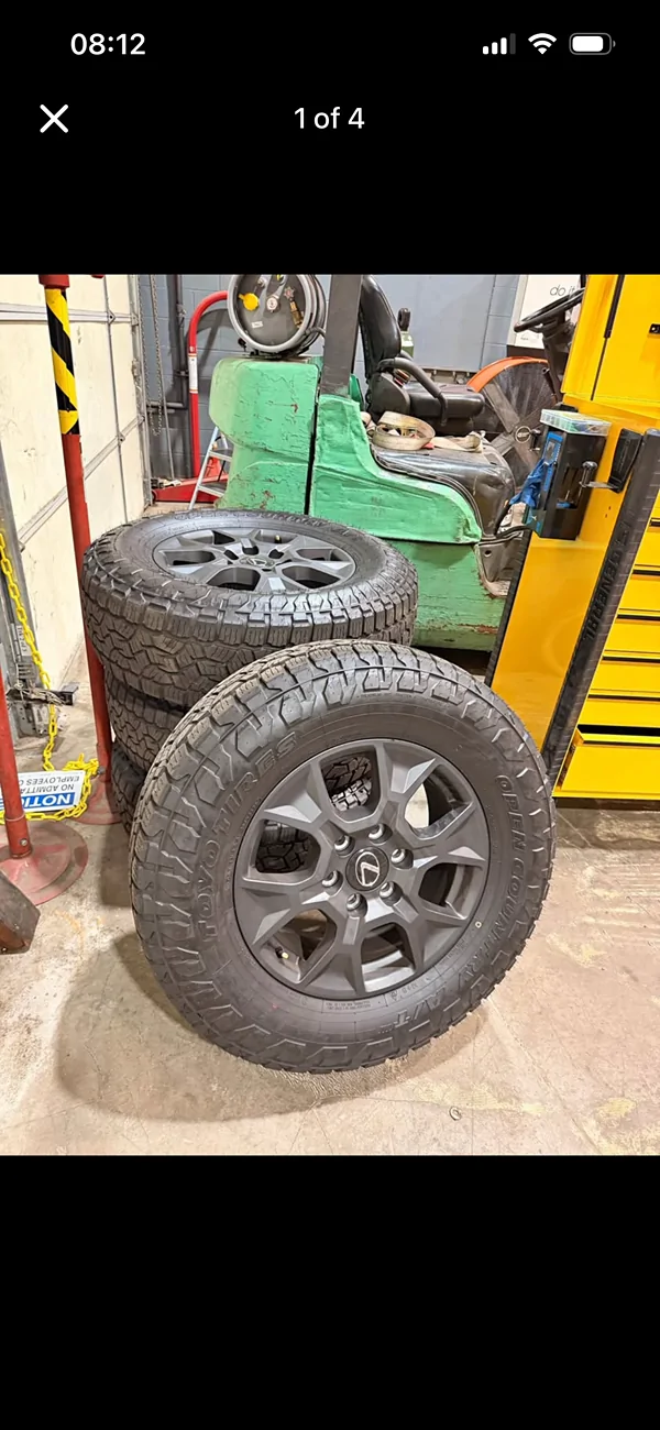

Curious if anyone has tried or could confirm the GX550 wheels are direct “plug & play” for our 4th gen’s? Found a set near me and was kind of thinking about it to do something a little different. Per google, they’re supposed to have the same specs minus the tpms sensors.

They’ll fit, pretty much all TNGA-F Toyotas have wheels that are interchangeable with each other. Those are 18”x7.5” wheels with +50 offset, so they‘re pretty much the same as the OEM TRD Sport wheels with the wheels 5mm more outwards. The tires are 265/70R18 so same size as the Hybrid models so they won’t rub either.

Anytime, I’m pretty sure the center caps are interchangeable too, so you can use your OEM Toyota ones or one of the many varieties Toyota has on the new trucks.
