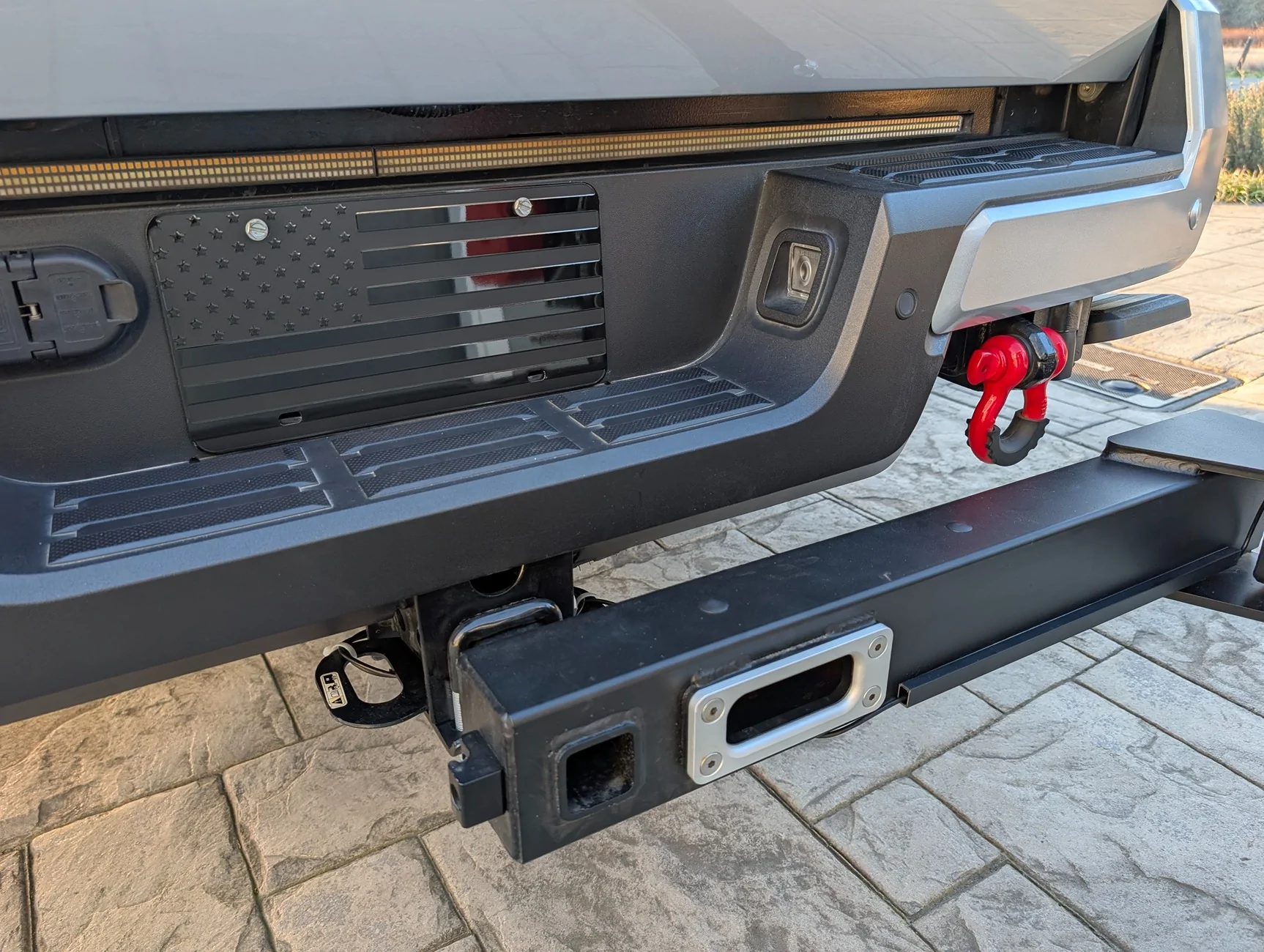

Here's the problem. The double-wall receiver actually has two walls (duh!), the inner receiver and an outer shell. There's a ~1/4 inch air gap between the two and the outer shell is fairly thin....you see where this is going....when you torque down on the bolt the outer wall deforms. If you continued you might eventually pinch the outer wall all the way down against the inner receiver tube, but it seems likely to me that somewhere in that process you'll break a weld or some other bad thing.
I have a friend with a '24 Tacoma and he's used a Recon bike rack for a while now. He never noticed it but when we looked at his truck the outer wall was significantly deformed. Every time he puts the rack on it bends just a little more. It also seems to me that when you're driving on rough roads the constant twisting and pulling will probably deform it more and lead to it being loose over time.
I puzzled over how to fix this. There are external devices like this and for most people that's probably the best solution. They work pretty well and prevent most movement. I don't think they're as good as the internal pinch clips though, and my Alta rack actually uses both together to prevent the rack from moving.
In the end, here's what I did. I took my die grinder and reamed out the outer wall until I had enough room to fit a 5/8" steel bushing in. Now the bolt is pressing against the inner receiver and not the outer wall. Not many people will want to take a die grinder to their receiver but I'm not most people....

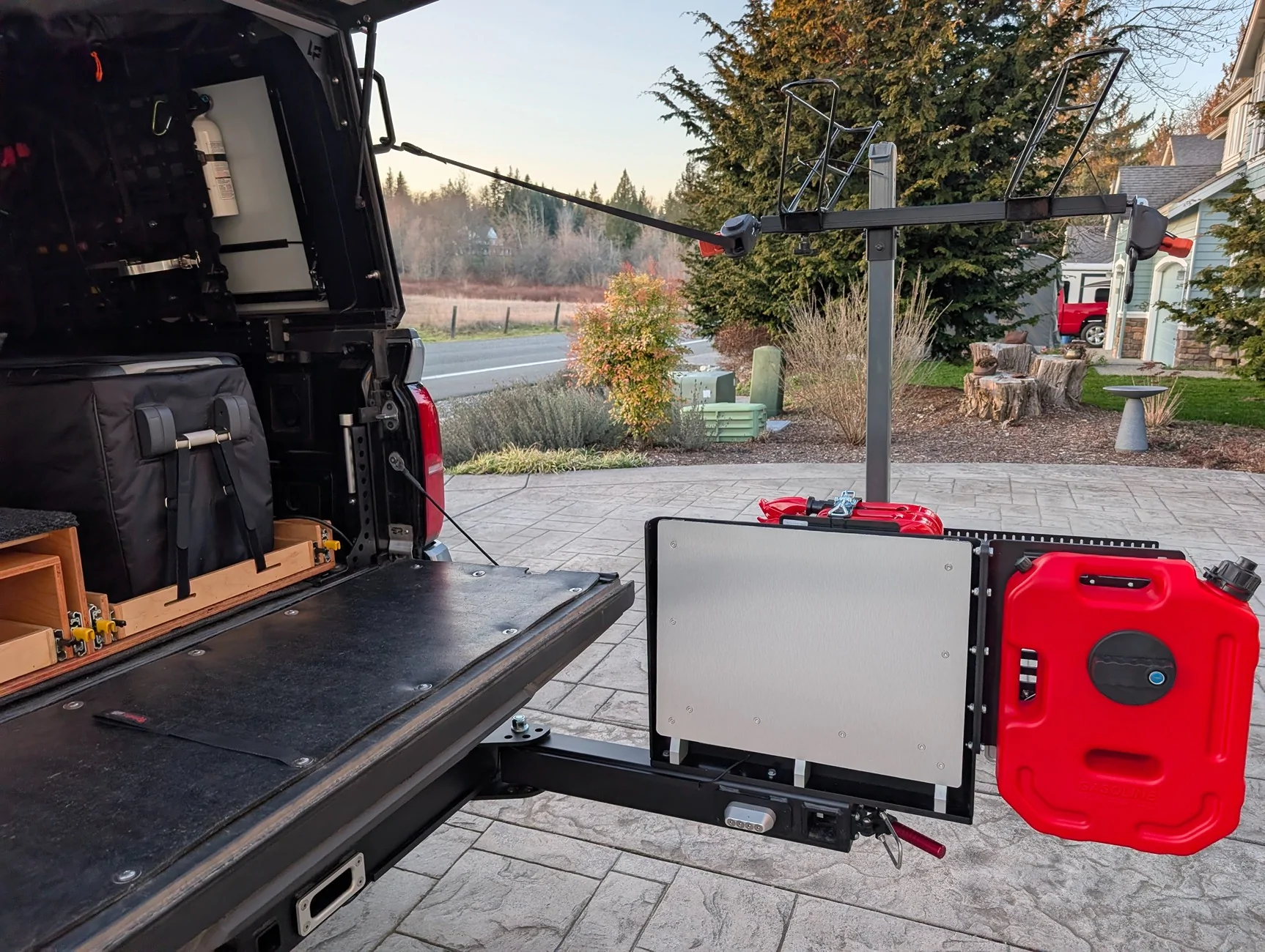

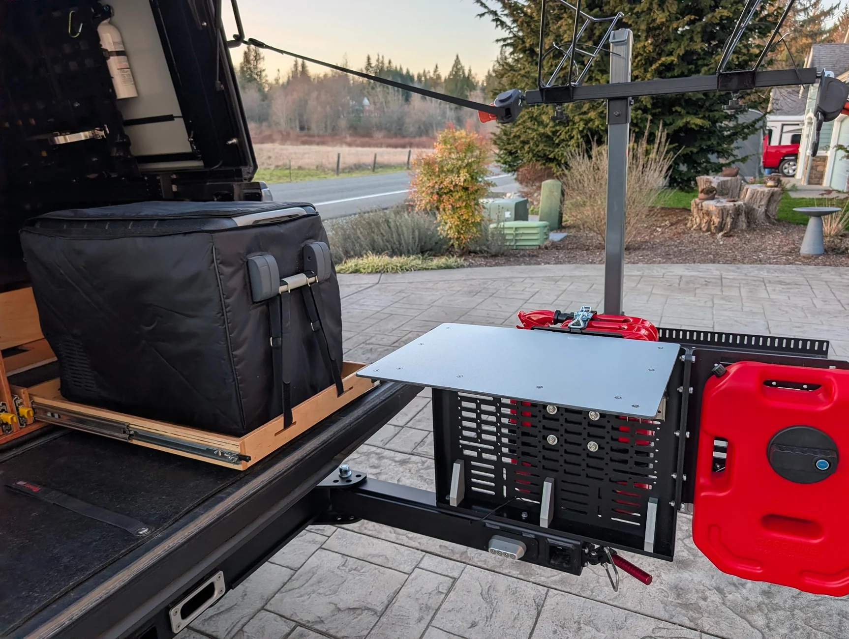

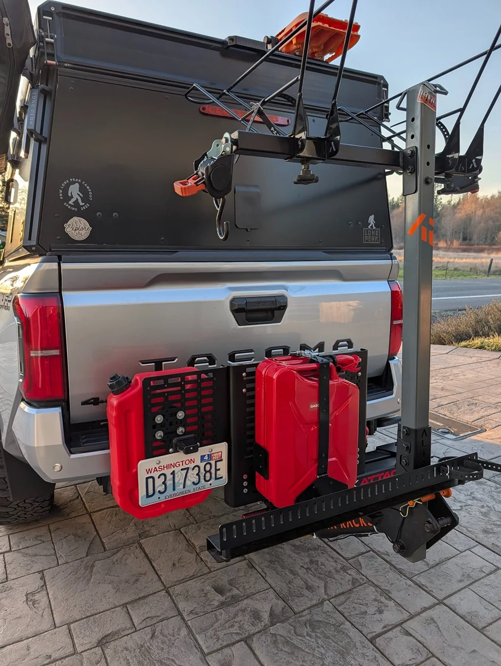

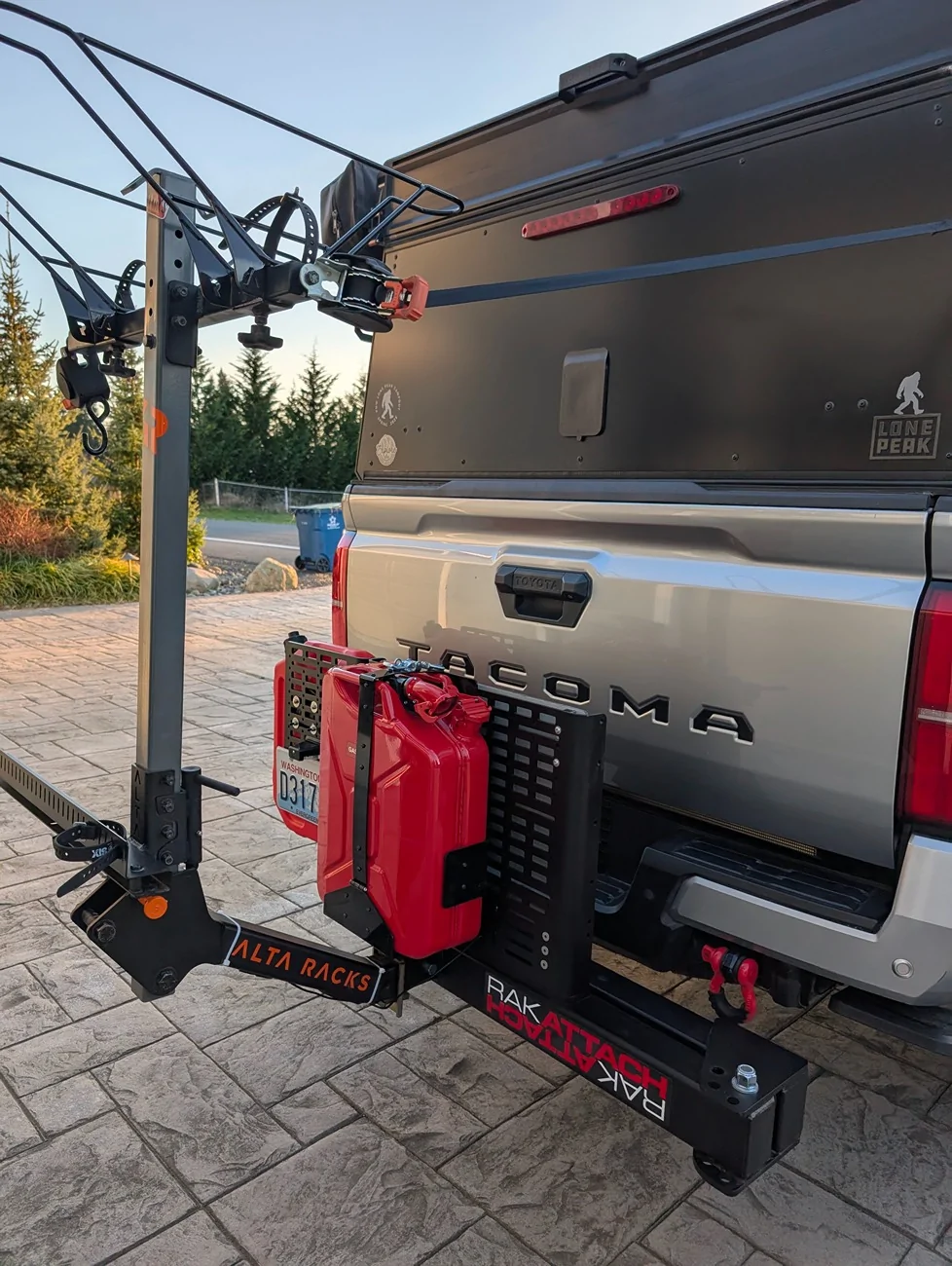

Gratuitous pics of my set up. I have some cleanup to do but it's 90% there!
