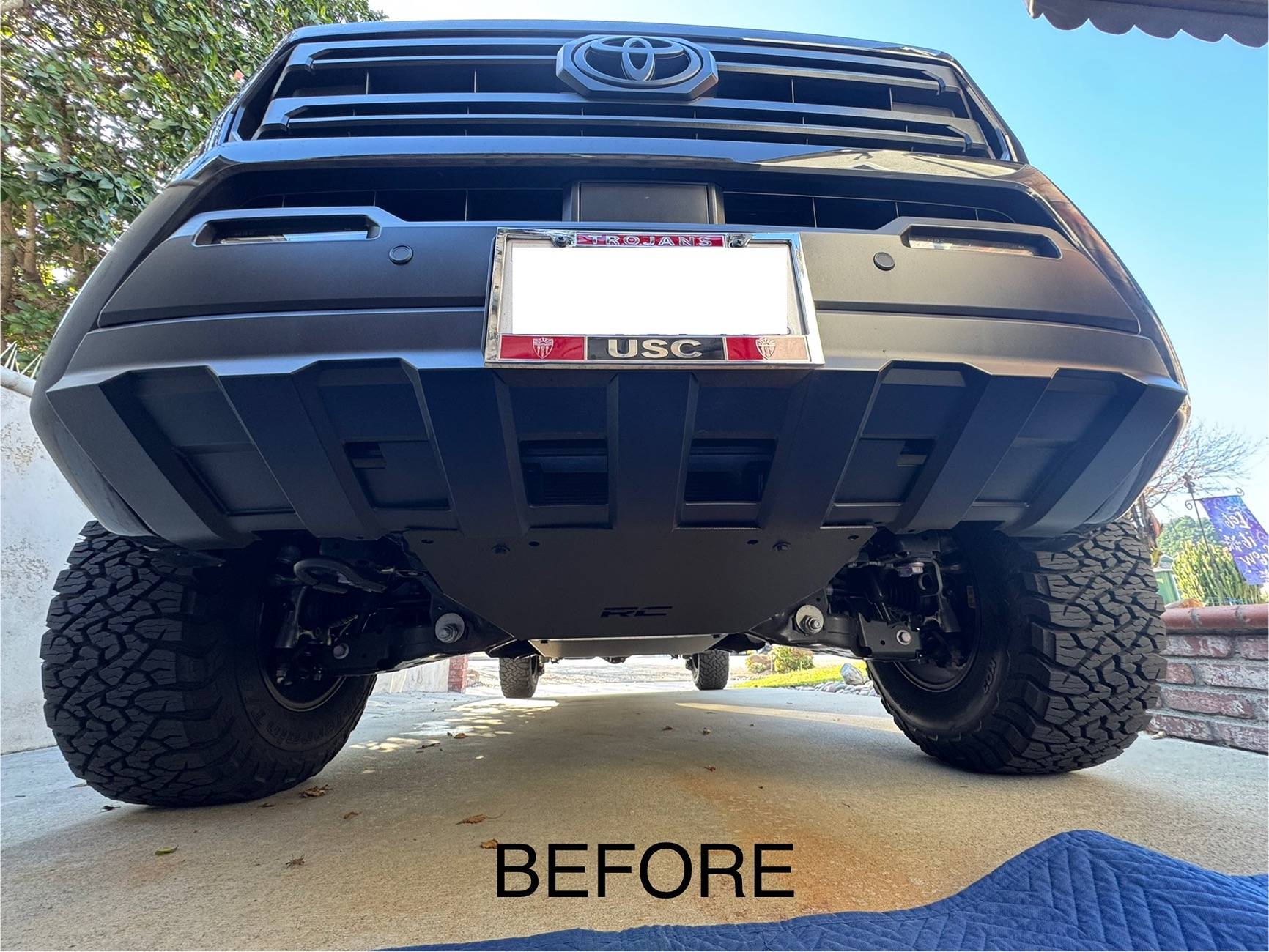

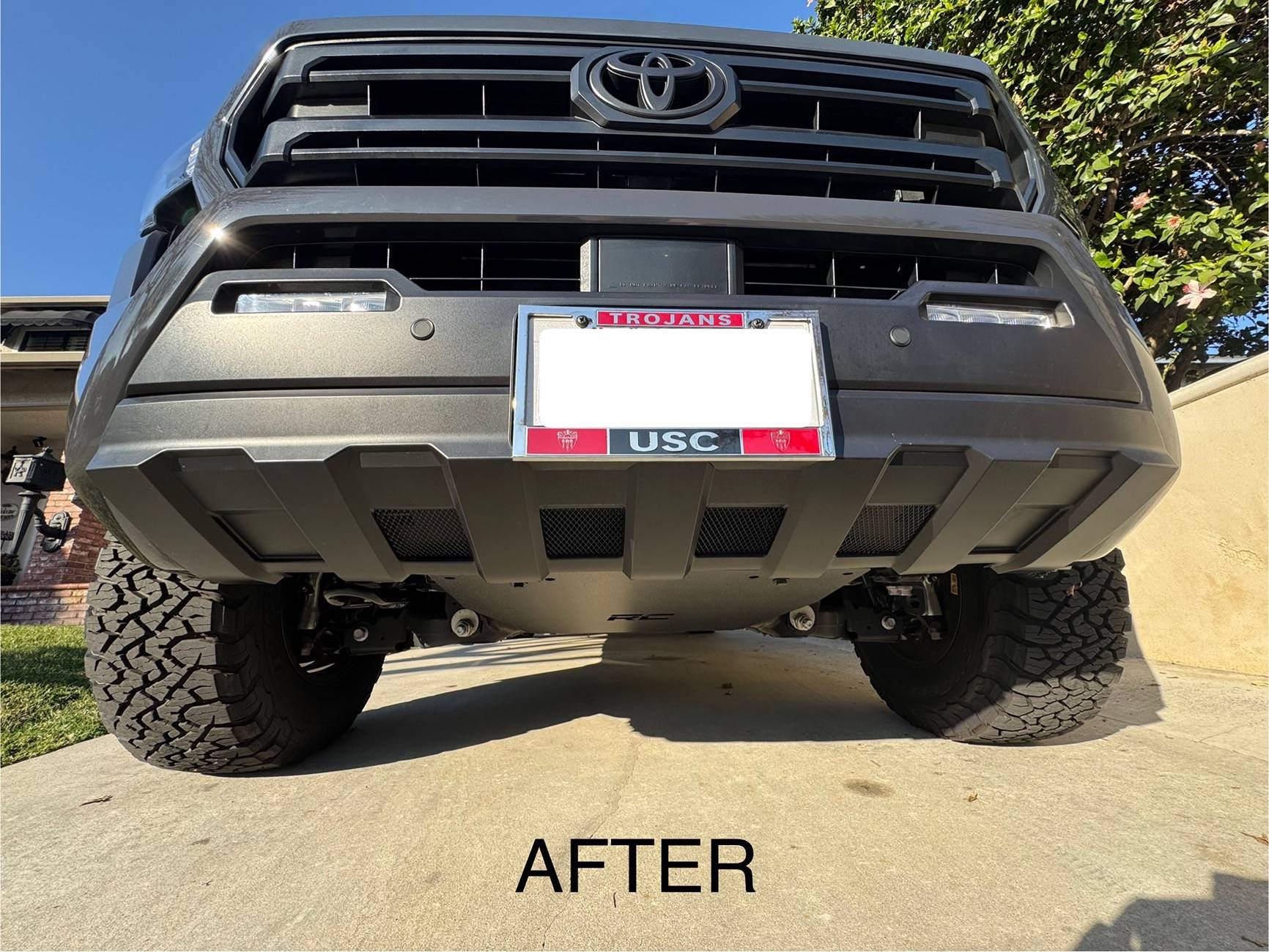

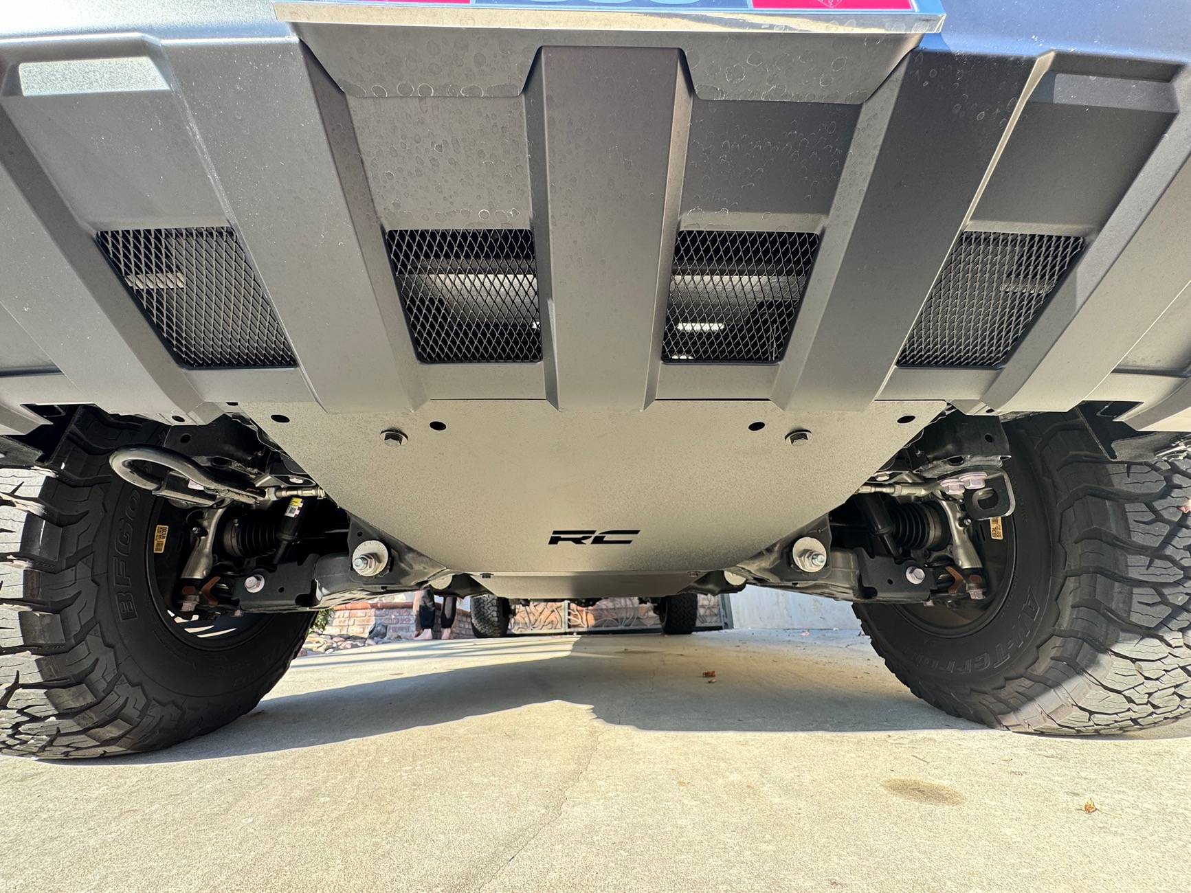

I have zero concern of things actually making their way through these holes. What are these holes even called? I’m just on vacation and bored. Shoutout to @TheGreatWhiteNorth for the idea.
2024 Tacoma Front Bumper Underside Holes Cover - Aluminum Mesh DIY Solution IMG_7199
2024 Tacoma Front Bumper Underside Holes Cover - Aluminum Mesh DIY Solution IMG_7210
2024 Tacoma Front Bumper Underside Holes Cover - Aluminum Mesh DIY Solution IMG_7211

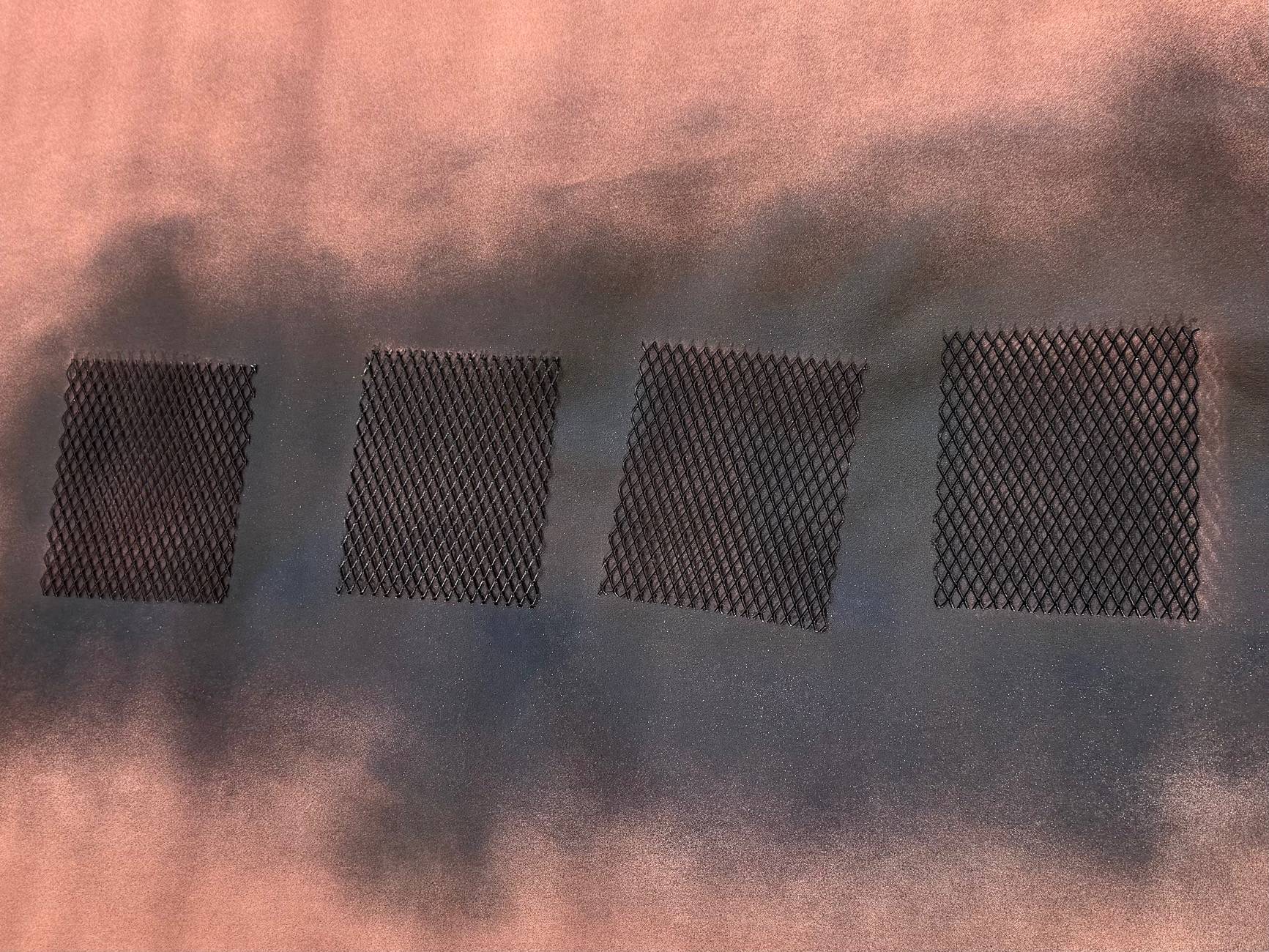

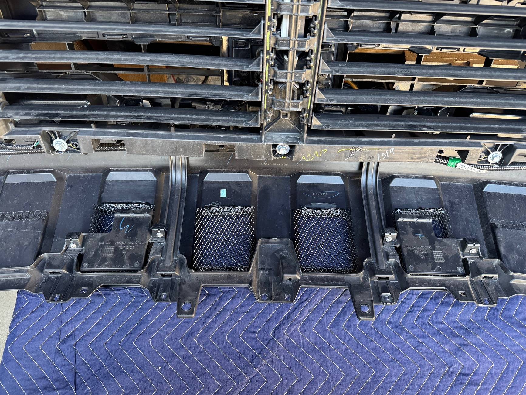

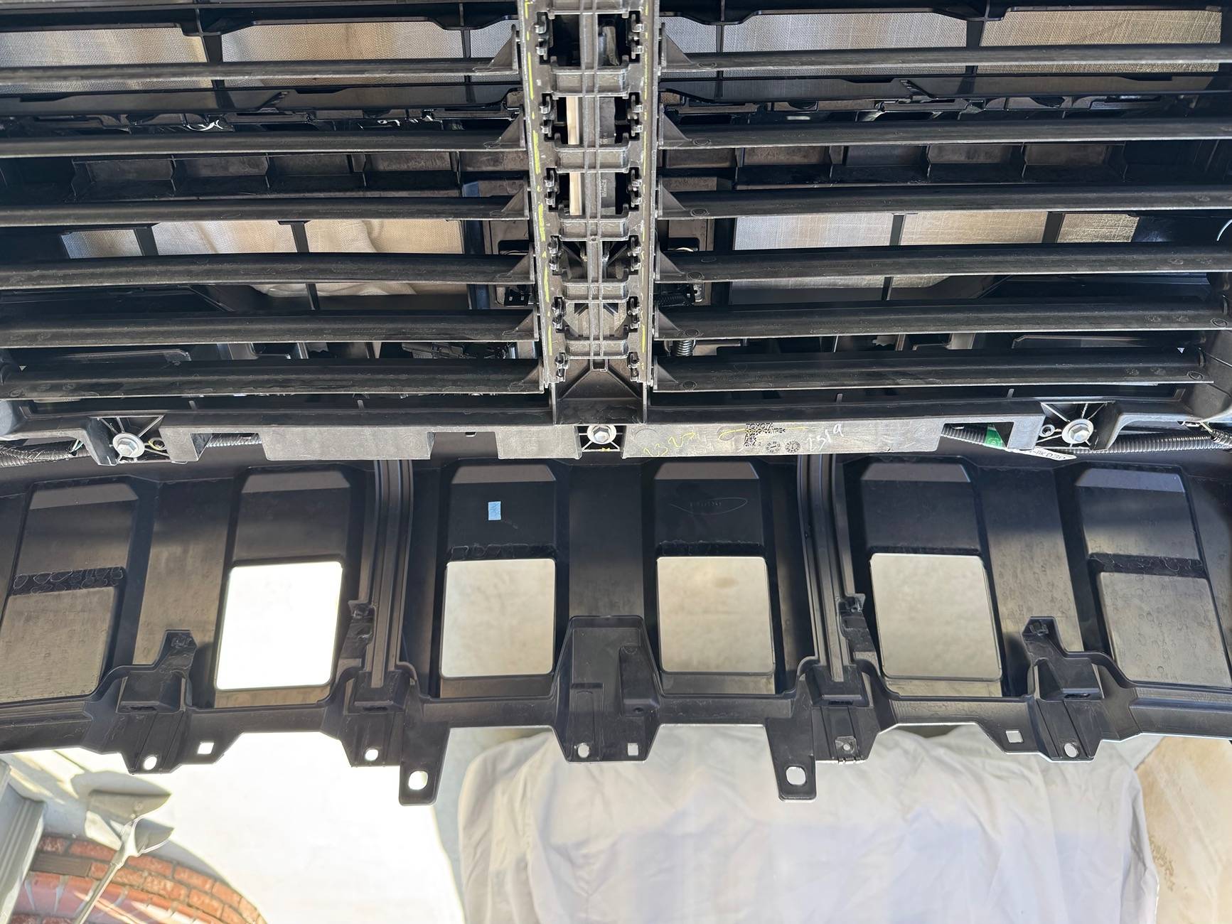

Bought the car grill mesh and truck bed liner spray on Amazon. Used black seam sealer compound to tack down mesh behind the holes.
