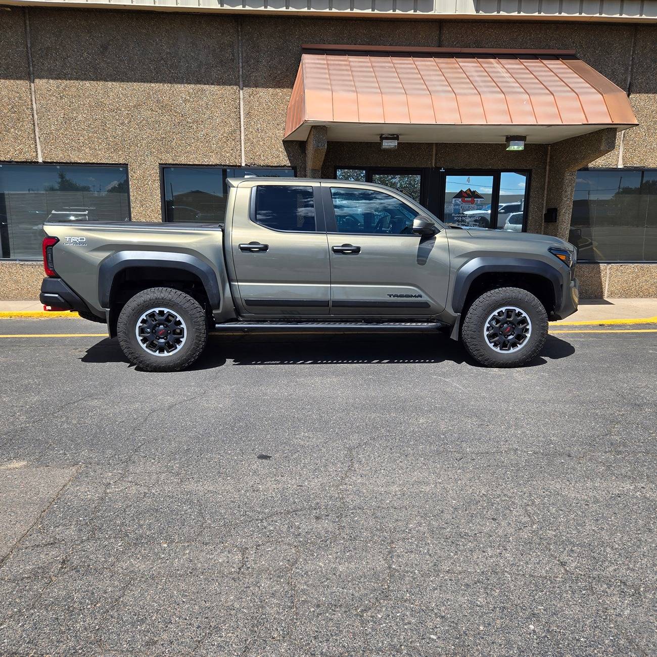

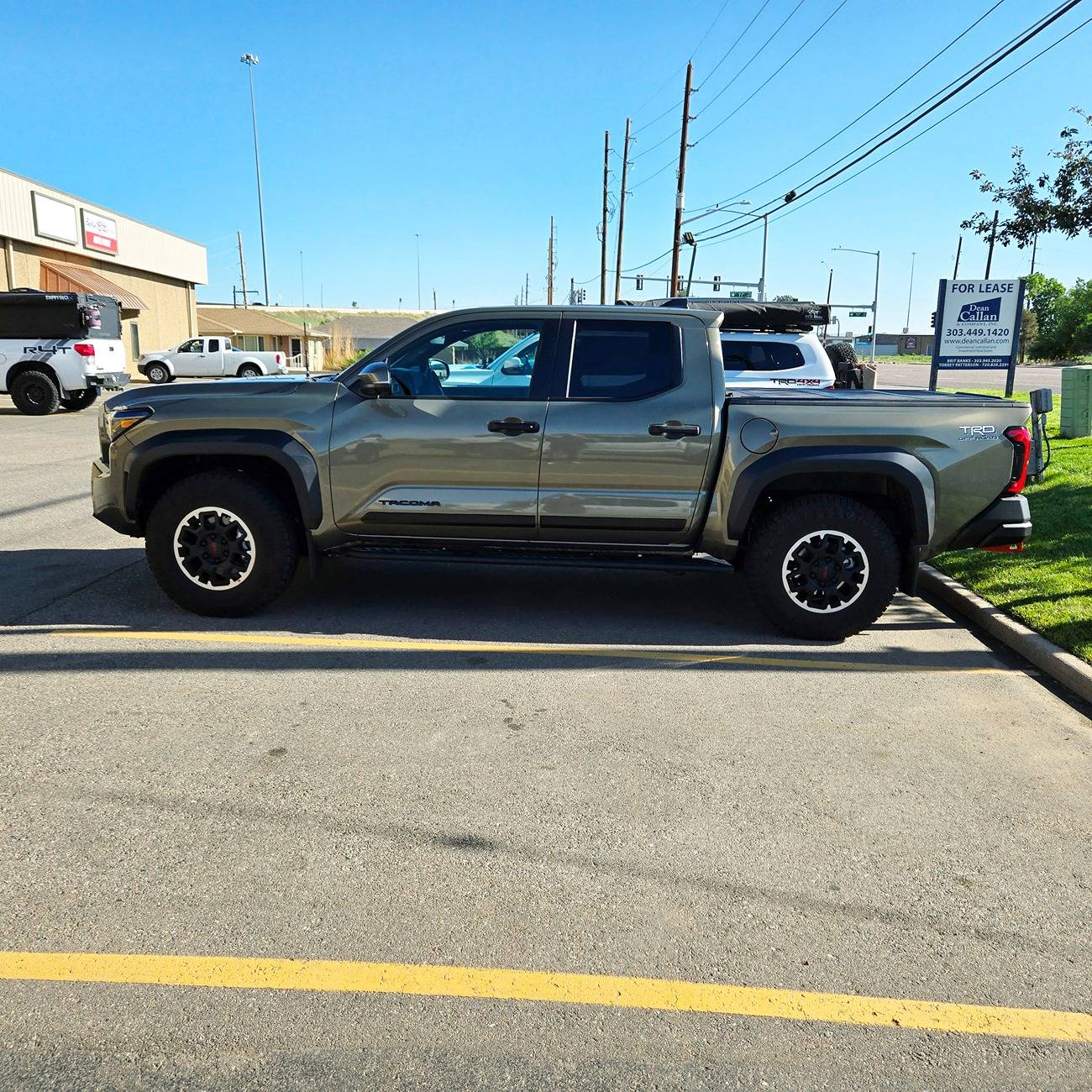

Why does the rear of the truck look so damn high? I have seen this a couple times with Alldog lifts? Meaning it does not look level at all. Something looks off to be honest.
Its not supposed to be level. Toyota builds some rake in. Some peopl;e level it out others like it. I happen to like it. It also prevents squat when towing.
If you like it level, then just doing the front springs will do that
