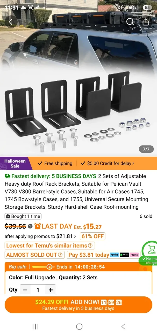

If anyone is still interested i went with these TEMU brackets $16, I bought a Pelican vault V800 and ill post pics of them when they arrive.
2024 Tacoma Harbor Freight Apache Cases installed on roof rack Screenshot_20261017_233104_Temu
