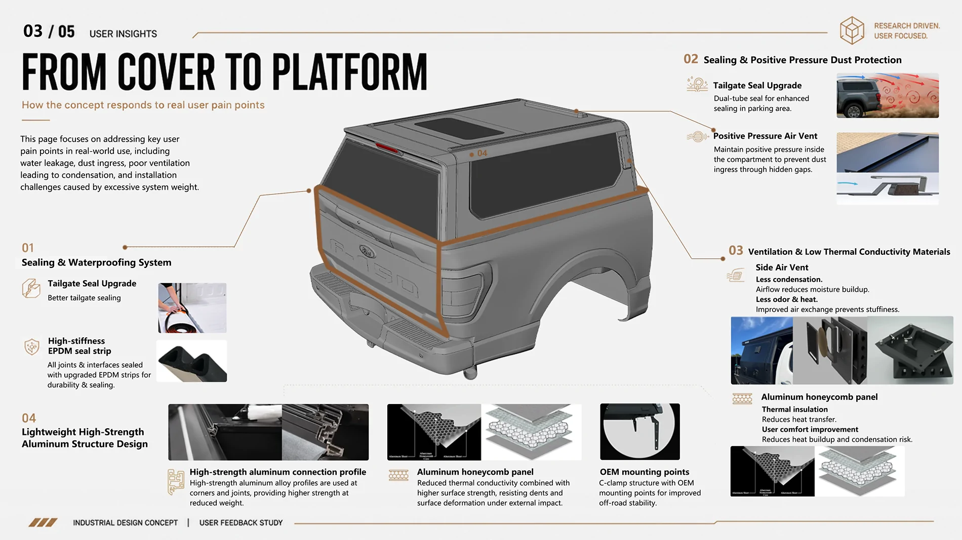

Proposed Protection and Climate-Control Solutions
Upgraded Sealing System
The current concept includes:
  • An improved tailgate sealing solution
  • High-stiffness EPDM sealing strips
  • Upgraded seals around panel joints and interfaces
  • A dual-tube sealing approach around key openings
The goal is better durability and more consistent sealing as the vehicle flexes during daily driving and off-road use.
Positive-Pressure Air Vent
A positive-pressure vent would help maintain slightly higher air pressure inside the shell while the truck is moving.
This may help reduce the amount of dust pulled through small gaps and hidden openings.
It will not create a laboratory clean room in the truck bed, but it should make the cargo area less interested in collecting an entire trail's worth of scenery.
Side Ventilation
Water-resistant side vents are proposed to improve airflow and help reduce:
  • Condensation
  • Heat buildup
  • Trapped odors
  • Stale interior air
This is especially important for owners who sleep inside the shell or carry wet camping, fishing, or work equipment.
Aluminum Honeycomb Panels
The concept uses aluminum honeycomb panels to provide:
  • Lower thermal conductivity
  • Reduced heat transfer
  • Better resistance to dents and surface deformation
  • High strength without unnecessary weight
Combined with ventilation, this material approach is intended to improve comfort while keeping the structure manageable.
Lightweight but Reinforced Construction
Instead of relying on one extremely heavy shell, the concept uses a modular aluminum structure with high-strength connection profiles at the corners and joints.
This approach is intended to provide:
  • Structural rigidity
  • Lower overall weight
  • Easier transportation and assembly
  • Better serviceability if one panel or module is damaged
Factory mounting locations and C-clamp connections are also being considered to improve stability without drilling into the truck bed.
The idea is simple: strong enough for rough use, but not so heavy that installation becomes a neighborhood lifting competition.

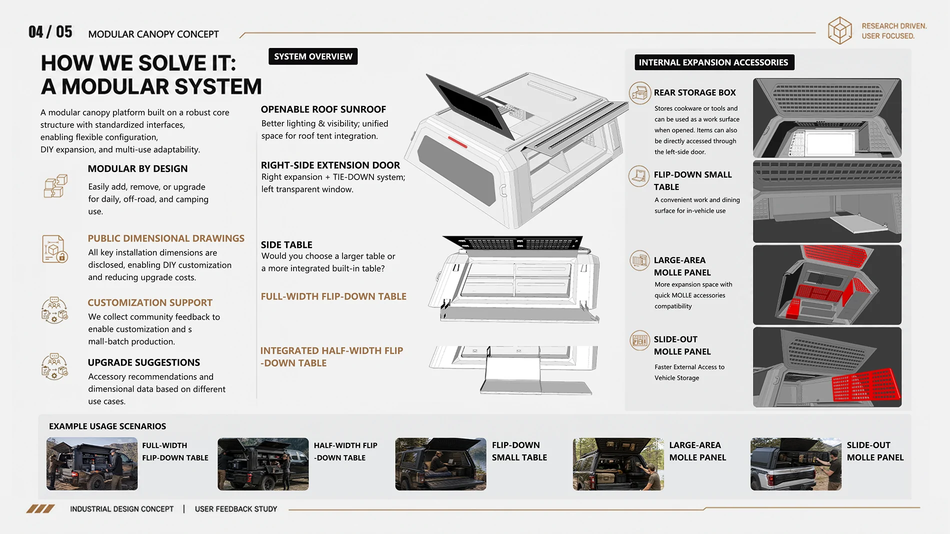

From Camper Shell to Modular Platform
The main idea behind this concept is that owners should not have to purchase every feature on day one.
The base shell would provide the essential structure and protection, while standardized mounting interfaces would allow additional accessories to be added, removed, or upgraded later.
Expansion points would use pre-installed M8 low-profile countersunk hex rivet nuts , making future DIY installation more straightforward.
We also plan to publish key dimensional drawings so owners and accessory makers can develop compatible solutions.
That could make the system useful for:
  • Daily hauling
  • Camping
  • Overlanding
  • Worksite storage
  • Fishing and hunting trips
  • Long-distance travel
  • Custom DIY builds

Right-Side Expansion Door
The right side is designed as an expansion door with optional internal and external tie-down points.
The opposite side may use a transparent access panel or glass door, allowing users to reach stored equipment without opening the rear.
Work Surfaces and Side Tables
We are evaluating several table configurations:
Full-Width External Flip-Down Table
A large work surface for:
  • Camp cooking
  • Tools
  • Food preparation
  • Tailgate gatherings
  • Worksite tasks
Integrated Half-Width Flip-Down Table
A more compact option that leaves part of the side opening available for storage or access.
Interior Flip-Down Mini Table
A smaller table mounted inside a storage module for in-vehicle work, dining, electronics, or trip planning.
One of the main questions is whether owners prefer the maximum surface area of a full-width table or the flexibility of a half-width design.
Interior Storage and Accessory Modules
Rear Storage Workstation
A rear storage box could hold cookware, tools, or smaller equipment.
When opened, it could also function as a work surface. Some stored items may remain accessible through the side door, reducing the need to unload gear from the rear.
Full-Width and Half-Width Side Storage Boxes
The concept includes multiple storage-box sizes with:
  • Internal dividers
  • Front Molle panels
  • Optional slide-out accessories
  • Flexible placement based on the owner's use case
Large-Area Molle Panels
Fixed MOLLE panels could provide extensive mounting space for pouches, recovery equipment, first-aid kits, lights, and tools.
Slide-Out Molle Panel
A slide-out panel would allow frequently used equipment to be pulled outside the vehicle for faster access.
This may be especially useful for recovery gear, tools, outdoor kitchens, or emergency supplies.
The tradeoff is that slide-out systems introduce additional hardware and moving parts, so we would like to know whether the easier access is worth the added complexity.
Retractable Interior Ladder
A retractable rotating ladder is being considered for access from inside the canopy to a rooftop tent.
LED Lighting
An interior LED light strip is planned as part of the expansion system to improve visibility during nighttime loading, camping, and work.

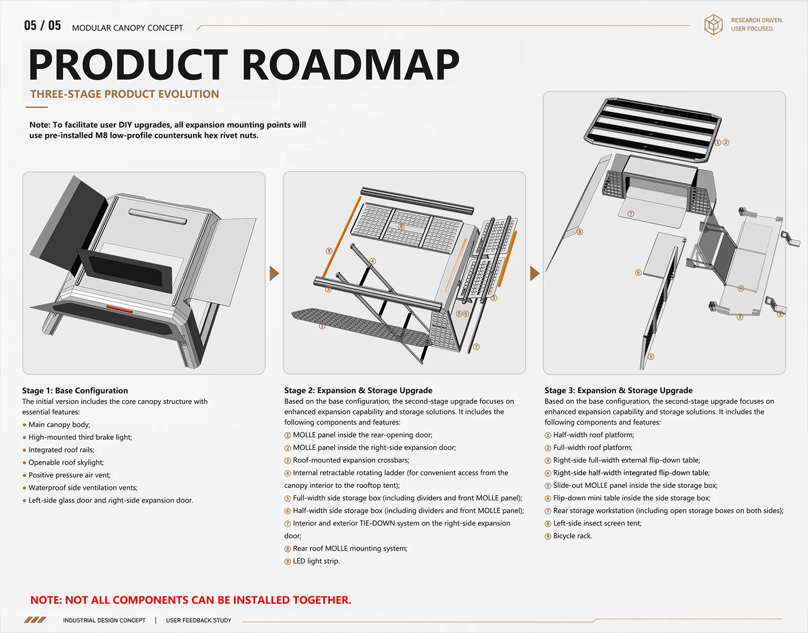

Proposed Product Roadmap
Stage 1: Base Configuration
The initial version would focus on essential protection and structure:
  • Main aluminum camper-shell body
  • High-mounted third brake light
  • Integrated roof rails
  • Openable roof skylight
  • Positive-pressure air vent
  • Water-resistant side ventilation
  • Left-side glass access door
  • Right-side expansion door
Stage 2: Expansion and Storage
The second stage would introduce:
  • MOLLE panels inside the rear door
  • MOLLE panels inside the right-side door
  • Roof expansion crossbars
  • Retractable interior ladder
  • Full-width or half-width side storage boxes
  • Interior and exterior tie-down systems
  • Rear roof MOLLE system
  • LED lighting
Stage 3: Specialized Accessories
Later options may include:
  • Half-width roof platform
  • Full-width roof platform
  • Full-width external table
  • Half-width integrated table
  • Slide-out MOLLE panel
  • Interior mini table
  • Rear storage workstation
  • Insect-screen room
  • Bicycle rack
The goal is not to make owners buy an entire catalog. It is to let each owner build the shell around the way the truck is actually used.

The pitch for a modular canopy sounds ideal on paper—buy the base shell, bolt on what you need, and reconfigure it as your lifestyle evolves. However, in the severe duty cycles of overlanding, occupational haulage, and off-road driving, complexity directly undermines reliability.
A traditional, single-piece fiberglass or fully welded aluminum canopy does one thing exceptionally well: it creates a rigid, unified structure with a single continuous weather boundary. When you break that structure down into multiple panels, bolt-on expansion doors, skylights, and removable accessory modules, you trade structural integrity and weather-tightness for versatility.
Critical Failure Points Breakdown
1. The Sealing Paradox (More Joints = More Leaks)
Water and fine dust behave like fluids under pressure when a vehicle is moving at high speeds or flexing over uneven terrain.
  • Traditional Topper: Single outer shell -> 1 primary sealing interface (bed rail) -> High sealing integrity.
  • Modular Canopy Concept: Multiple panels + Rivet Nuts + Skylight + Side Vents + Side Doors -> 15+ potential leak paths under torsional flex.
  • Thermal Cycling and Seal Degradation: High-stiffness EPDM seals and dual-tube profiles perform great when factory-new. However, truck beds experience extreme thermal expansion and contraction. Combined with constant UV exposure and trail dirt, rubber gaskets quickly stiffen, grit-contaminate, and lose memory.
  • Torsional Frame Flex: Pickup beds are engineered to twist independently of the cab to absorb road shocks. When the bed rails rack diagonally over off-road obstacles, every bolted panel seam, hinged side door, and skylight frame in a modular canopy flexes unevenly. Over time, this movement creates micro-gaps that bypass even the best dual-tube EPDM seals.
  • Rivet Nuts as Water Passages: Pre-installed M8 low-profile hex rivet nuts are convenient for mounting accessories, but every blind fastener drilled through an exterior panel introduces a potential leak point. Threads corrode, rubber sealing washers degrade under vibration, and water eventually finds a path through the threads.
2. The Dust Ingress Dilemma
While positive-pressure vents are used successfully in heavy commercial toppers and rally support vehicles, their application in a consumer modular shell presents distinct operational challenges:
The Reality of Positive Pressure: A positive-pressure vent only works if the air intake draws clean air from above the cab dust envelope. If the vent filter clogs with trail dust, silts up in rain, or gets blocked by a rooftop tent, the positive pressure collapses—and negative pressure immediately resumes drawing dust through the bed's inherent drain holes, tailgate gaps, and modular seams.
Furthermore, active or passive vents require regular maintenance, filter replacements, and manual opening/closing depending on weather—adding steps to what should be a "set-it-and-forget-it" piece of equipment.
3. Structural Dynamics & Vibrational Fatigue
Adding internal slides, flip-down tables, heavy MOLLE panels, and dynamic roof loads to a modular aluminum honeycomb structure introduces severe mechanical leverage:
  • Cantilevered Loads on Modular Joints: Mounting heavy gear (recovery tracks, axes, shovels, water cans, cookware) onto modular side doors or slide-out panels concentrates dynamic loads onto small hinge pins, latches, and bolted frame corners. Off-road chatter amplifies these forces, leading to latch fatigue, door misalignment, and persistent rattles.
  • Weight Creep: The pitch highlights "lightweight construction," but modularity inherently adds net weight. Standardizing interfaces requires double-wall support extrusions, heavy-duty hinges, secondary mounting brackets, latches, and reinforcement plates. By the time you install the side storage boxes, slide-out panels, interior ladder, and roof rails, the overall payload penalty often exceeds that of a heavier, single-piece shell.
4. Usability and Ergonomic Friction in the Field
  • Openable Roof Skylight:
    • Promise: Natural lighting, star-gazing, and internal ventilation.
    • Reality: High risk of leakage; collects tree branch scrapes; instantly rendered unusable if a Rooftop Tent (RTT) or gear platform is installed overhead.
  • Slide-Out MOLLE Panels:
    • Promise: Rapid exterior access to tools and recovery gear.
    • Reality: Consumes precious interior cargo volume with heavy slide tracks; slide mechanisms bind quickly when contaminated with sand or grit.
  • Flip-Down Work Tables:
    • Promise: Convenient camp kitchen and worksite bench.
    • Reality: Full-width tables block access to the lower bed area when deployed; hinges collect mud and grease; latches rattle endlessly on corrugated dirt roads.
  • Retractable Interior Ladder:
    • Promise: Easy internal access to a rooftop tent.
    • Reality: Takes up critical head clearance inside the shell; creates a large cold-bridge and water-leak path through the roof.
Conclusion
While a modular camper shell solves the logistics of shipping and customized purchasing, it shifts the engineering burden onto long-term seal maintenance and mechanical hardware upkeep.
For users who demand absolute weather isolation, long-term durability, and silent operation over thousands of miles of rough washboard roads, a simpler, fully welded, single-structure shell with minimal body cutouts almost always outperforms a multi-joint modular platform.
