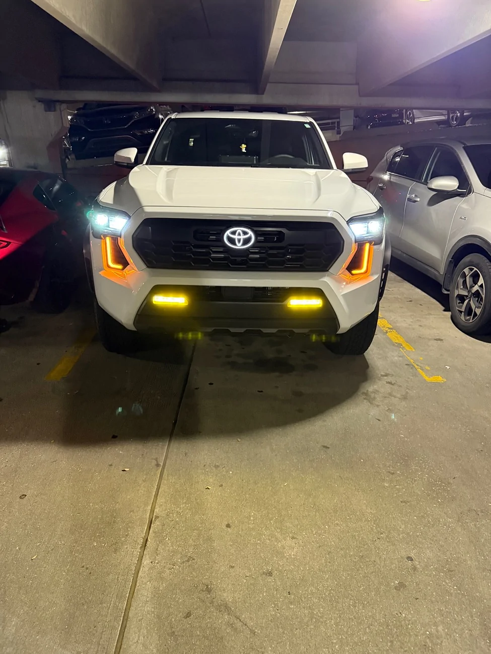

underground_weaz
Aug 13, 2025
58
Georgia
Definitely unfortunate. Update though: It seems like for the trd off road plugging it into the turn signal bulb works..
Can you show a picture of how you connected them? I tried 3-4 different plugs and none of them matched the provided harness.
