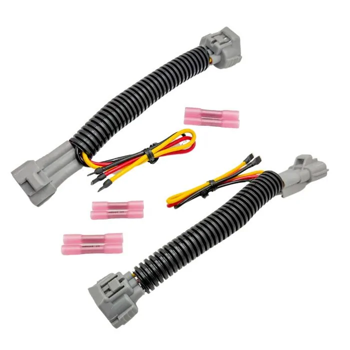

Why not just wire it to the hot wire on the 3 pin headlamp harness? The ground and the signal power is there too. Then all your DRL's will work with the other OEM DRL lighting? That is what I did, and it works well with a bunch of DRL lighting I added.

That’s valid
I actually have the skills to make such harnesses and even much more complicated ones. Many years ago on one of my first jobs, I worked on Grumman F-14 electronics, wiring components, cables, and haness. I helped build many thousands of those awesome jet fighter components back in that day. All crimps and solder joints and even the number of twists per inch were examined by inspectors with magnification, and even had high voltage testing to ensure they were built to MIL specs. A component failure was not an option as it could jeopardise many lives and many millions of dollars. Every process and component had to comply with MIL specs. We had the MIL Specs books close by as reference that we used every day. Some of these huge harnesses had dozens of arms and some connectors had hundreds of all different size wires including some coax. They could be very short, or even 20 feet long. A single complex harness could take an expert many weeks to manufacture. Unfortunately many of the fighter jets we produced were sold to Iran. It was an enjoyable experience of which I learned many things.
Now I am retired, and I still built simple cables and modifications, but Aspire had a product that was quality built and was able to save me time and effort so I had no problem purchasing it. Just a small piece of all that I have invested in my 2024 Tacoma TRD Pro.
