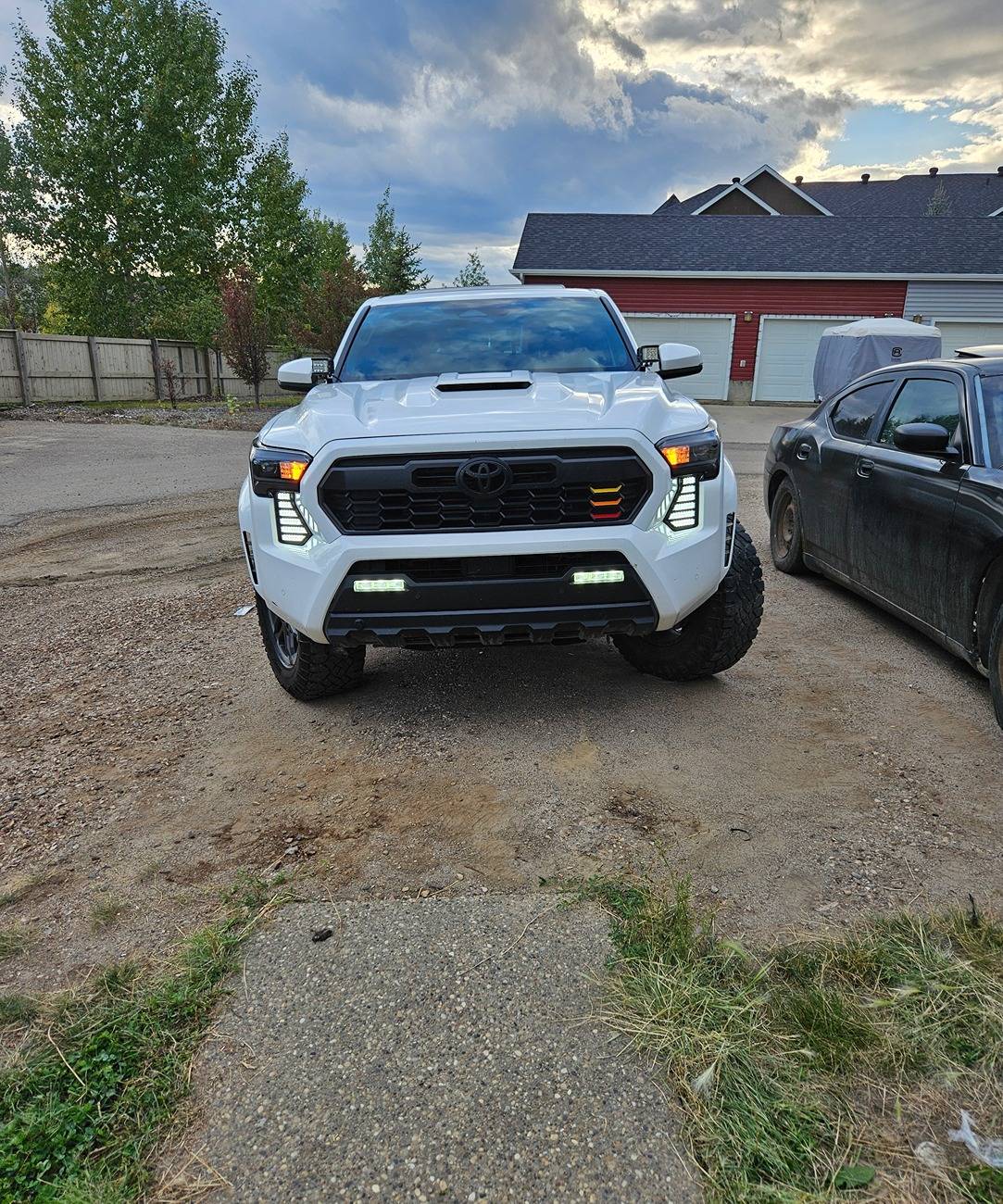

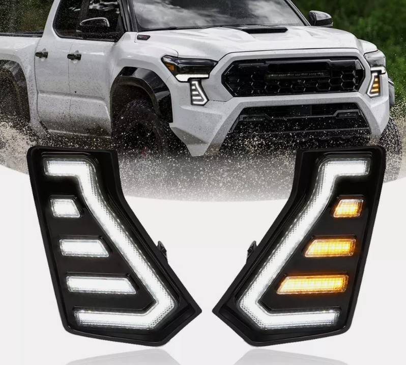

I would suggest not buying the Tacoma Lifestyle kit. It’s overpriced for what it is. They all function the same but just behind a different name.
These are my cheap amazon versions that I installed myself. I tinted them myself also. The white LED bars were just too much. Needed a more oem look.
They look and function just like the Toyota Lifestyle version. In all, probably about $80-90 spent including the tint.
How did you tint these? I received mine yesterday and I agree the white LEDs are too much.
