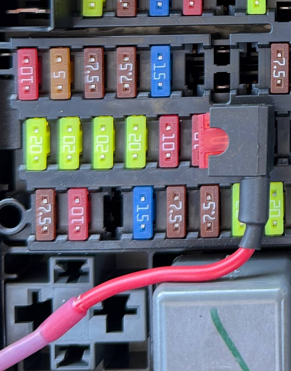

My lights come on occasionally and then turn off, I have a hybrid, no big deal. My lights are wired on a jumper fuse tap (see photo)
Thanks for the update. Curious, which fuse did you tap into?
