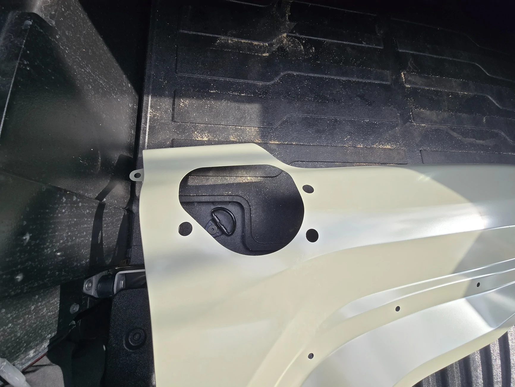

DUDE! After so many months of waiting someone finally figured it out. You're the man.
So let's say I wanted to install it onto my TRD OR using the preexisting fender, do you think it would be possible to cut out the hose hole and screw holes?
Also, I bought a Banks RAM Air intake not ever really thinking I would be considering the snorkel. But here I am. The Banks RAM Air intake does have that opening on the side that is capped currently; would it make sense to have the RAM air side open and the side towards the snorkel open too?
Thanks for all the research!

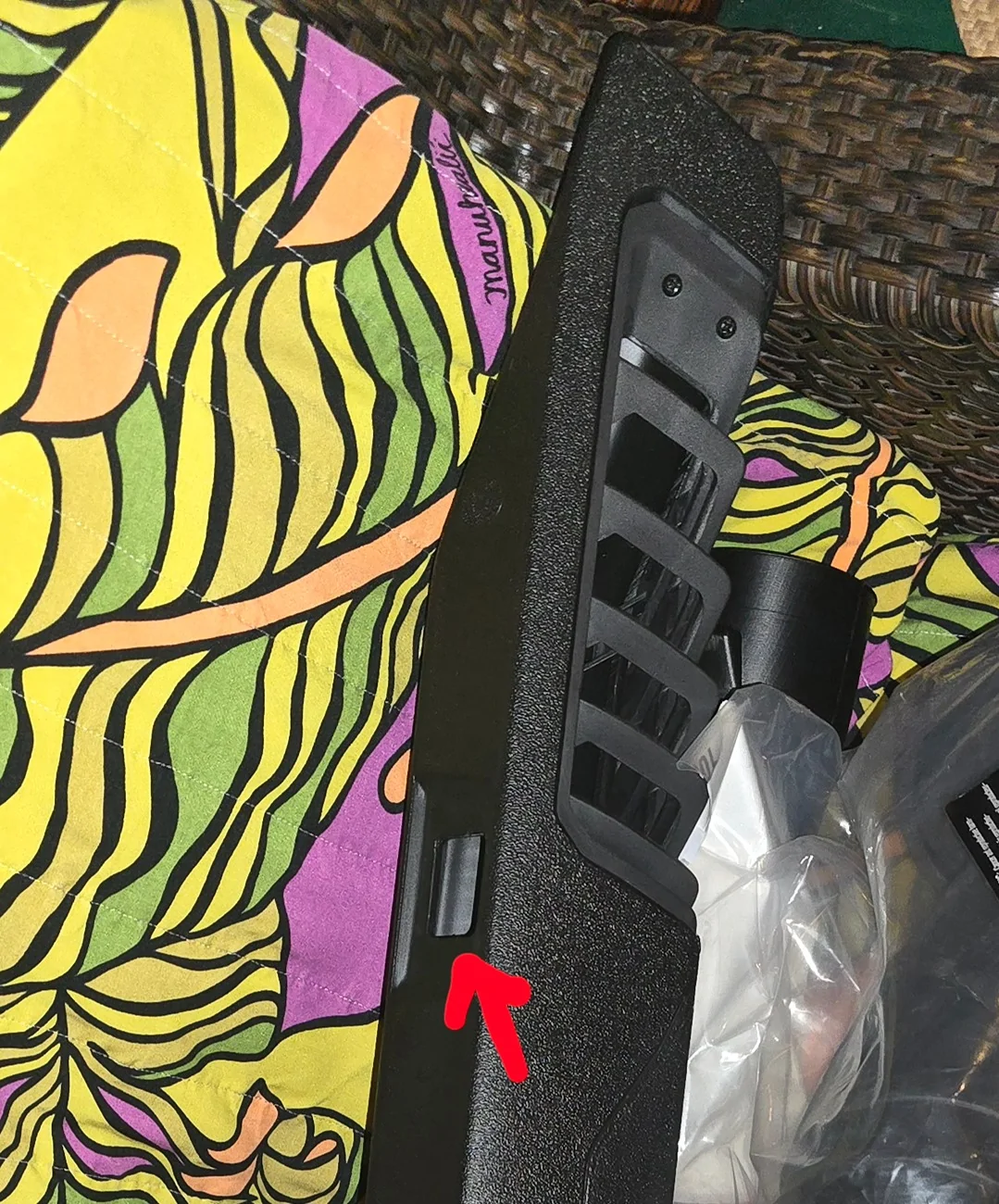

You could cut the original fender. I don't have any measurements, and the only picture of the trailhunter fender cutouts i have is this:
2024 Tacoma How Trailhunter high mount air intake (snorkel) mounts to A-pillar 1000063273
You could probably hold the outer snorkel duct up to the fender and trace it to cut. The bottom edge of the outer duct runs in line with the bottom edge of your A-pillar above the top edge of the door. Basically - gotta line it all up and make sure your door can open still. The easier but more expensive way is to just buy the TH fender and paint it (part number above in this thread somewhere).
Banks actually specifically says that their intake is compatible with the snorkel and i agree with them. Their cutout looks closest to the pro/TH intake and i am sure it will fit in the fender inlet hose snug.
Depends on what you want, but like me for example, I run the front grill open (stock air scoop into pro intake) and the snorkel open at the same time. This makes it so the snorkel only really becomes active on harder acceleration and when in boost. I like it better this way but that is my preference. Wanted as much air as possible to the intake.
If you plug the front grille inlet, you will hear the snorkel all the time no matter what just like the TH and will technically lose some horsepower (minor, like 3 HP) according to toyota specs.
