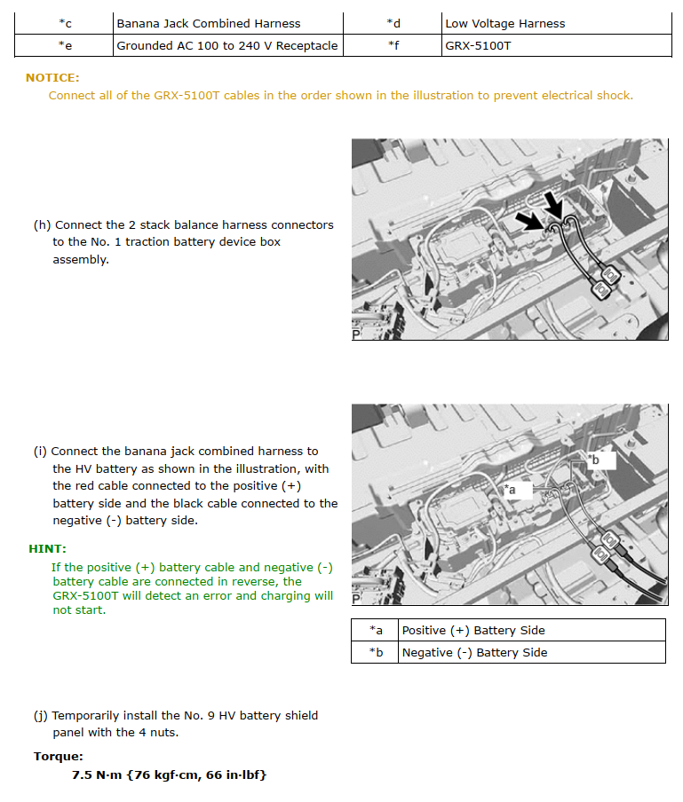

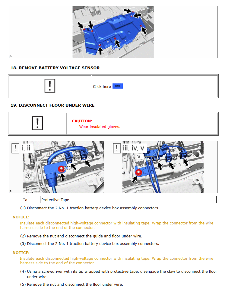

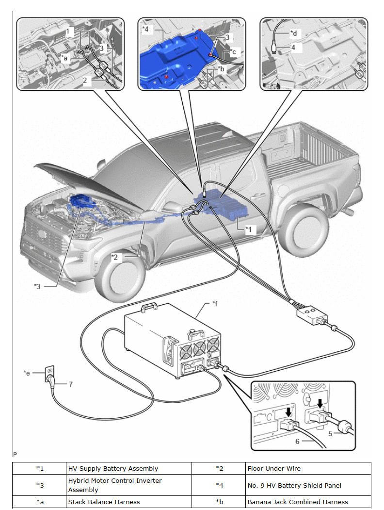

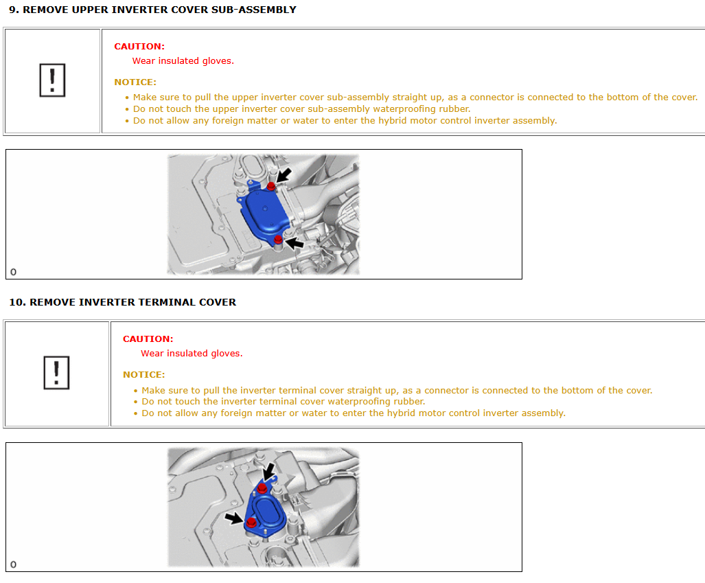

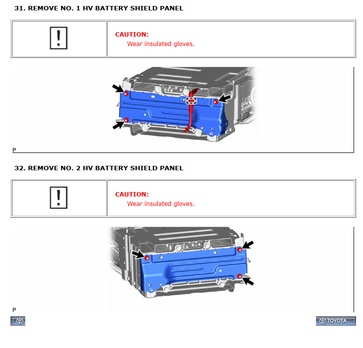

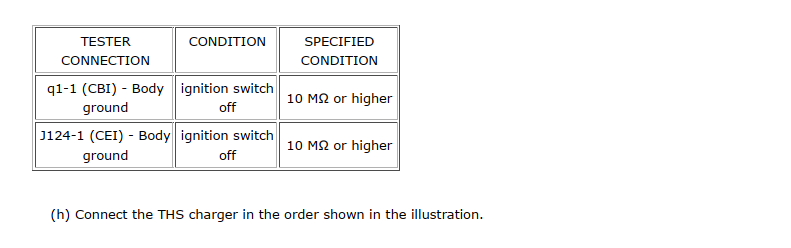

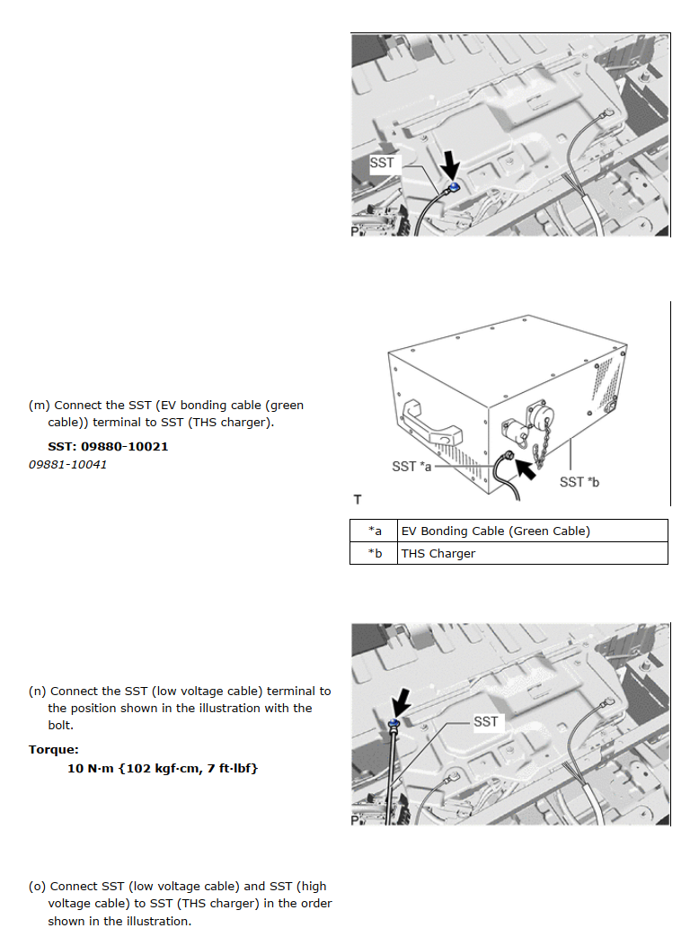

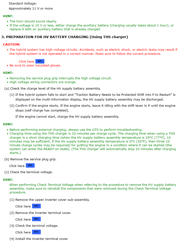

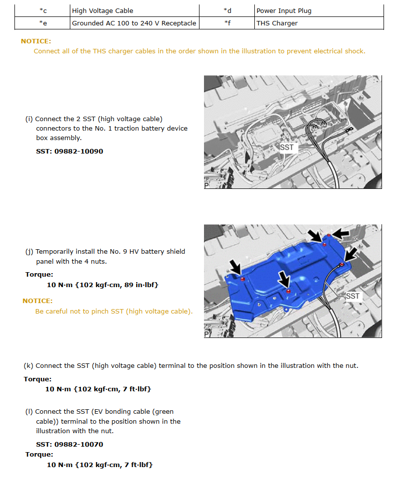

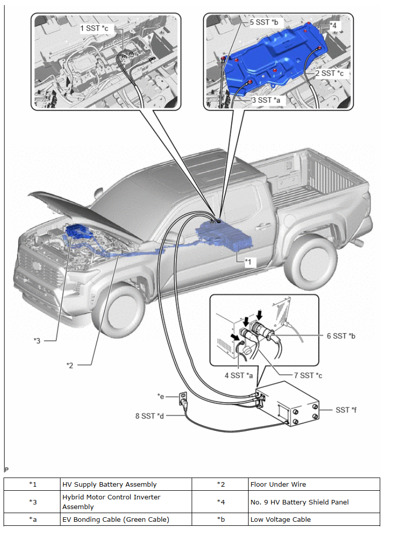

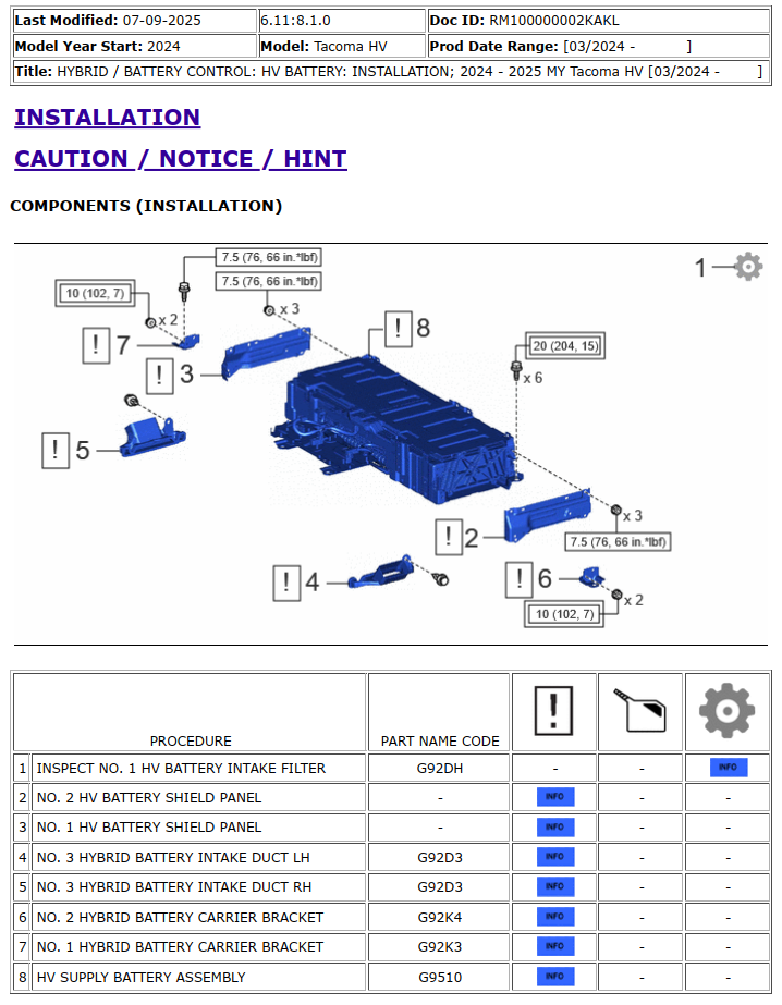

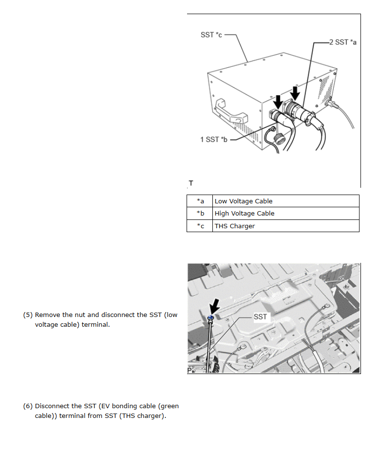

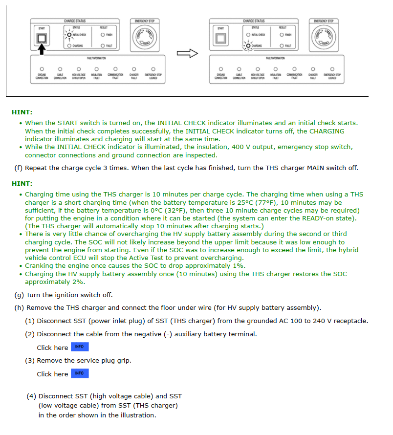

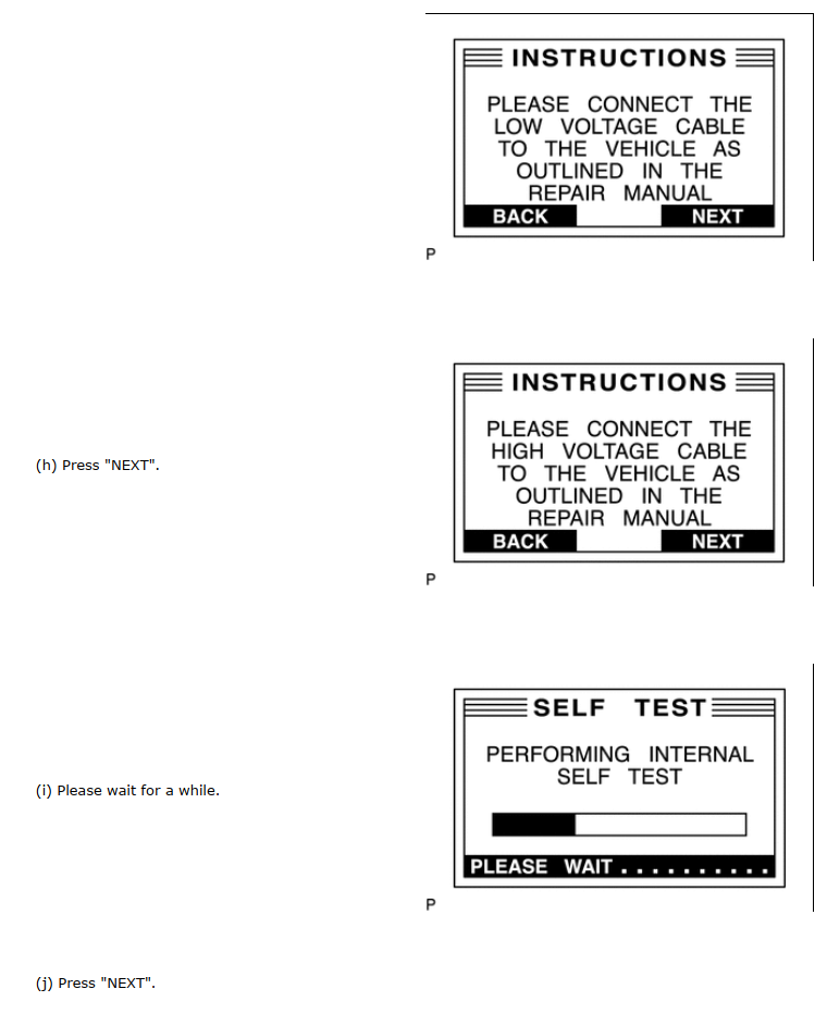

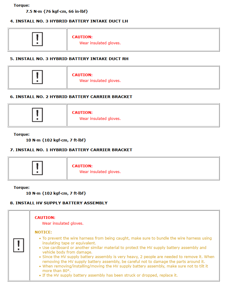

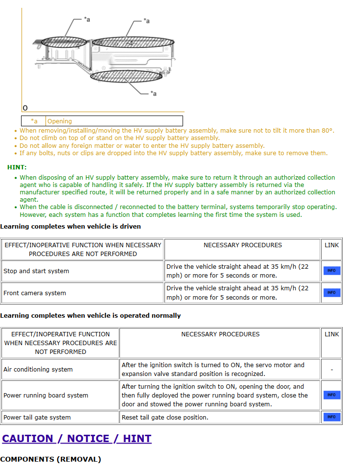

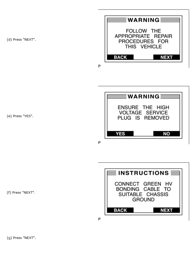

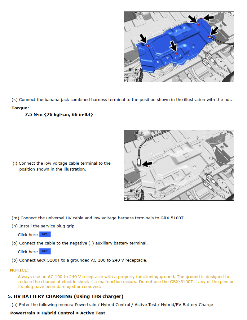

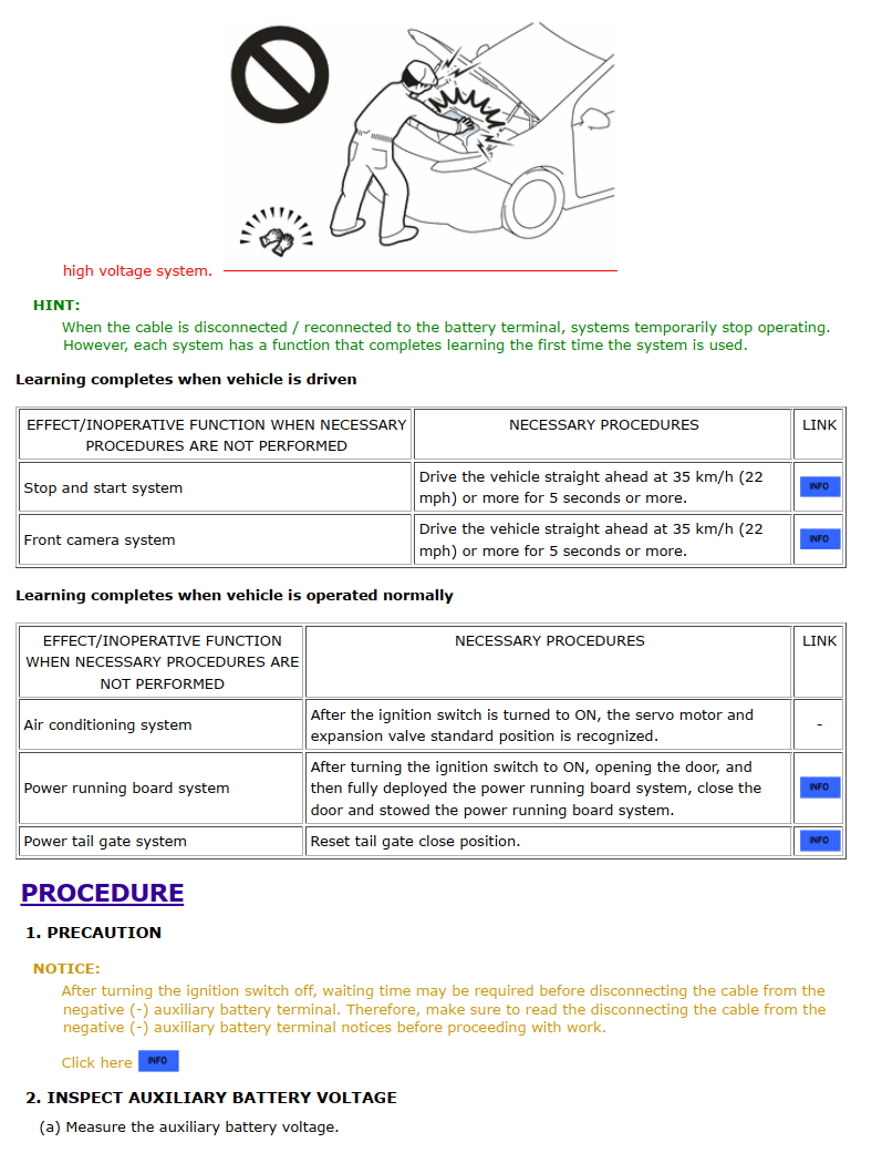

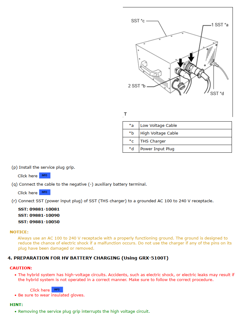

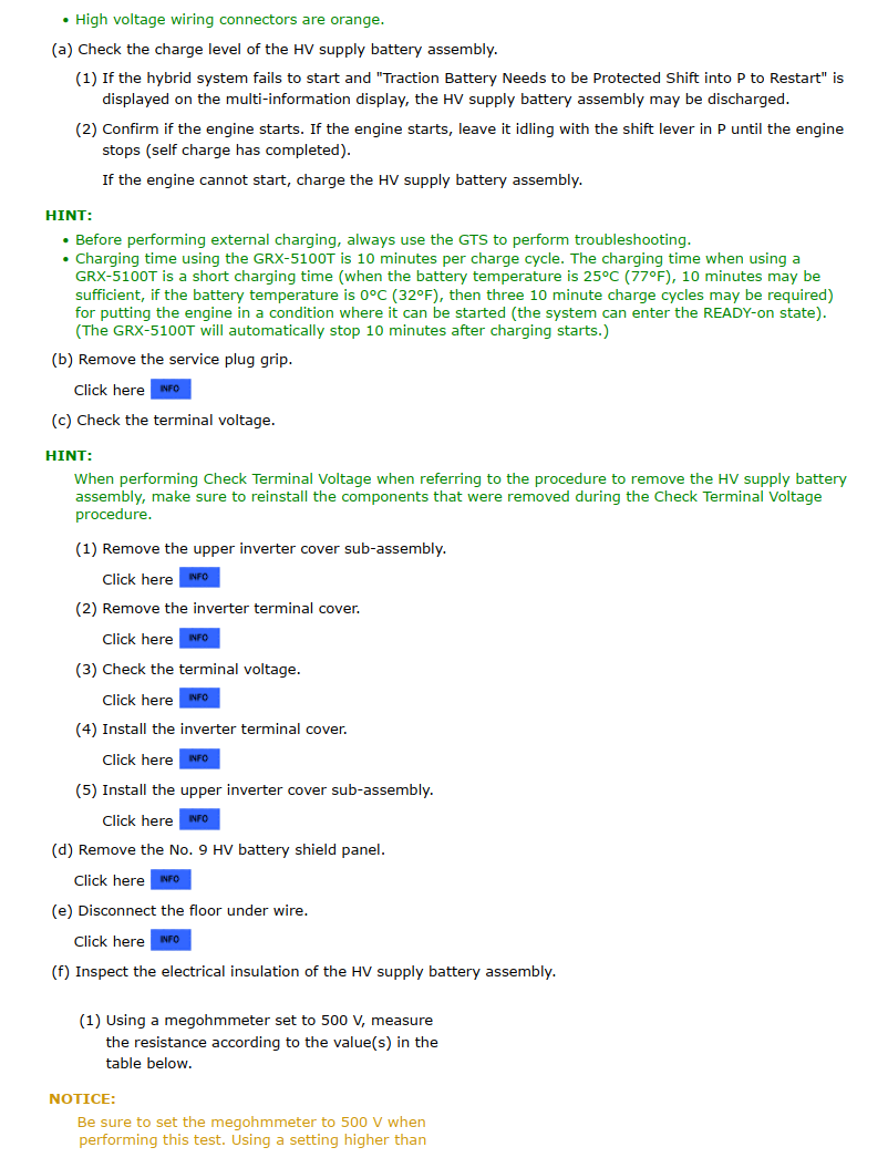

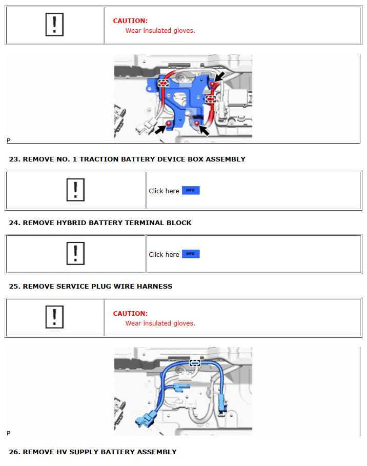

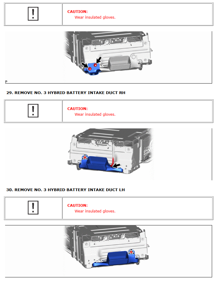

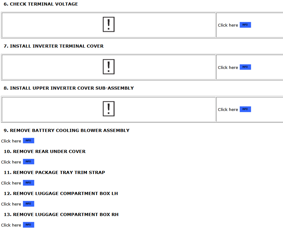

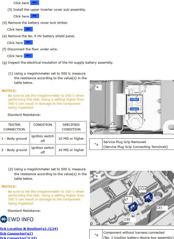

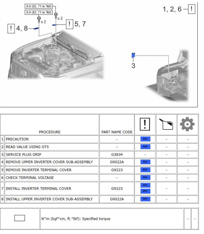

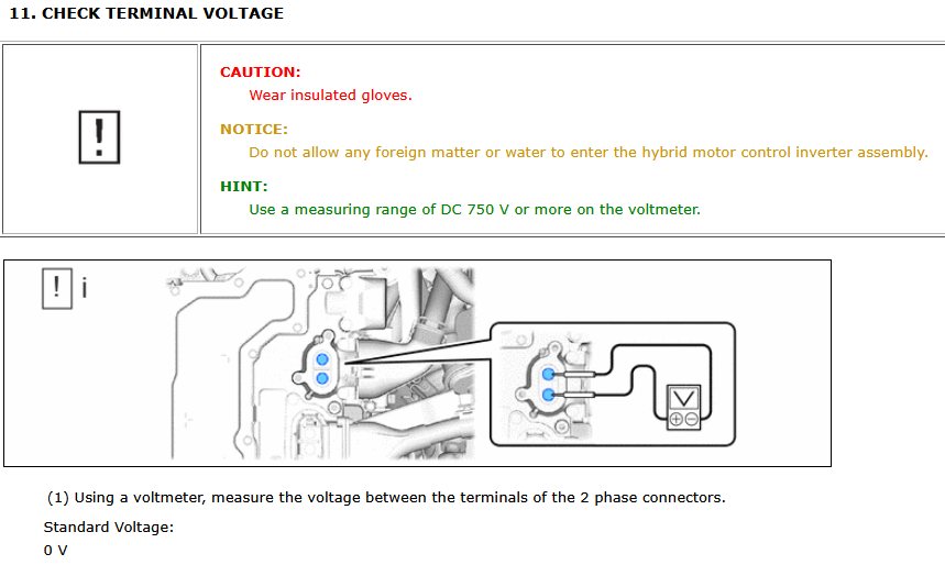

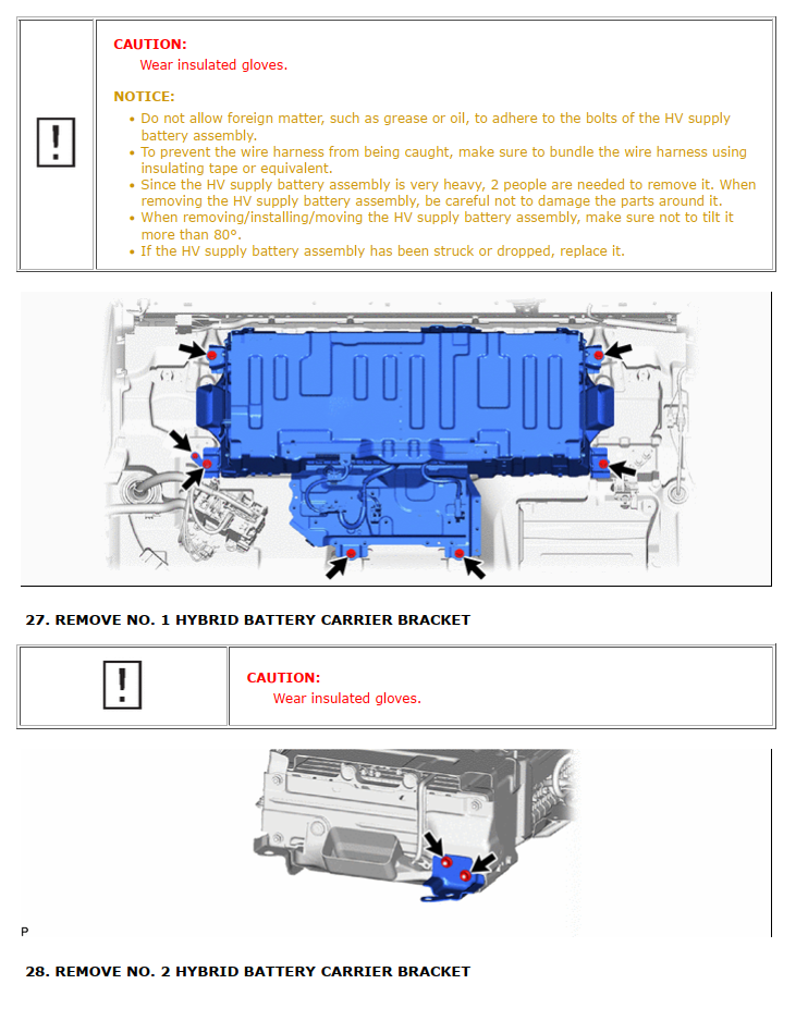

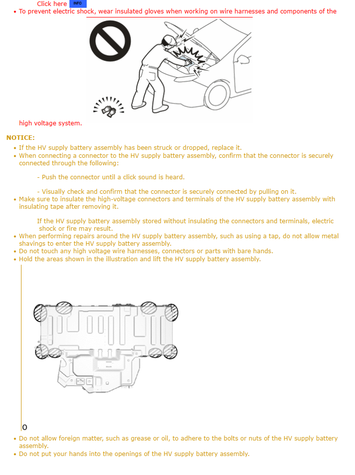

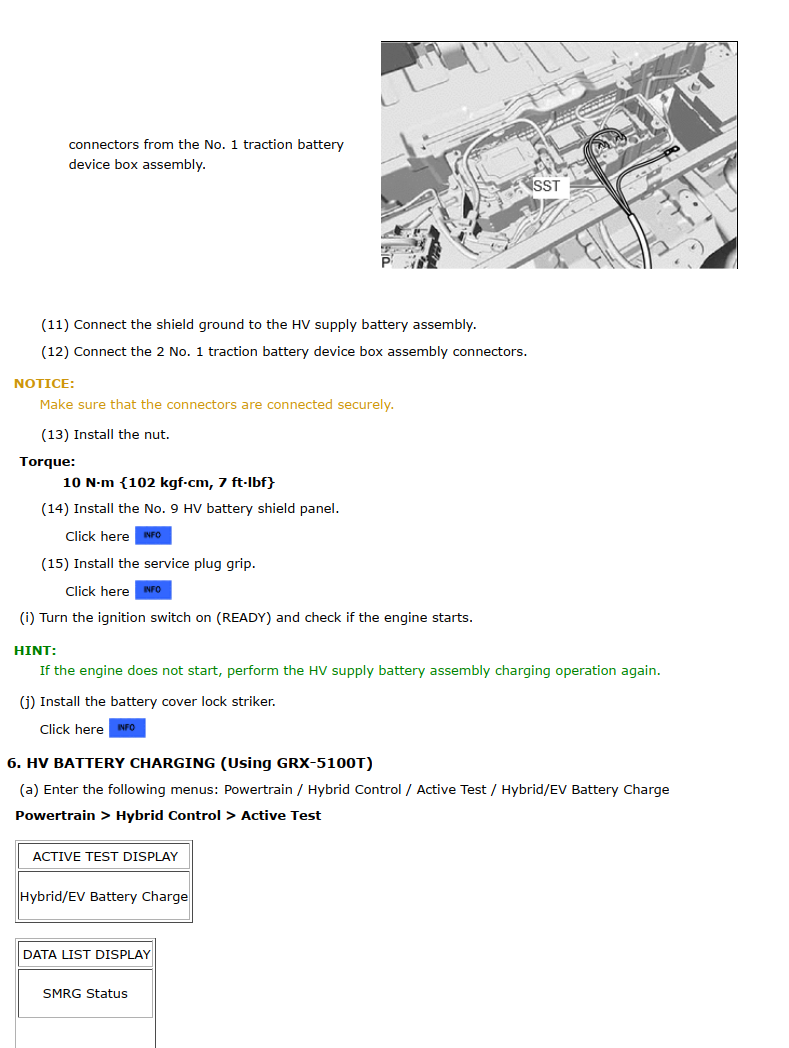

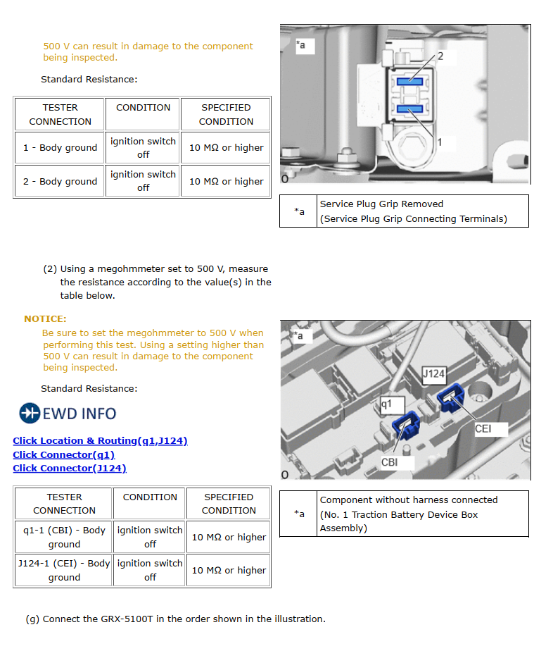

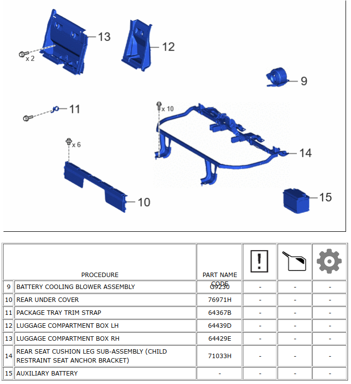

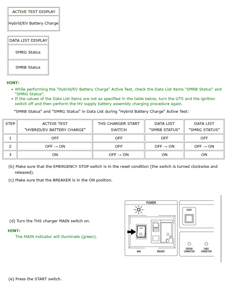

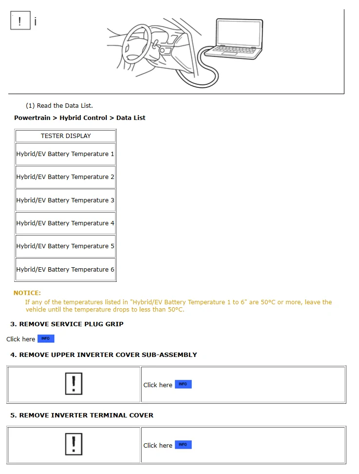

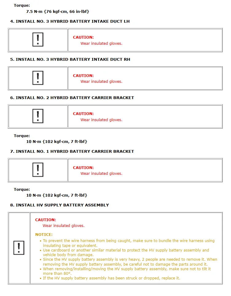

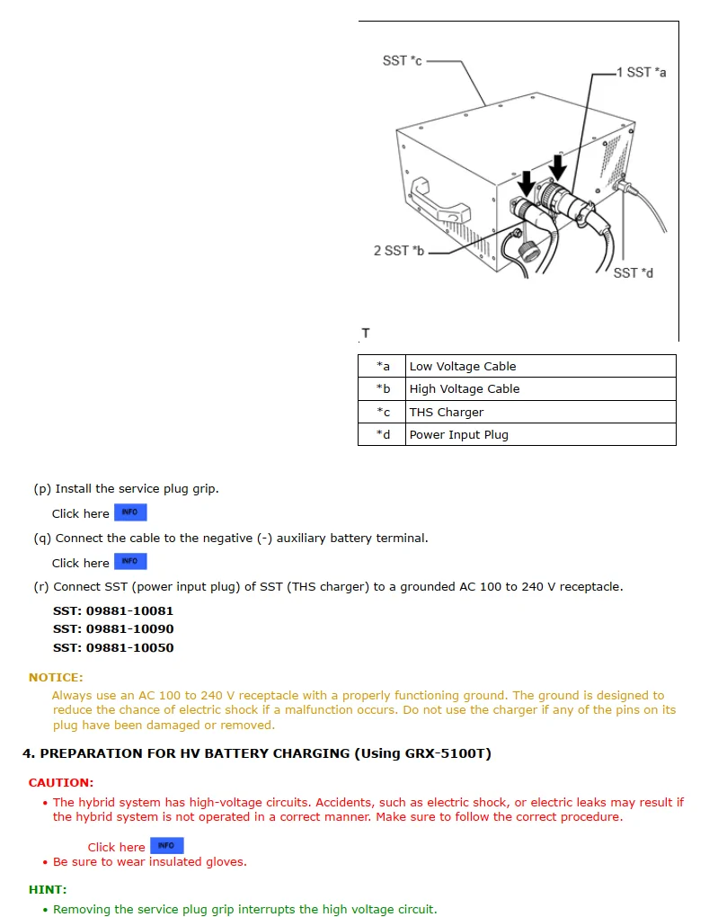

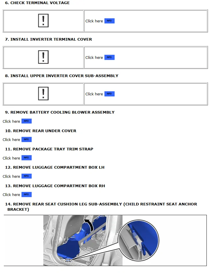

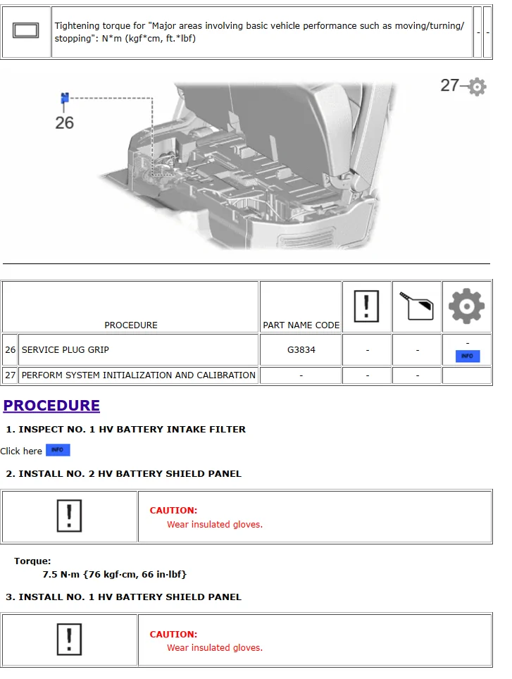

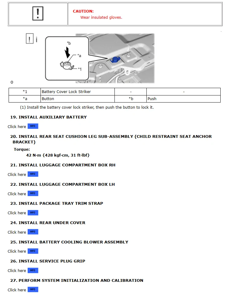

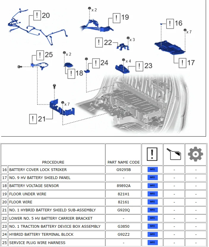

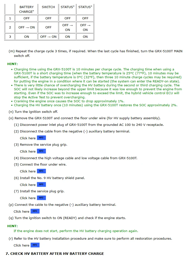

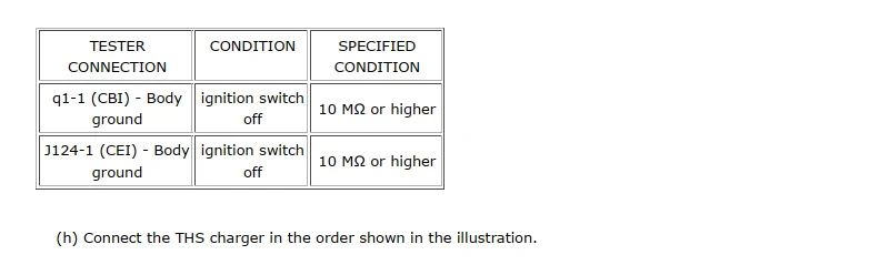

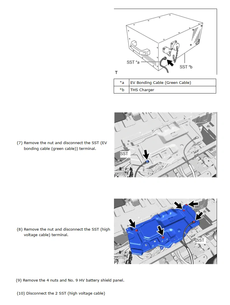

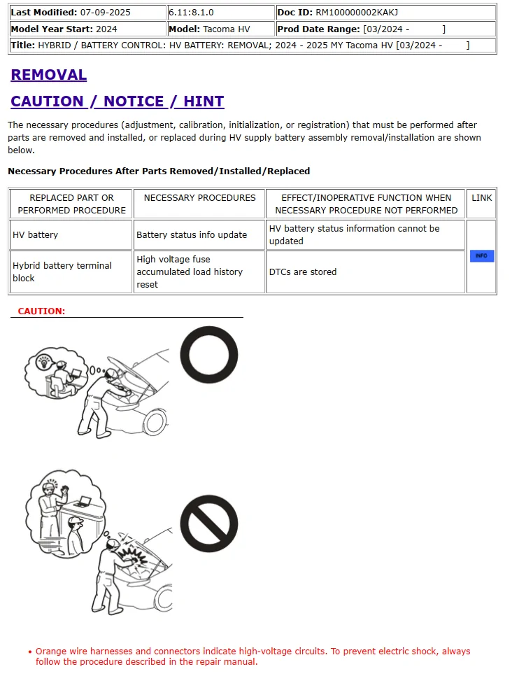

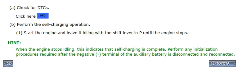

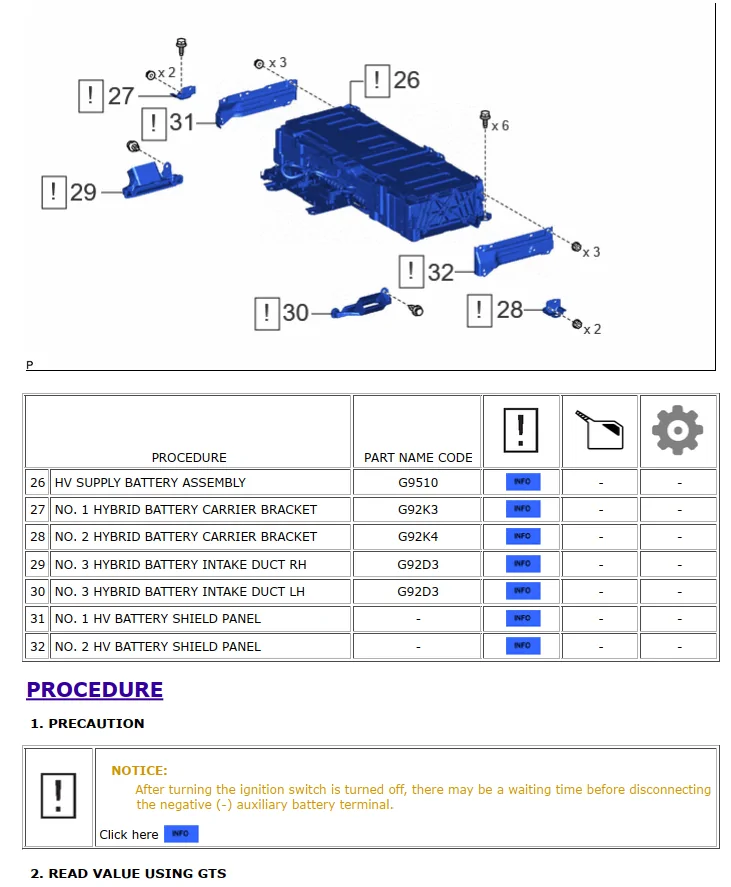

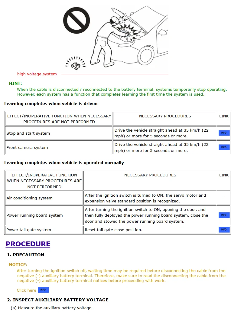

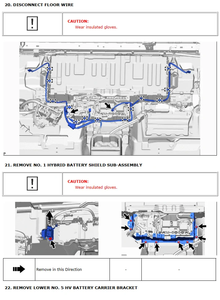

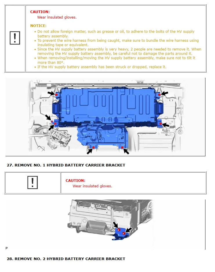

I thought I would share this for people curious of what it takes to replace the battery years down the road.
BATTERY REMOVAL / REPLACEMENT

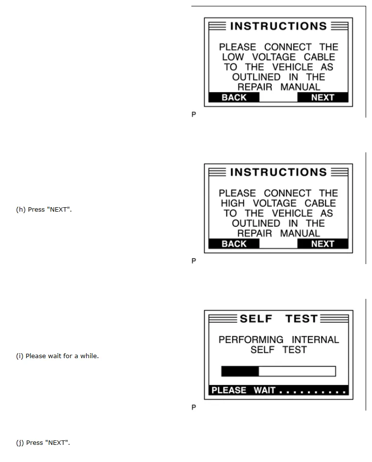

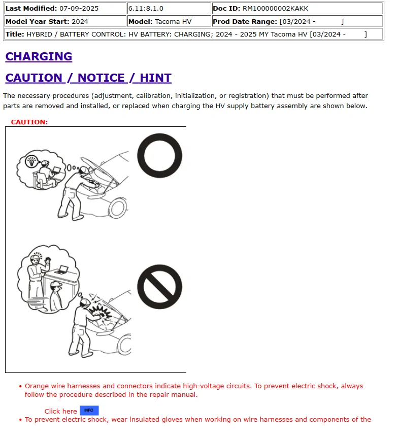

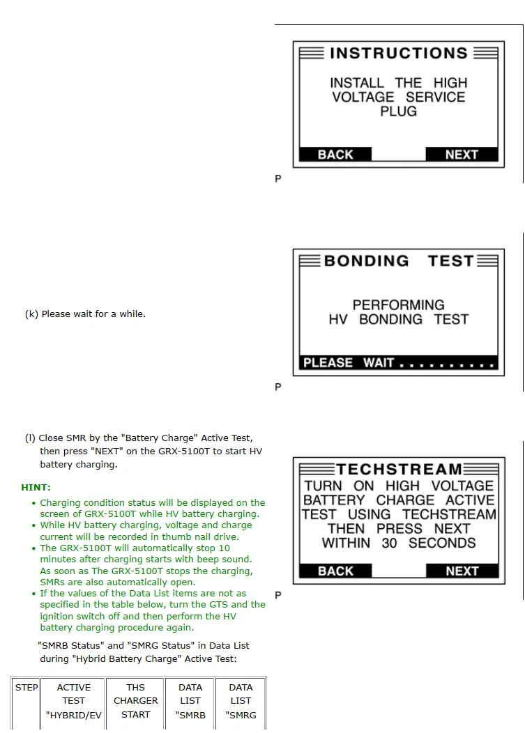

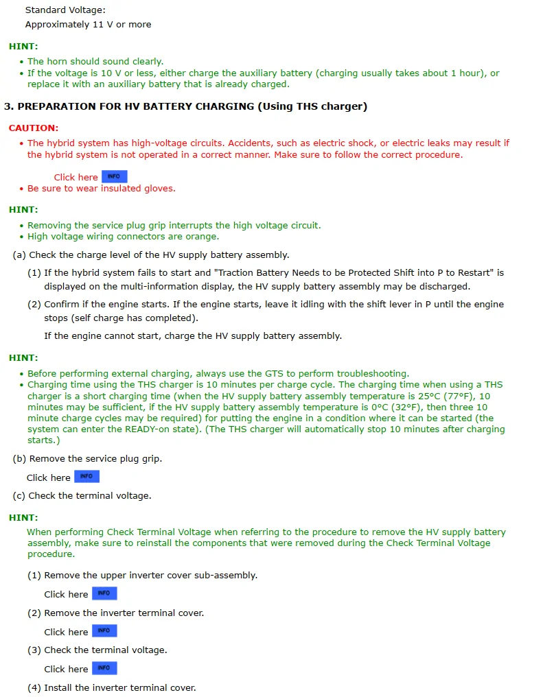

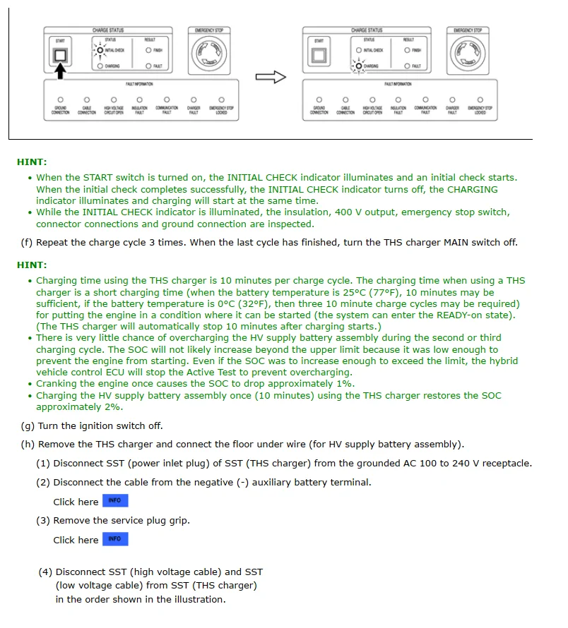

NEW BATTERY CHARGING
