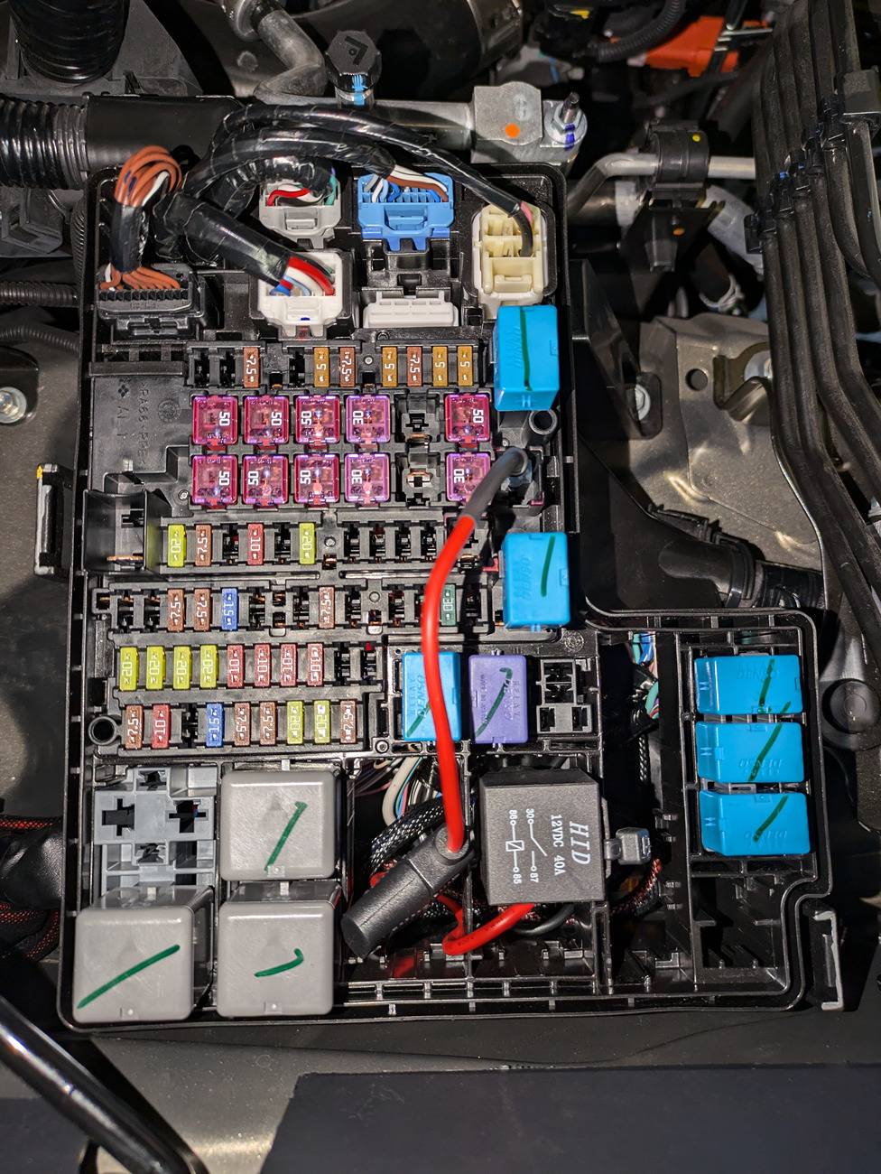

Unused spades in the engine bay fuse boxes are 12v hot. Used an insulated 14g-16g female spade and used that as my hot tap. ground tap was a factory grounding point on the engine sidewall immediately behind the brake master. Photo is of the driver side fuse & relay panel.
Also puts you in a clean line for going through the "aux cable nipple" on the firewall gasket to come into the cabin immediately behind the driver left dash button panel.

What # position fuse and what connector did you use? Thanks!
connector is:
1/4 in. Fully Insulated Wire Disconnects in Blue
(15pk can be gotten at Home Depot or Lowes for a touch over $5)
Location/position used is as pictured, that photo was fully wired and connected.
Relay and in-line fuse came with the Diode Dynamics wiring harness.
