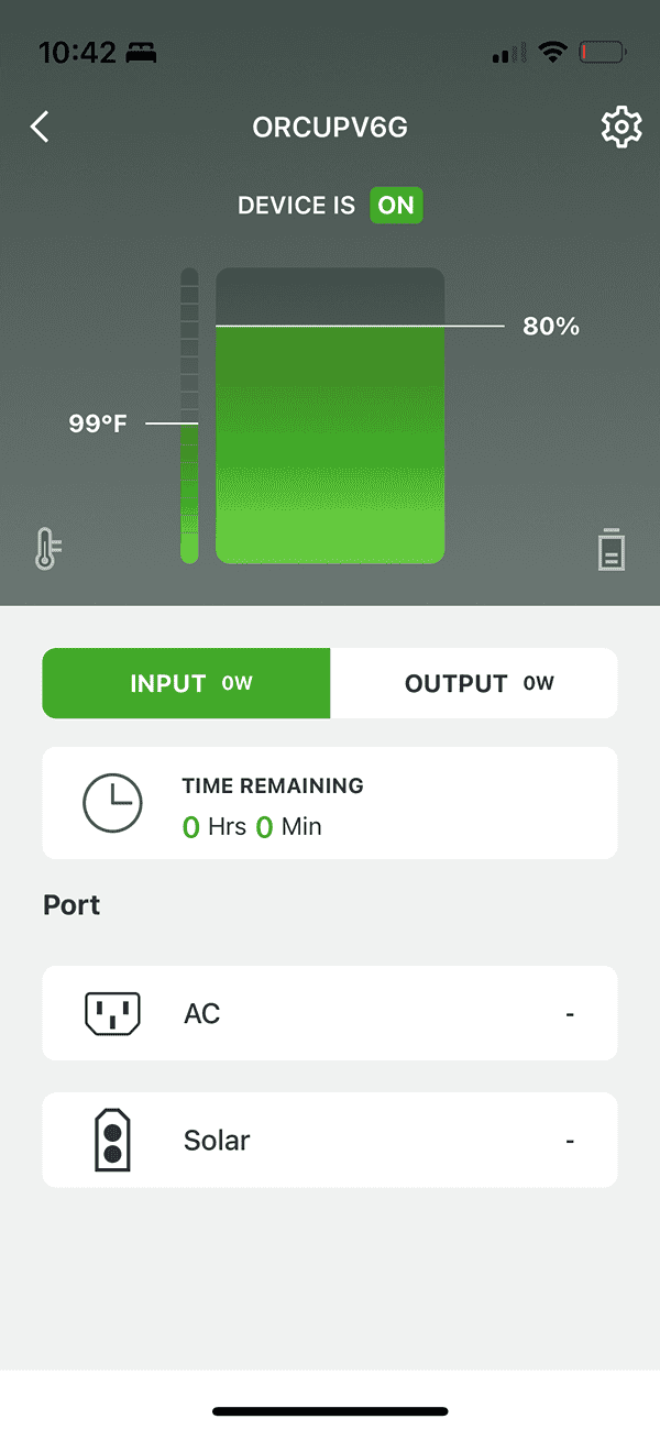

Great idea. Yea a power station with a live readout on wattage really does help. Soon enough I’ll be about to do that w/my power station. Sends me a readout on my phone, can sit shotgun and see what the outlet powers in real-time / in drive / park / neutral / coasting / engine off
