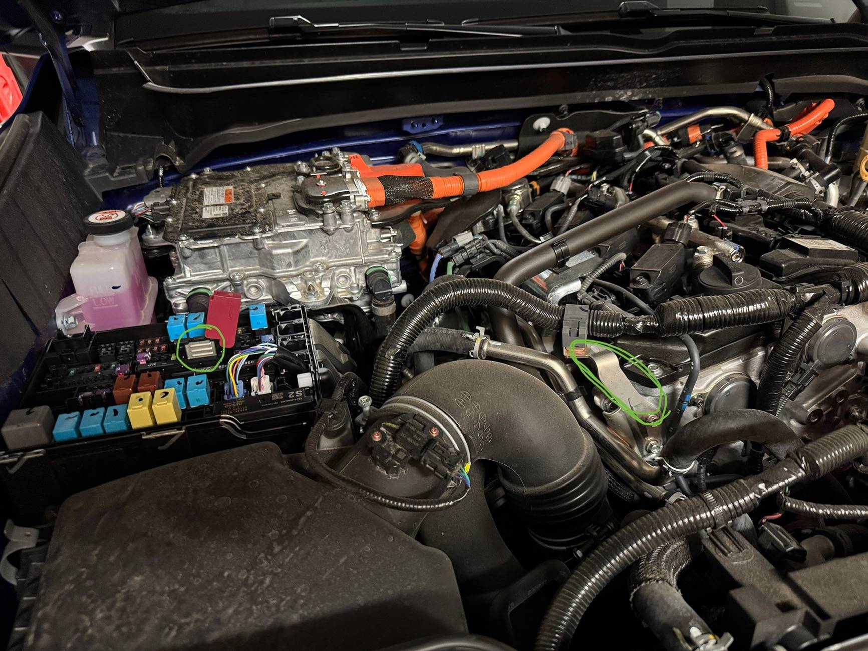

Anybody think its a bad idea to run an air compressor off of the relay fuse box thats for jumping the car? The 12v under the rear seat is pretty inaccessible. The cap that flips up is used to jump the car and presumably connects directly to the 12v battery.
So looking for a good place to run the compressor.

Where would the compressor be located?
i have an external compressor that connects with clips to the battery terminals. I just wanna run that for now instead of mounting a compressor in the engine bay

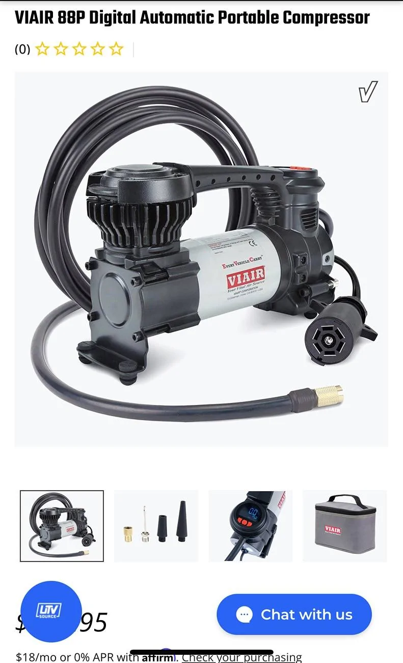

I went a different approach based on the new Viair 88p with 7pin connection.
I snipped off the clips and wired it to a 7pin trailer plug. Easy high powered plug in the back of the truck.

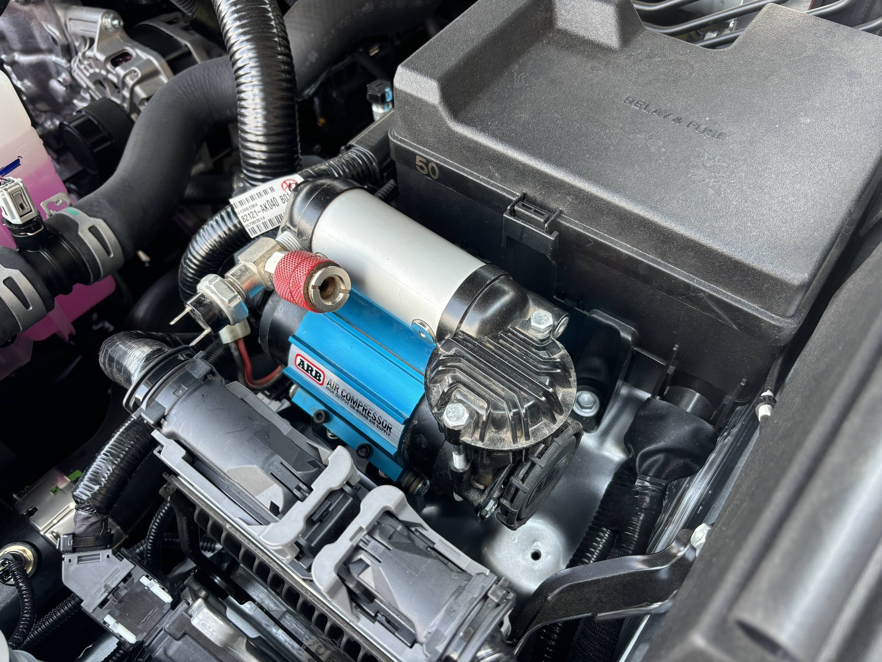

I stuck a single ARB in mine. I've got a non-hybrid, so the electrical was simple. Designing the 3D printed mount was a multi-prototype project.

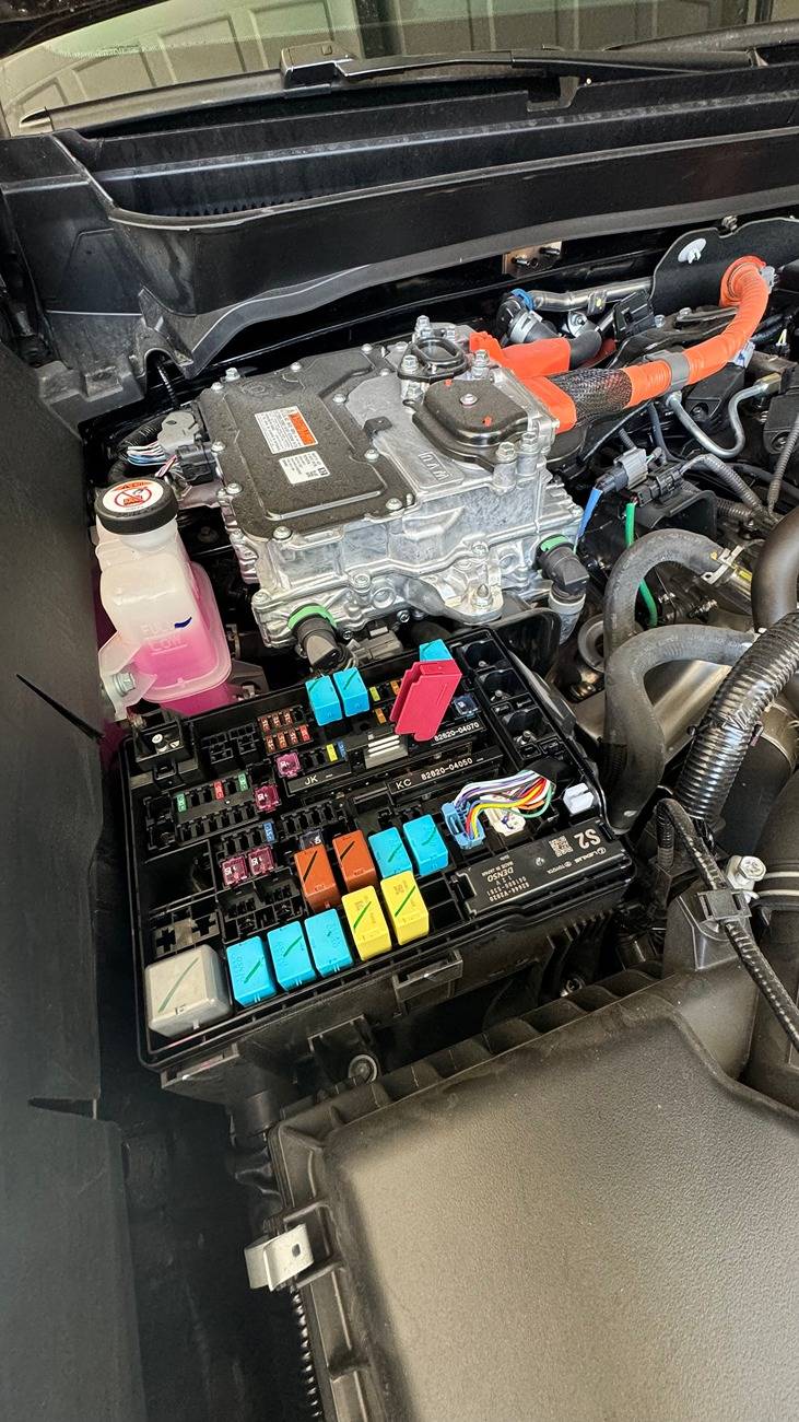

A variation on the original question though, in the hybrid situation, if you had a portable air compressor with clips, would you hook the positive to the piece under the red cap in the fuse relay box? And hook the negative clip to the piece of metal in the engine like you would if you were jumping it? The air compressor would work fine? It’s obvious in a non-hybrid situation but this is obviously set up differently.
I’m not versed in amps etc and don’t want to mess anything up. If you don’t have onboard air, there are no obvious alternatives. I was on the trail last weekend with friends and hadn’t realized it was so different until I went to air up fortunately I used their batteries
