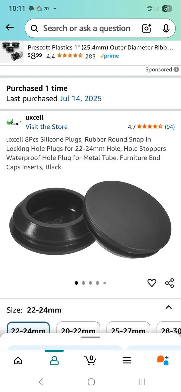

Ok Ive read alot on this and while an easy fix, stupid design. However to save you time and miney the hole on the LCA is not 3/4 its between 22 and 23mm... these fit perfect no glue no tape and locked in.
2024 Tacoma LCA noise/air dam removal fix 1000002099

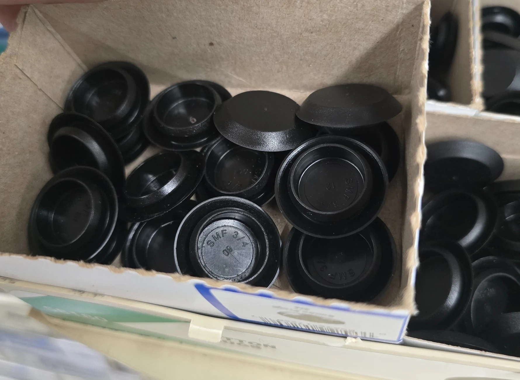

2024 Tacoma LCA noise/air dam removal fix 20250727_133112
I found them at my local Ace hardware for 10 cents each just down the street
