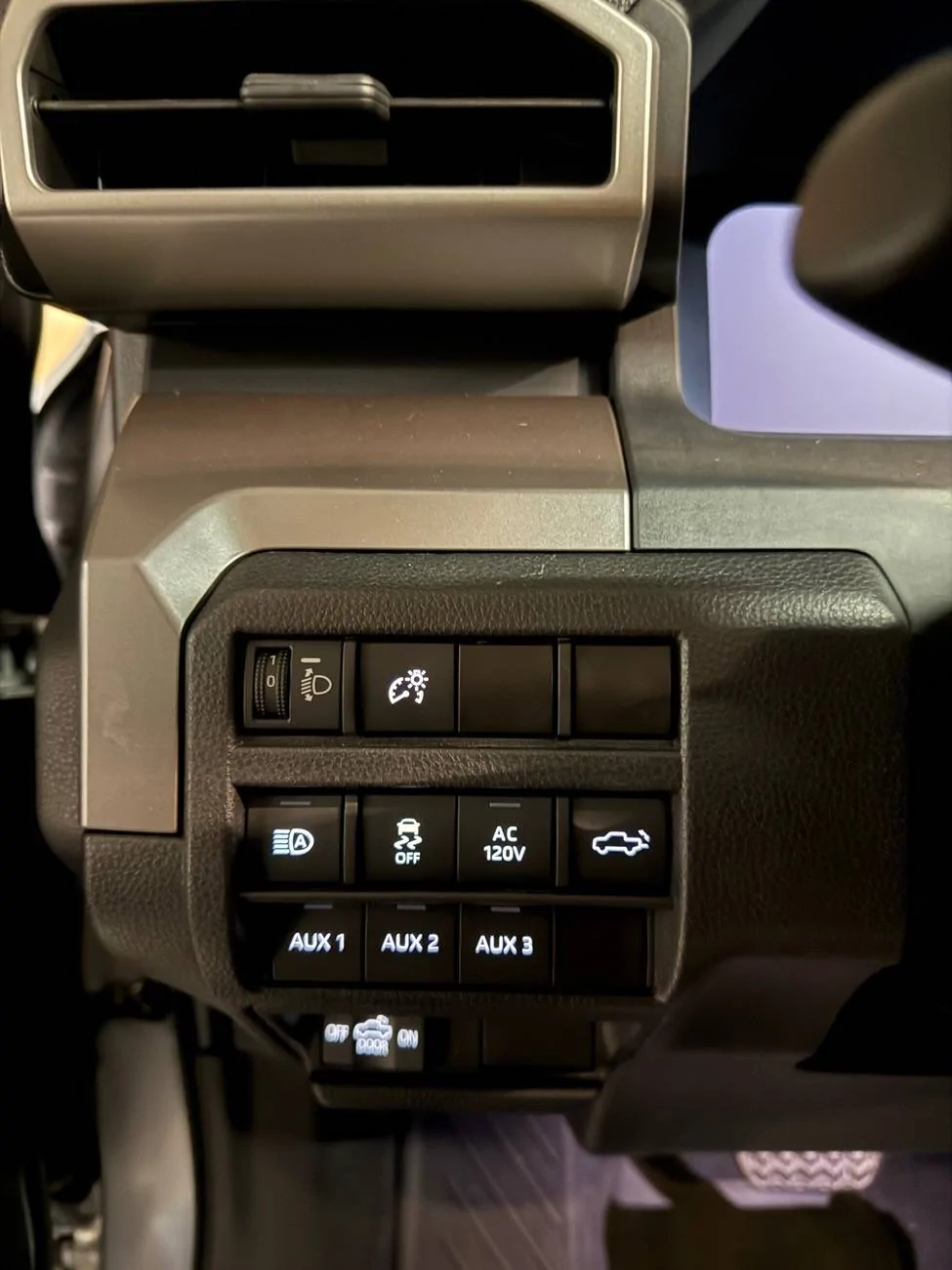

Hi all,
Few questions:
1. Does your manual adjustment dial for your headlights light up?
2. Does anyone know which fuse powers the switch and/or mechanism by which the headlights adjust?
My truck was in an accident which resulted in a headlight replacement and now the dial doesn’t do anything when used and the headlights don’t adjust. Before I take it back to the shop, I was wondering if there was a fuse I could check that could be the culprit.

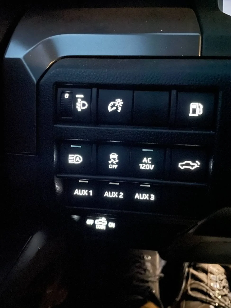

I think the headlights don't move, it's somehow done digitally inside the light. (I think.)
Could they have installed aftermarket lights?
I don't recall the scroll lighting up. Perhaps.

Based on this yt video it does look like it should be illuminated.
Checked the headlamp and it is OEM and everything looks plugged in. Mystery continues... Headlights, DRL's and blinkers all work. It's just the adjustment dial that isn't illuminating or functioning.

UPDATE:
The shop forgot to plug in the connector behind the switch/in the dash. I didn't check it because I didn't think they would disconnect it to replace the headlight but apparently it is part of the repair procedure. All fixed!
