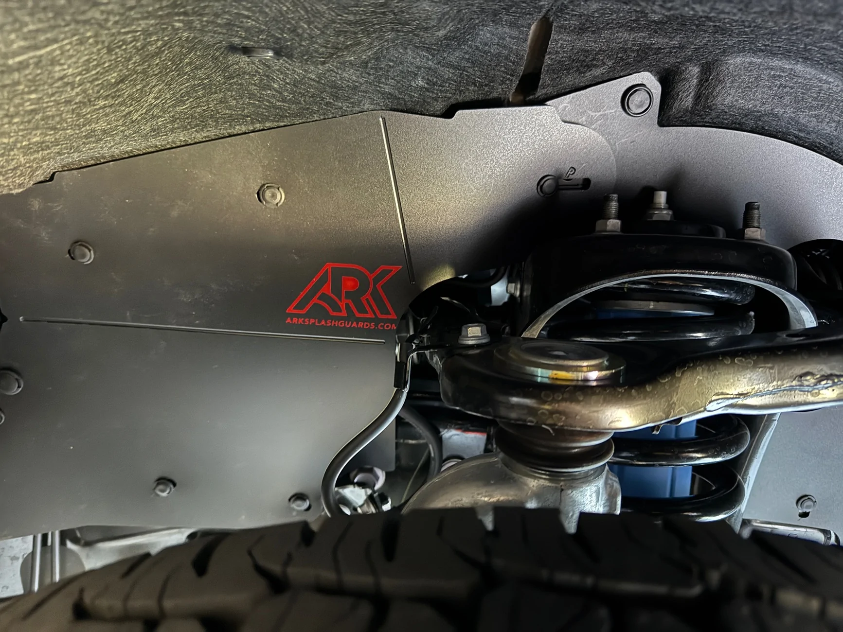

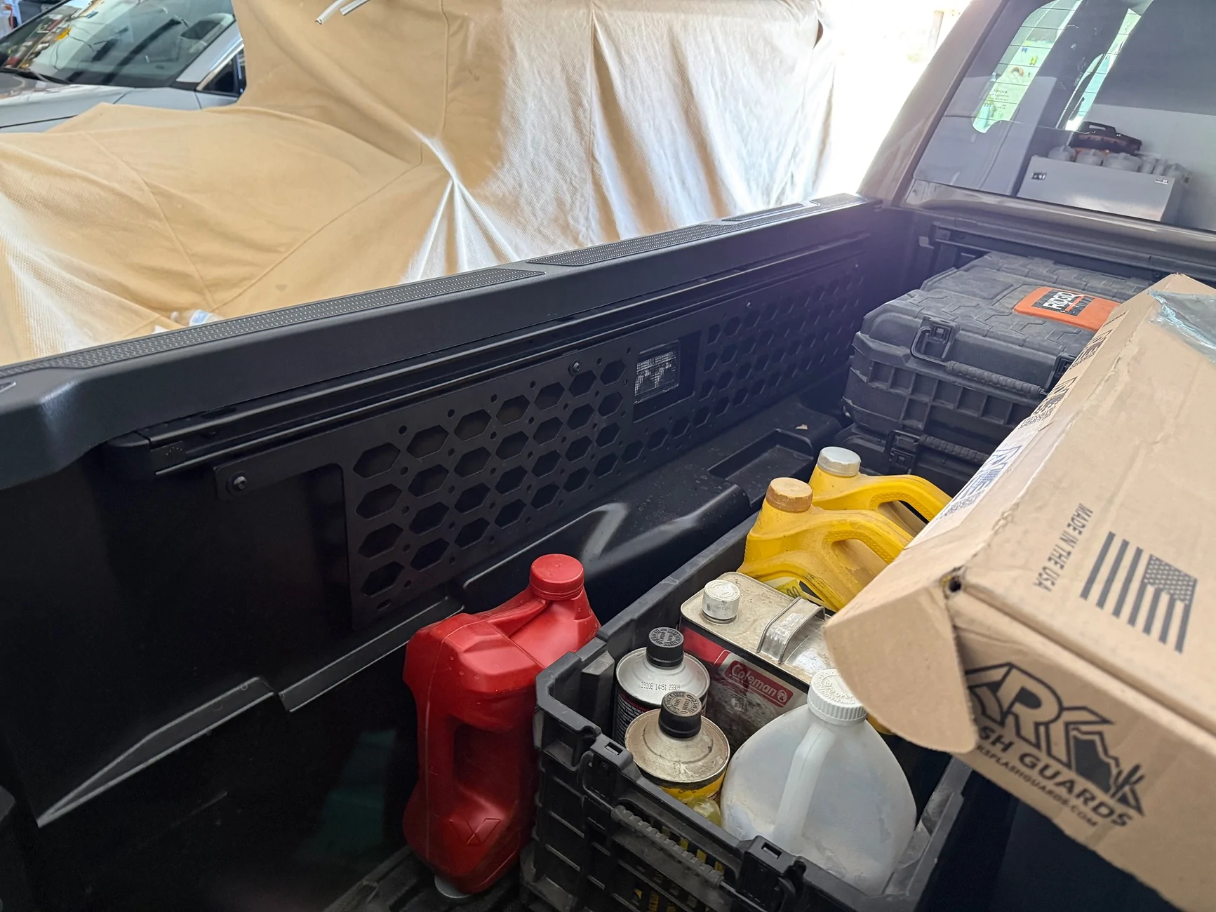

Today i added RC molle panels, cali raised stiffeners. Tomorrow my OVS topper is supposed to arrive, will also be putting ARK splash guards on.

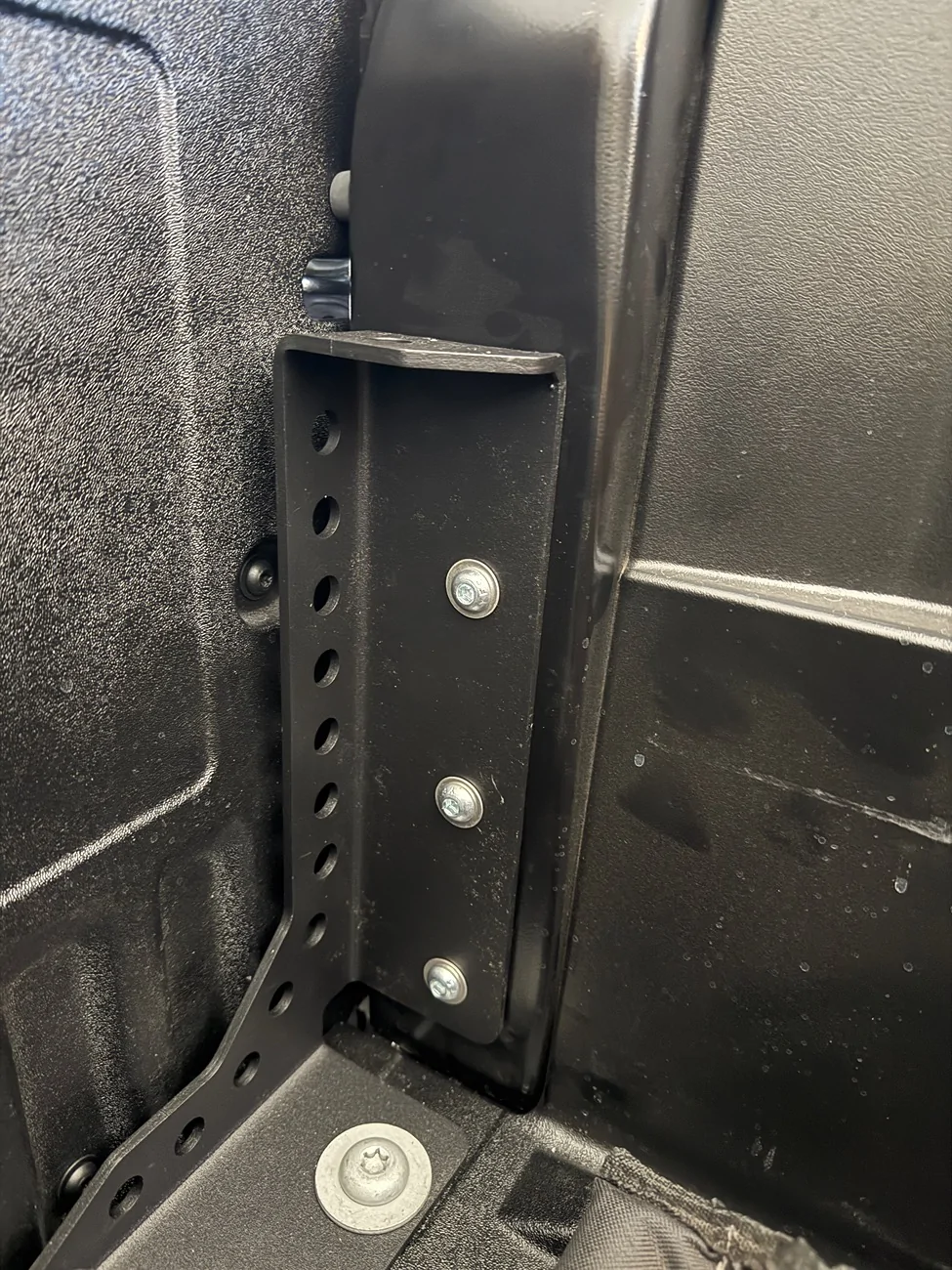

I am a bit worried as to why the rear of the box need stiffeners. Anybody having issues that warrant the addition of these?
I put them on because of the cap and that I off-road. It’s not confirmed that there is a need, but past generations have needed them with added weight on the rails combined with off-road flex.
i haven’t seen any fails with the gen 4 but its early In this gen’s run.
installation in my case was intentionally a belt and suspenders situation, if that makes sense, as I have a good bit of weight in the bed plus the cap.
It's a tradeoff of a composite bed. if you're putting significant weight along the sidewalls or rails, you should get bed stiffener's to help prevent the bed warping or in extreme cases, a crack while off roading.
It's a low cost preventive measure. I don't have them installed, but would if i were to put significant weight on the side walls.
