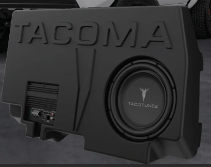

Has anyone received the new Tacotunes sub and amp combo? Im on the preorder and anxiously awaiting shipment. Curious if anyone has received one yet and if so, first impressions? I can upload install photos whenever it shows up. Hopefully run some frequency response tests once its setup as well.

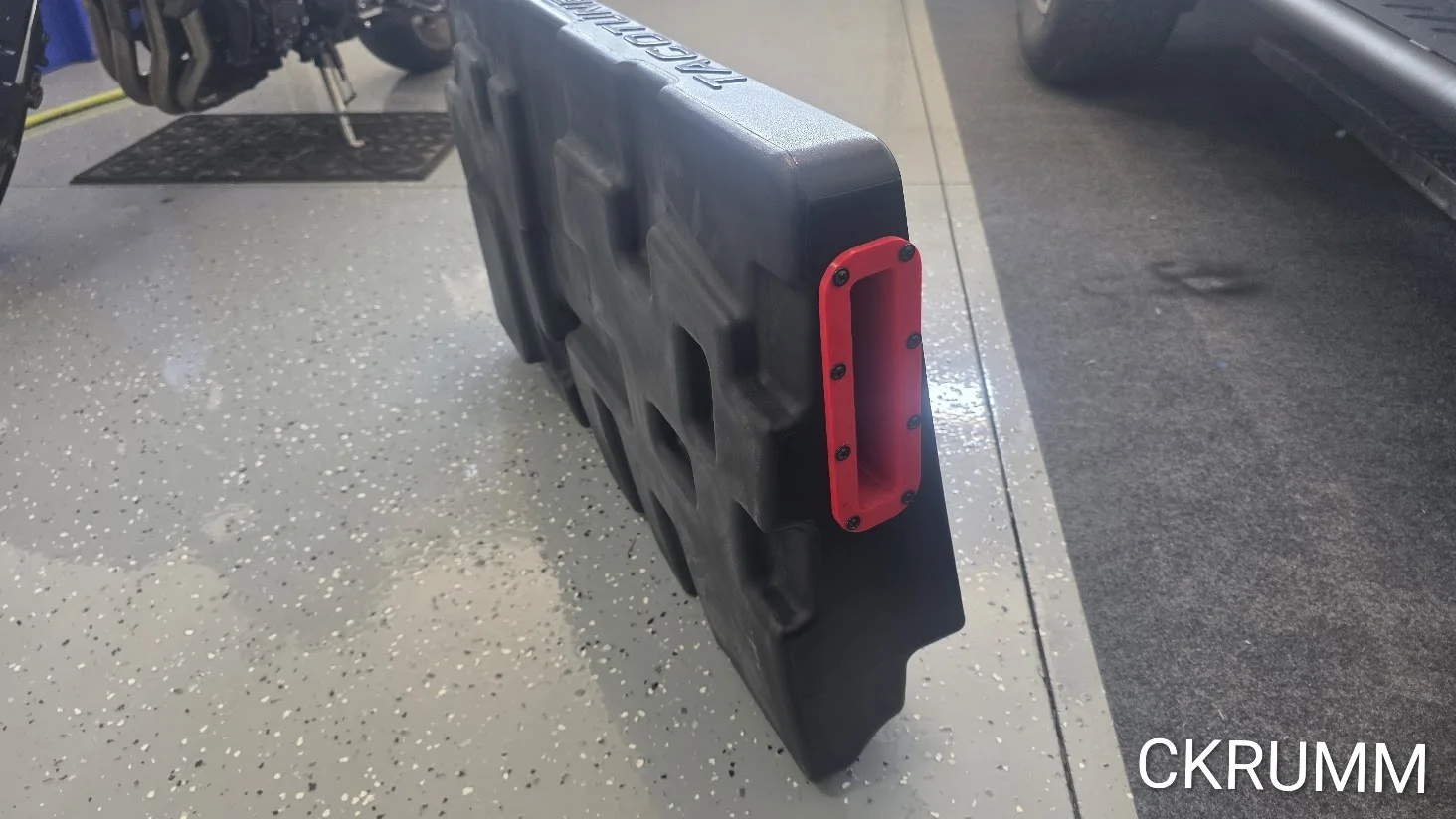

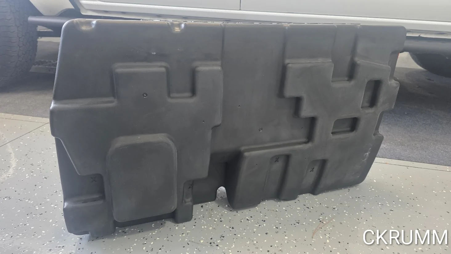

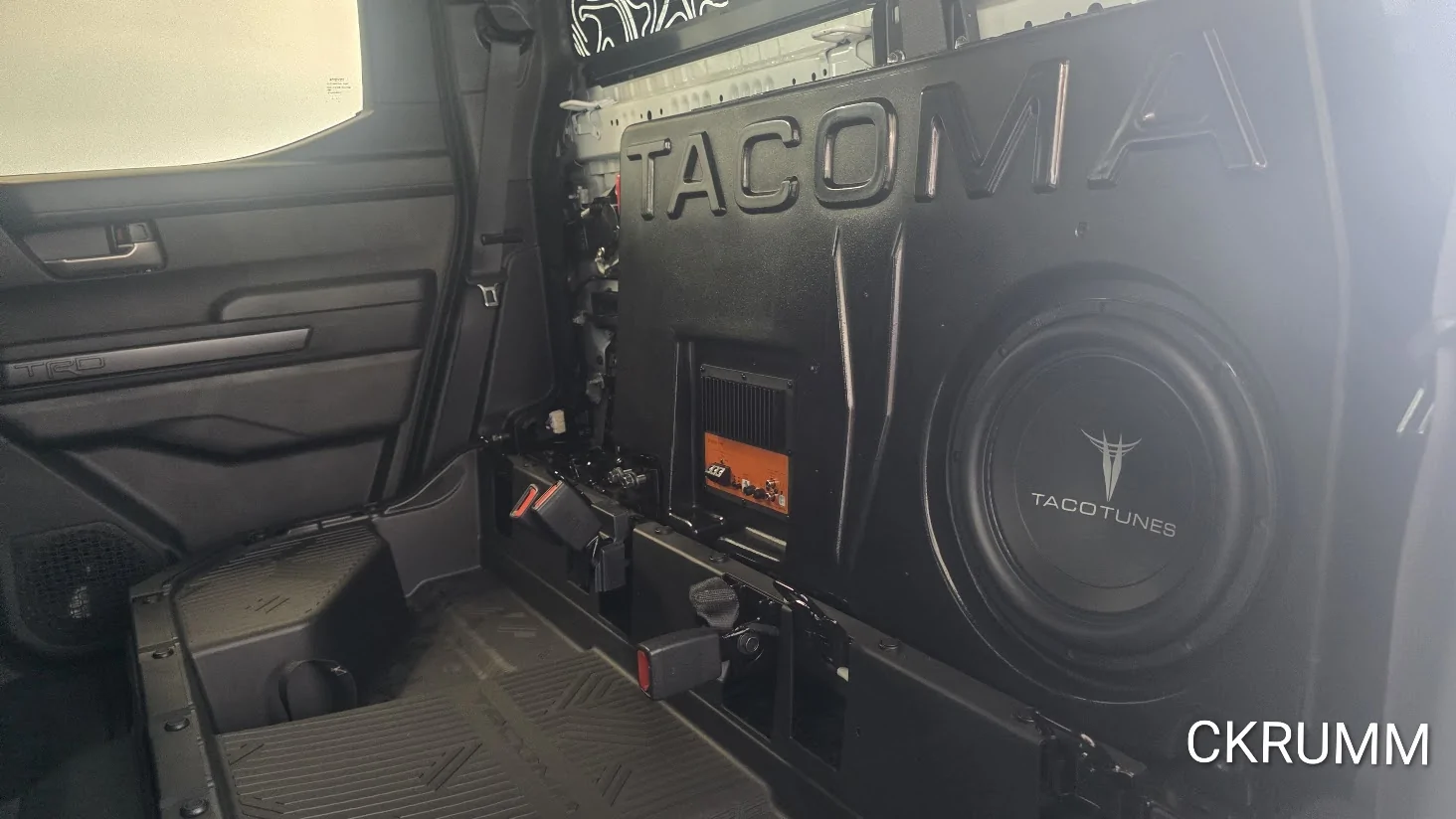

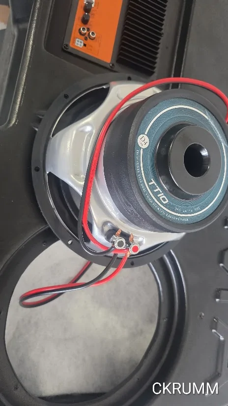

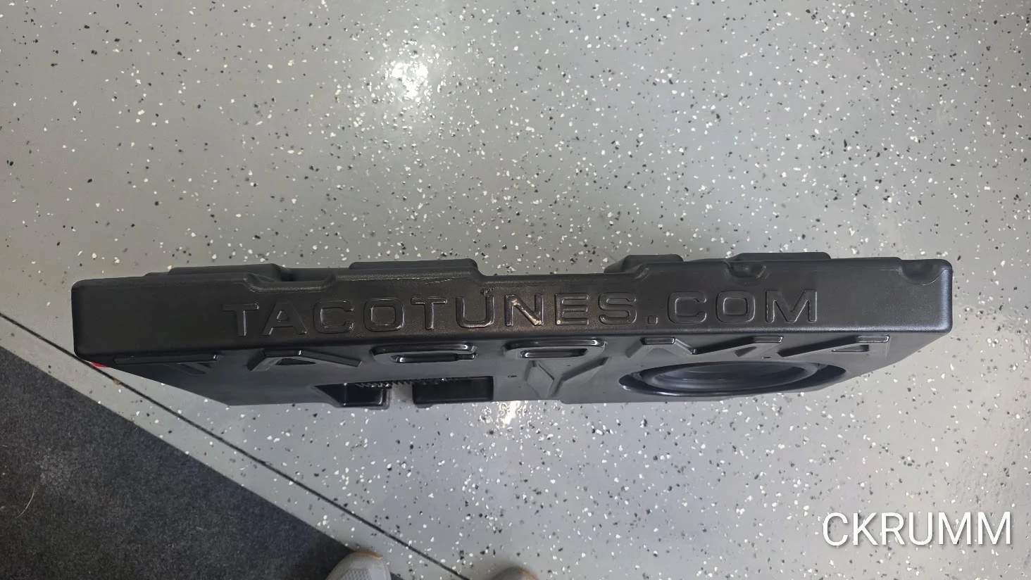

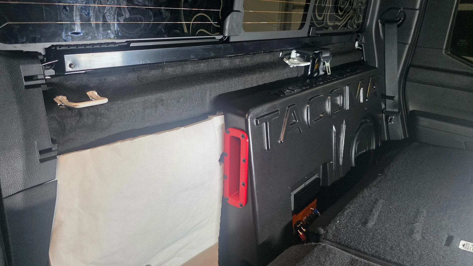

Received the kit this weekend. Grabbed some images for those curious. I'll get some more as I continue the installation. You can see it is an ID 10" sub, box has some stuff already which is nice. Its a bit hollow sounding so some deadener is a good idea. Tacotunes themselves has a video of them deadening the box on the back. I waited to receive mine to see how the tolerances were. I think my 1/4" thick block off plate where the JBL sub vent was might be too thick. With this installed you wont have any plastics covering the back. YOu can cut your oem plastic to give a finished look, or carpet a lot of it, which is my plan. Id rather not cut OEM plastics, and a thick carpet finish over the deadener will improve acoustics while were at it. As of now Im waiting for the seat spacers to arrive that are a required component of this sub install.
A few notes for those looking to do something similar:
1. Carista obd2 dongle with a subscription is needed to deactive ANC and the engine noise.
2. 4gauge wire fits but is a tight squeeze through the firewall opening provided.
3. This amp takes 8g wire max, a reducer is needed.
2024 Tacoma New TacoTunes behind seat Sub/Amp combo box installed
2024 Tacoma New TacoTunes behind seat Sub/Amp combo box back
2024 Tacoma New TacoTunes behind seat Sub/Amp combo box sid
2024 Tacoma New TacoTunes behind seat Sub/Amp combo box to
2024 Tacoma New TacoTunes behind seat Sub/Amp combo box insid
Drifte
Drifte
Colton
Nov 27, 2024
91
88
Iowa
24 Tacoma, 20 RAV4, 10 Tundra, 99 C5
Couple days of testing. When it comes to podcasts or audio books, simply turn down the sub gain and get clear vocals and no boominess.

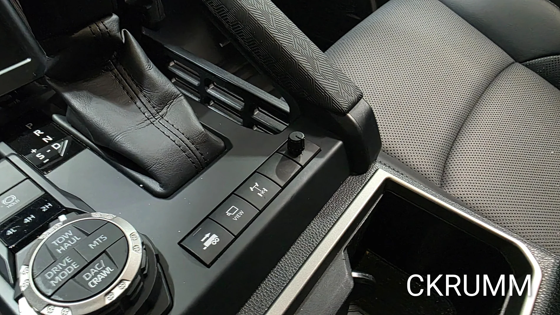

Tedious but managed to make the sub gain knob fit the center console switch blank.
2024 Tacoma New TacoTunes behind seat Sub/Amp combo 20260728_173755~2
2024 Tacoma New TacoTunes behind seat Sub/Amp combo 20260729_202356~2
Drifte
Drifte
Colton
Nov 27, 2024
91
88
Iowa

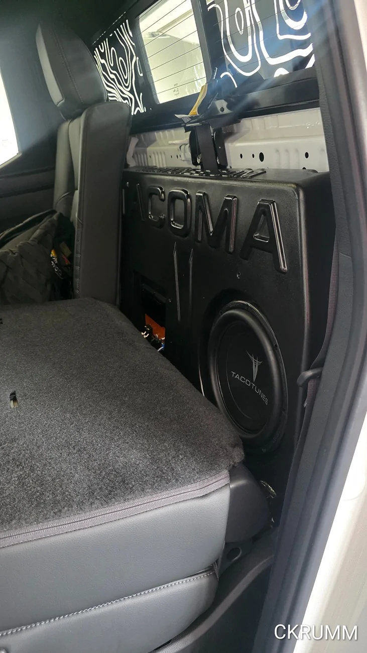

Didn't like the unfinished look of the exposed metal, but wasn't ready to cut up the OEM plastics. Got some adhesive backed black carpet and I think it did the trick.
2024 Tacoma New TacoTunes behind seat Sub/Amp combo 20260806_203322
