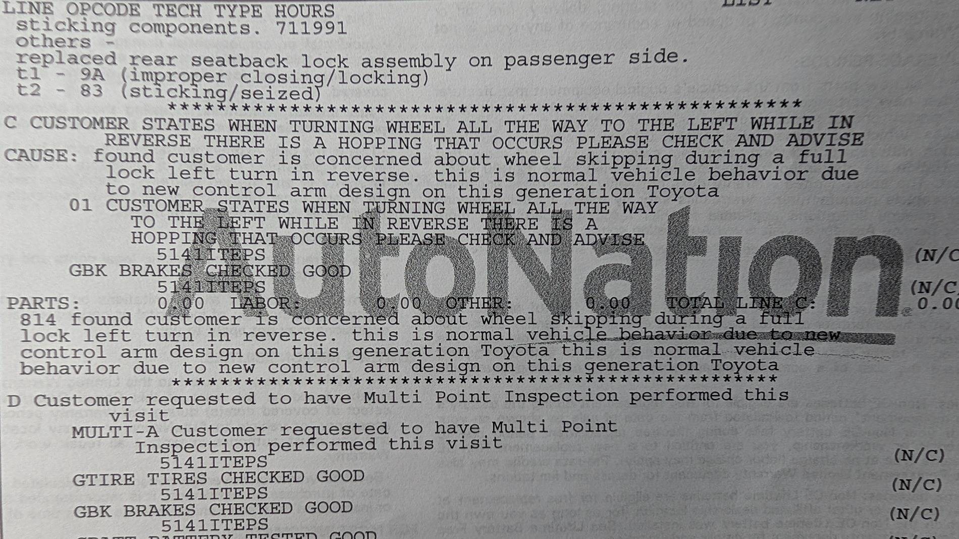

Service Center #1:
1st visit: They claimed they didn't hear the noise.
2nd visit: I test drove it with a tech, they confirmed the noise, kept it 1.5 days then told me it was "normal'.

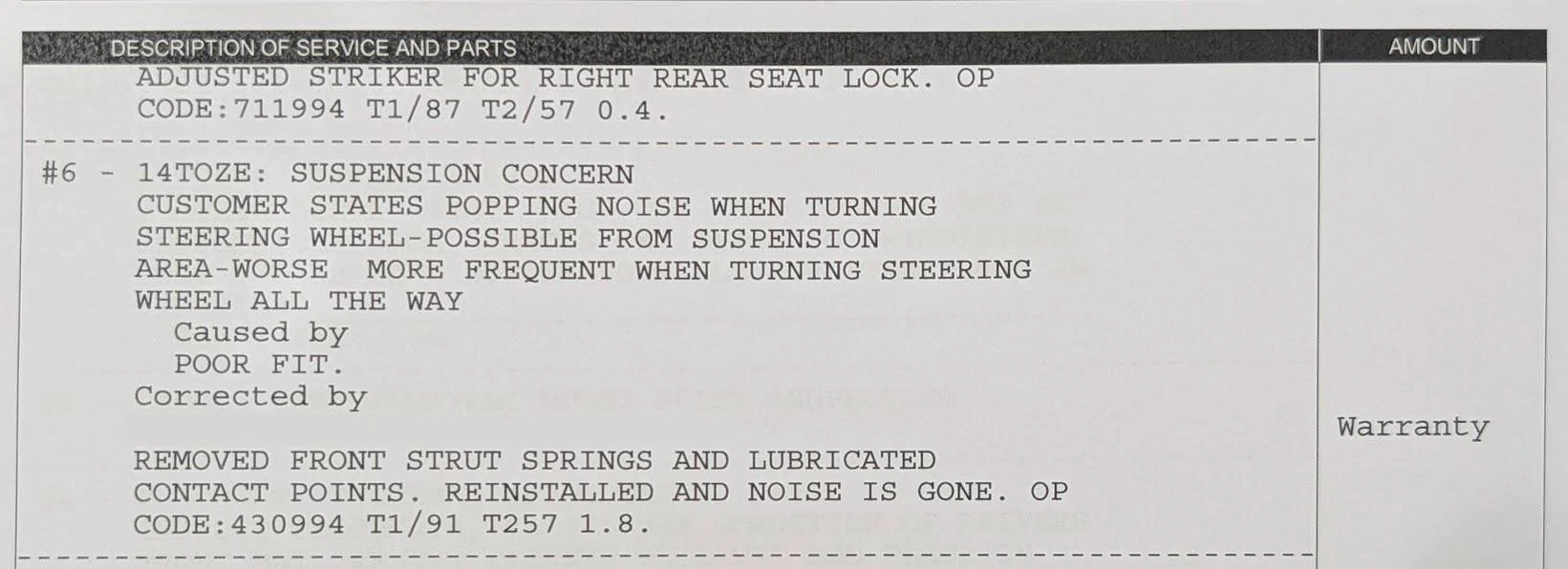

Service Center #2:
I described the situation in the same way. They had it for less than a day and
they removed the front strut springs and lubricated contact points. From limited testing today I didn't hear the noise. I'll report back if that changes. They also fixed a rear seat latch that service center #1 also couldn't fix. Needless to say I'll be driving the extra distance to use service center #2 from now on.

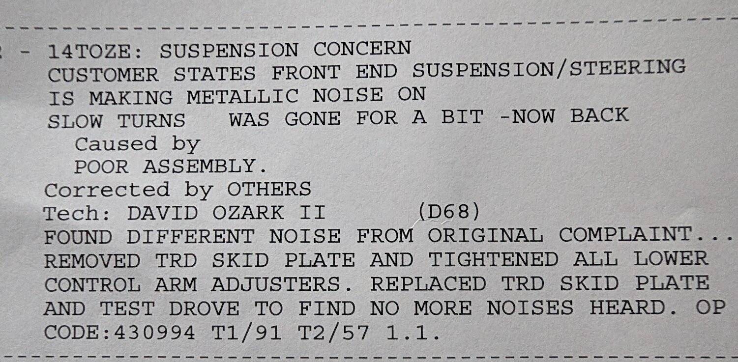

After a weekend of off-roading some similar slow-speed-turn metallic noises returned. I went back to the shop and they are gone again, for now. They said it was a different noise source than before.

Mine did in fact end up being the skid plates. 21ft lbs is the correct spec. I over tightened them . . . twice. Lesson learned. Surprising they made that much racket when flexing until they were loosened up a bit.
