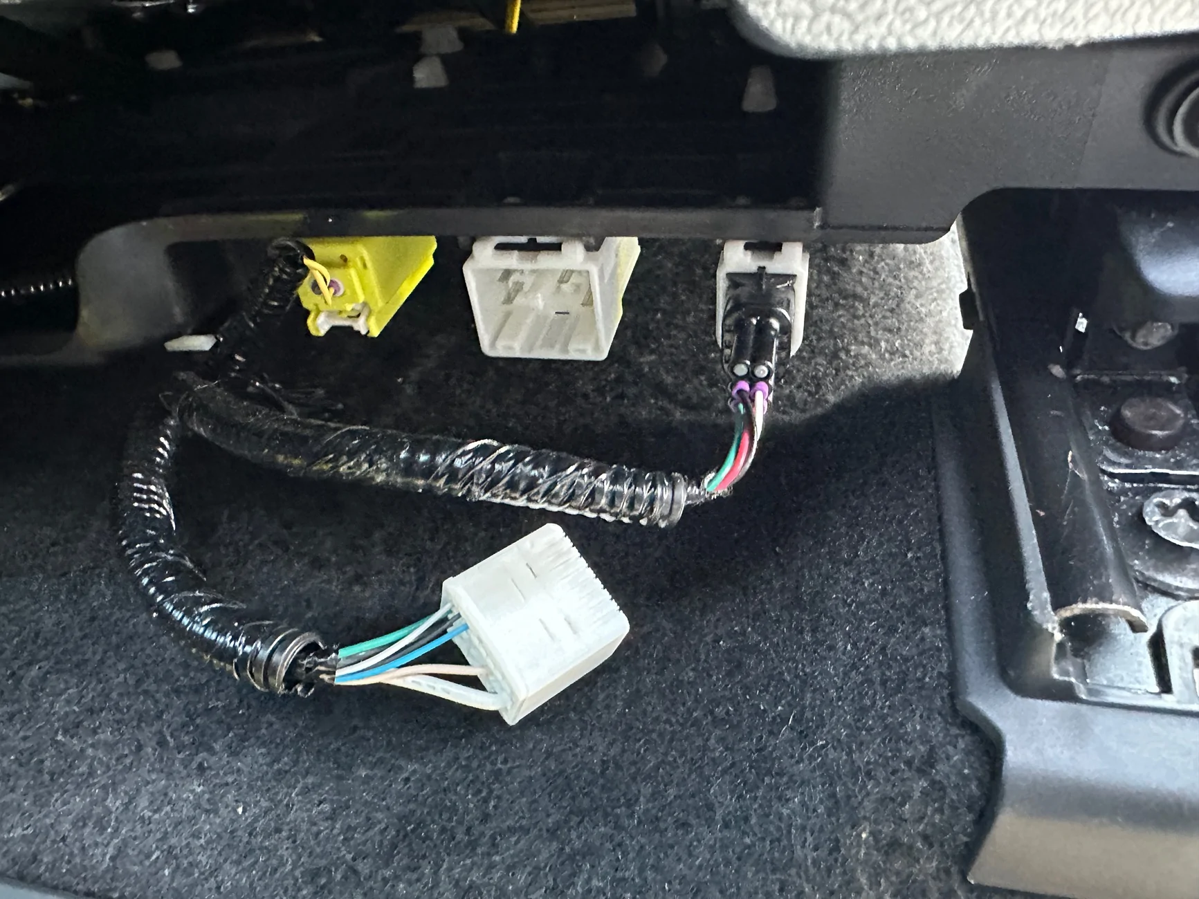

Does anyone happen to know where (or even if there are) fuses for the power seats? I hate when I find the perfect position and then someone moves it. Lack of memory seats is annoying!
I didn’t get a physical manual with mine (it’s incoming) so couldn’t check there.
Thanks!

That’s a great idea. I keep bumping my seat controls when I get out.
I guess the big question is does that fuse only cover the power seats?

I had a look and can only see seat heating fuses under there.

Well I couldn’t find any fuse so did the next best thing and just found the plug under the seat that disables the seat switches. I’ll unplug this each time I bring it in for service, etc. Can’t leave it disconnected though since it disconnects the cooled and heated seats also.
