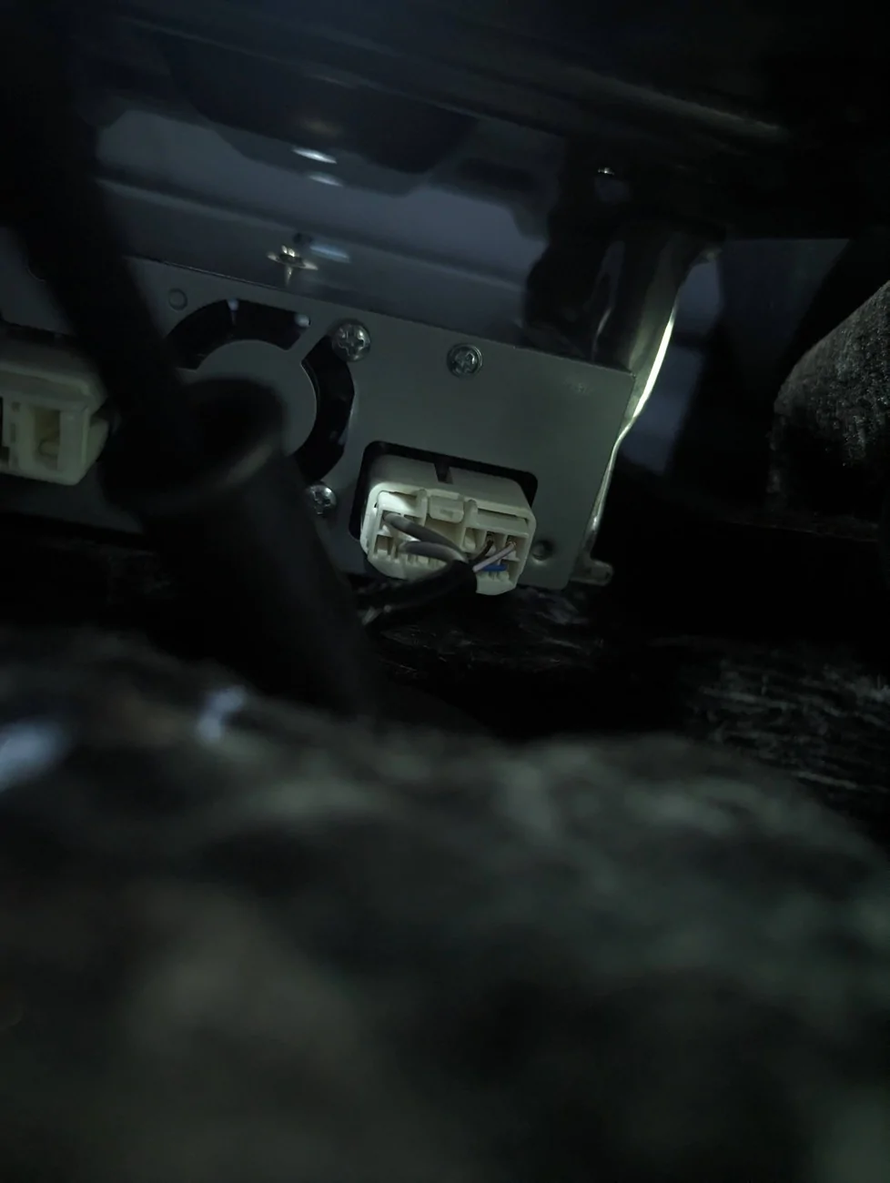

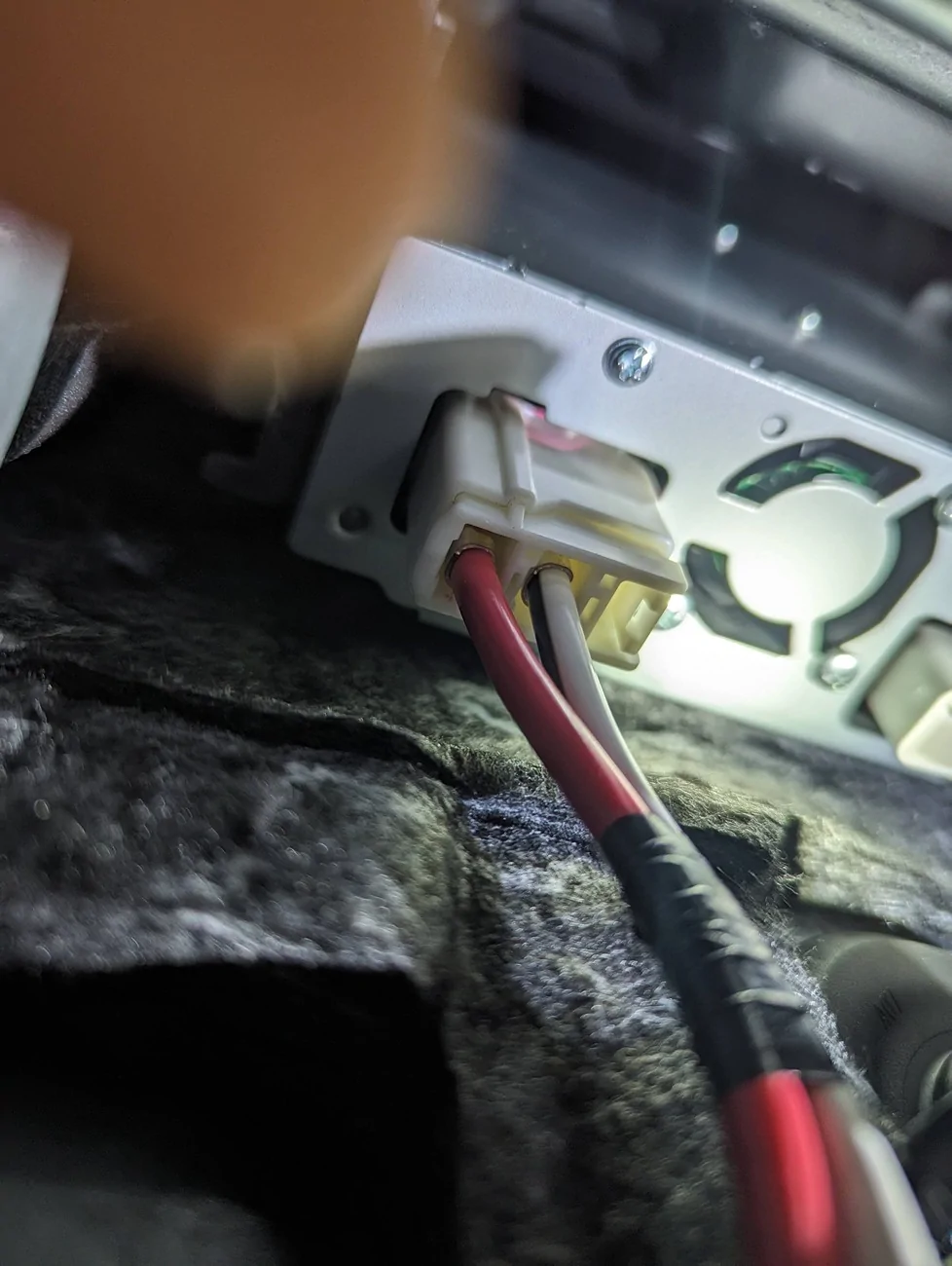

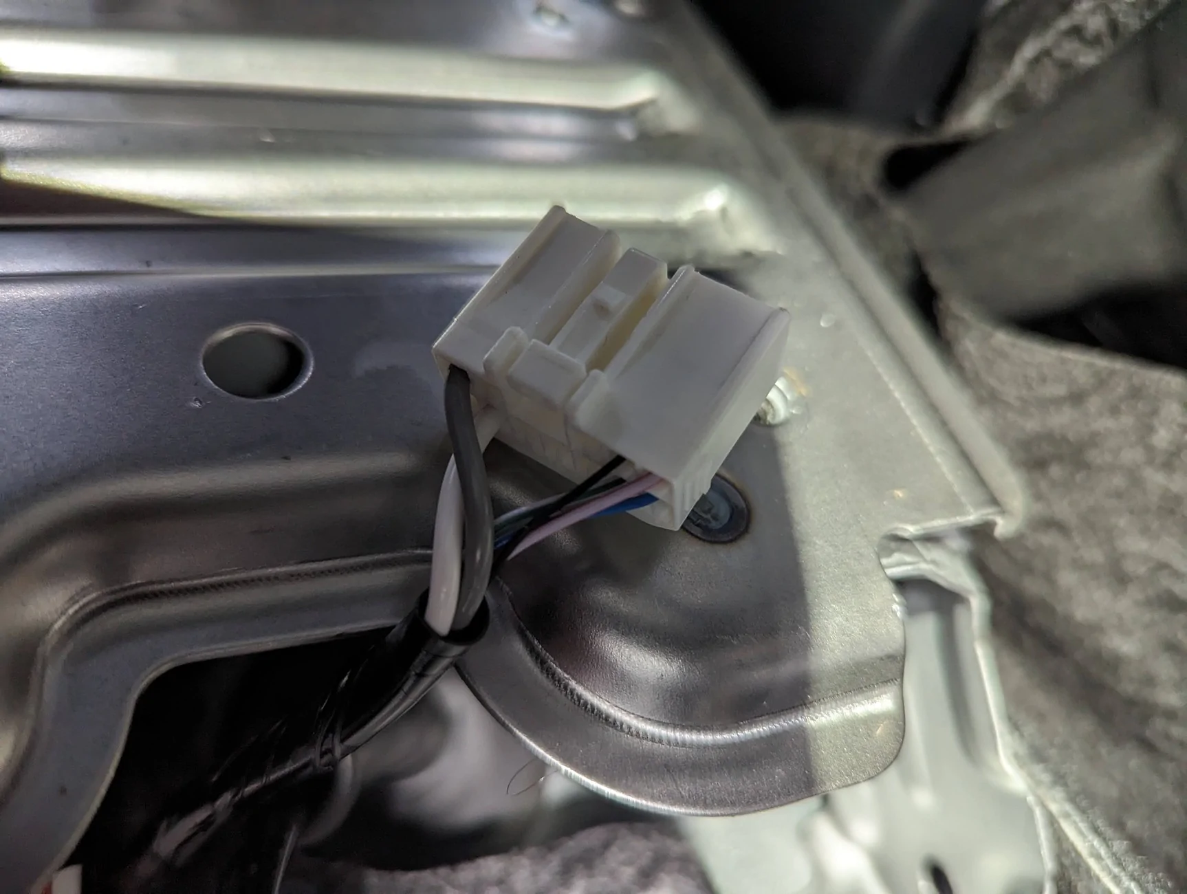

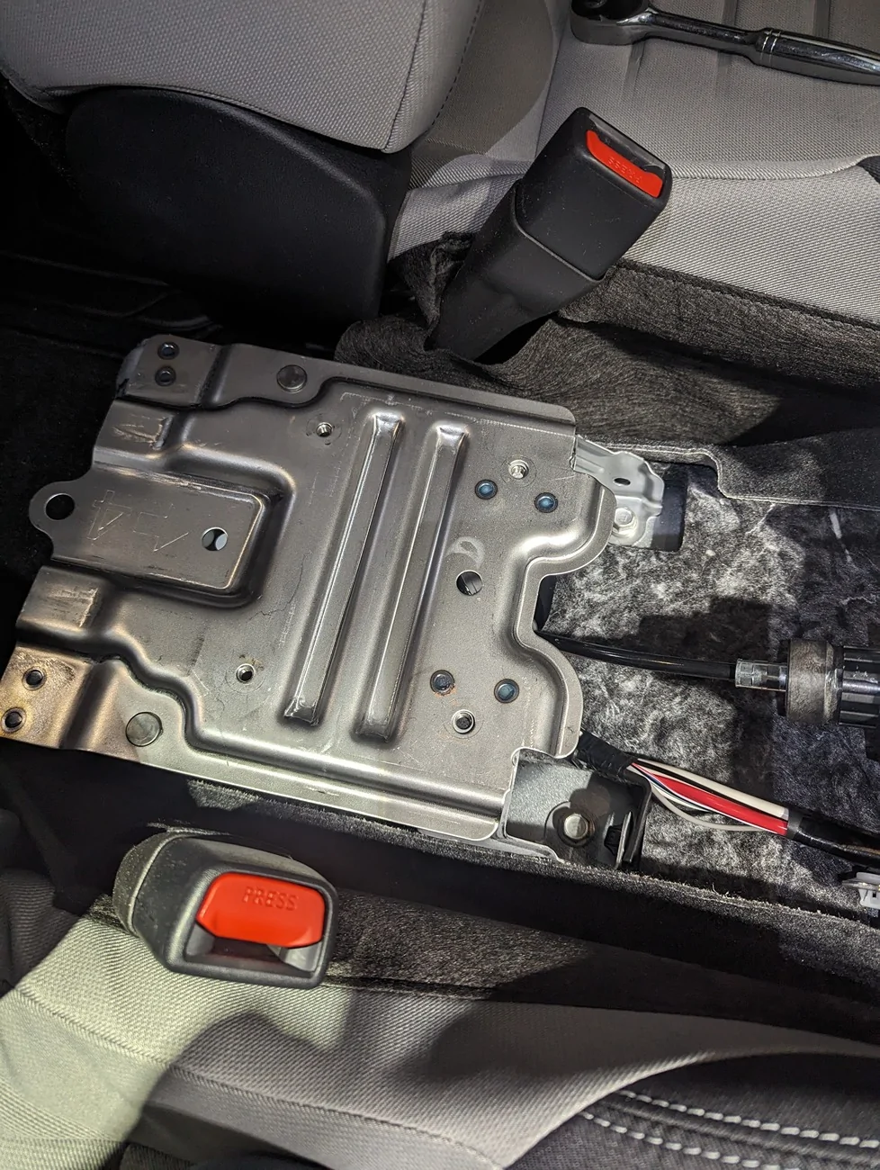

Does anyone know where the factory inverter that feeds the 400A/100A 120V AC plugs lives in the 4th gen? In the third gen it's under the center console but I haven't found any definitive info about where to find it in our trucks.
Interested in potentially replacing it with a more powerful aftermarket solution or tapping the outputs, any info would be appreciated!

It's still in the same spot. The wiring is slightly different than the 3rd gen though. I tried figuring out the hack to force it to stay at 400 watts all the time but the wires are different colors and I couldn't figure out which one was the trigger and didn't want to randomly cut wires so I ended up not doing anything with it.
