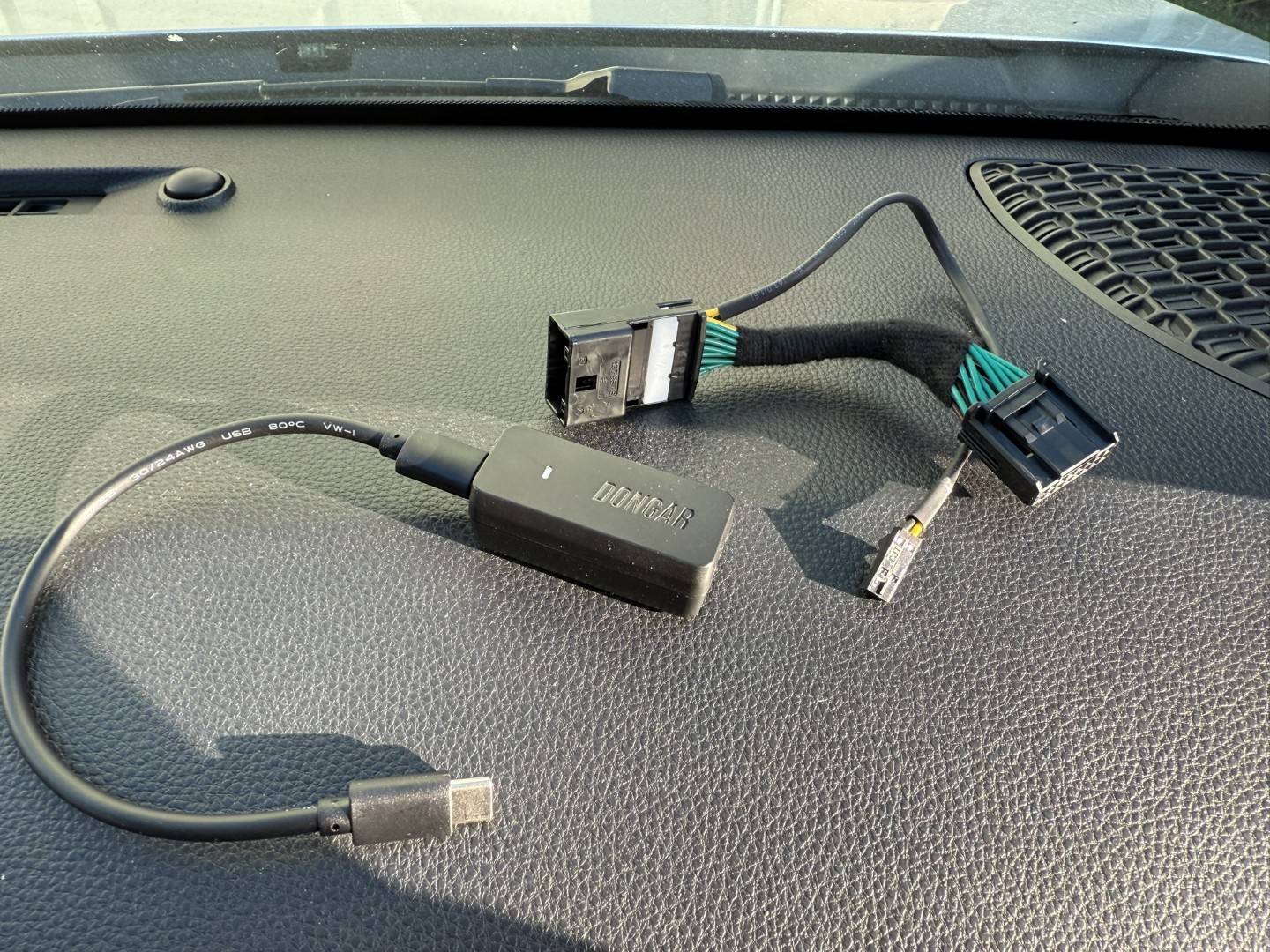

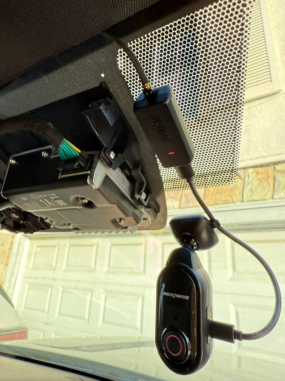

Thought you guys would like my newest product... a USB-C power adapter (capable of 5V/9V/12V USB-C output, overcurrent/overvoltage protection, etc.) that hooks up to your lane trace sensor computer. (I bet right now you're like "Is that safe??" See write-up and testing in the follow-up post). The 16-pin connectors that piggy back onto the TSS 3.0 lane trace system are authentic TE parts (unlike all the garbage from fitcamx / fitdvr).
USB-C module is engineered in-house by our talented EE out in Europe and isn't some repurposed generic USB module found in a cigarette lighter. For a USB module, this thing is over-engineered and capable of up to 18W output, fine-tuned and field-tested for optimal heat performance.
Harness + Dongar 5/9/12V USB-C module
2024 Tacoma Powering radar (and other gadgets) from TSS. Dongar preview (USB-C power adapter that hooks up to your lane trace sensor computer) IMG_2904 (Large).JPEG

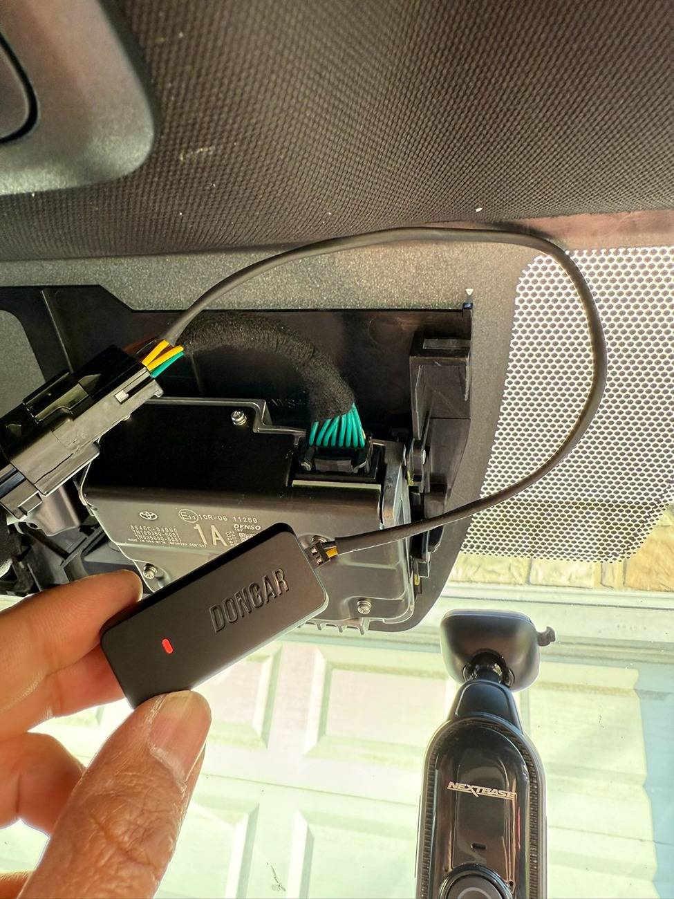

Plugged into TSS 3.0 Lane Trace system.. TE connectors means a true OEM feel and click.

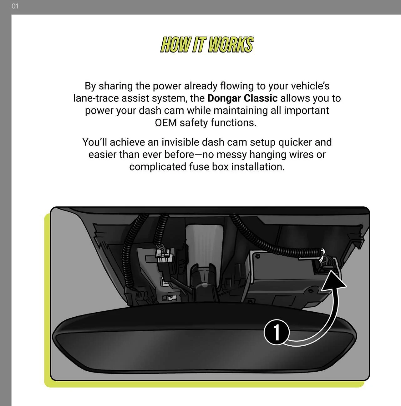

Instruction Manual Preview

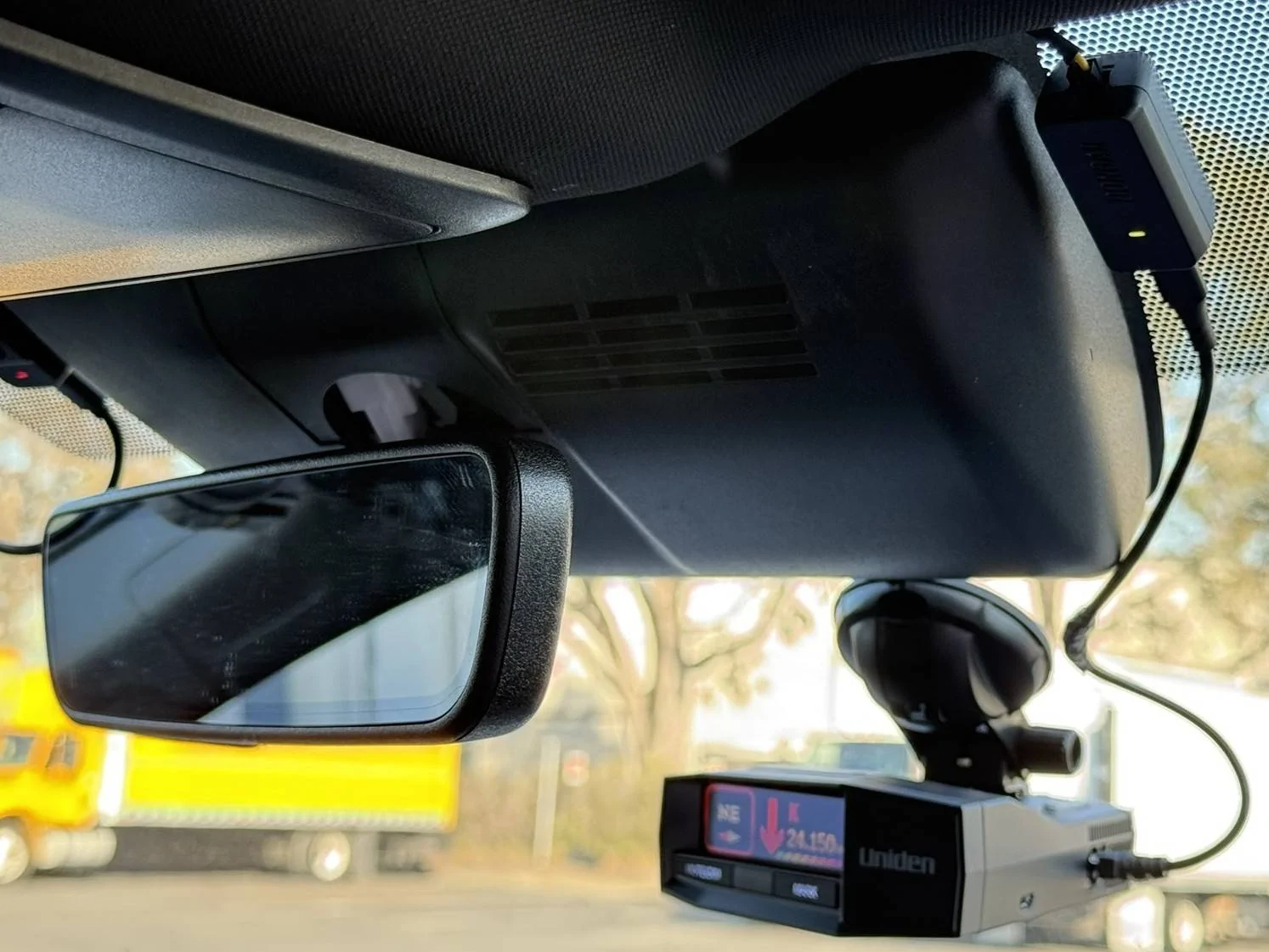

Field testing in a 2025 RAV4 (TSS2.5) powering the brand new Uniden R8W radar detector at its native 12V with a USB-C to RJ11 cable:

I wanted to do some data-logging to see how much fuse capacity was overhead... it can seem sketchy plugging something directly into the TSS Lane Trace assist, but I've been wanting to demonstrate why it isn't as risky as you think... some of the companies that have cloned my products (FitDVR / FitCamX in particular) have sold products that plug into TSS for the last couple of years. I've wanted to do this for a while, but because I'm in the USA?I have to worry about things like getting sued or blamed for selling something:punch: whereas they don't because they're 100% based in China.
Anyways, I hacked together a shorty RJ11-to USBC cable using a generic USB-C PD trigger cable:
2024 Tacoma Powering radar (and other gadgets) from TSS. Dongar preview (USB-C power adapter that hooks up to your lane trace sensor computer) 1745015418318-y6

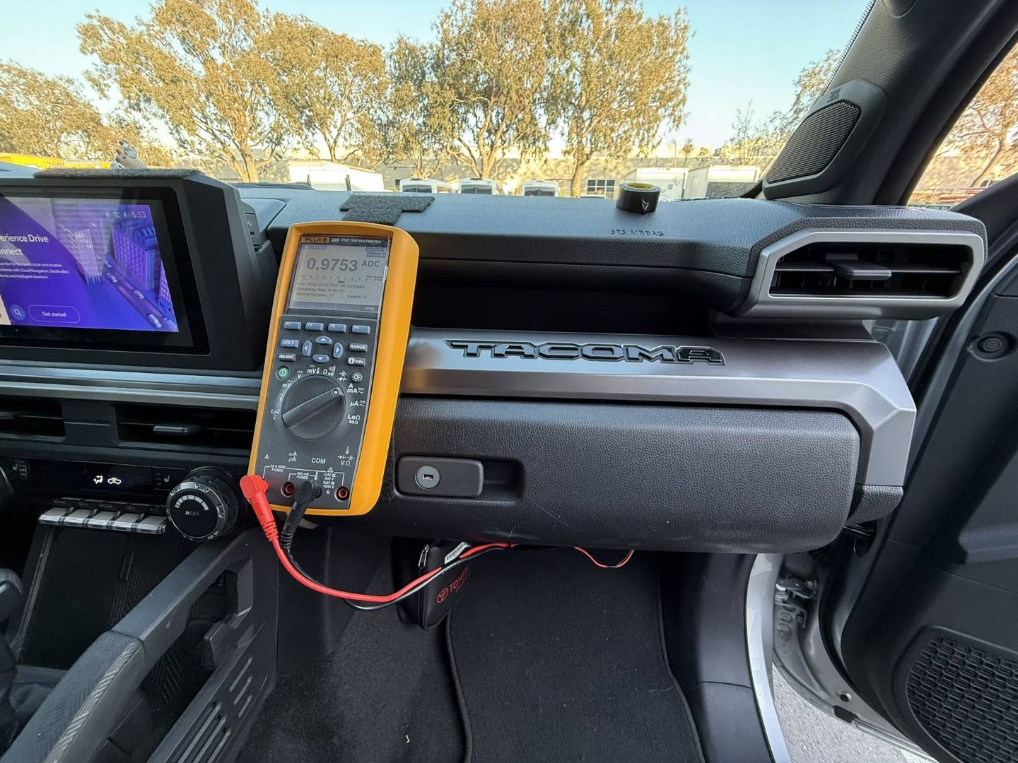

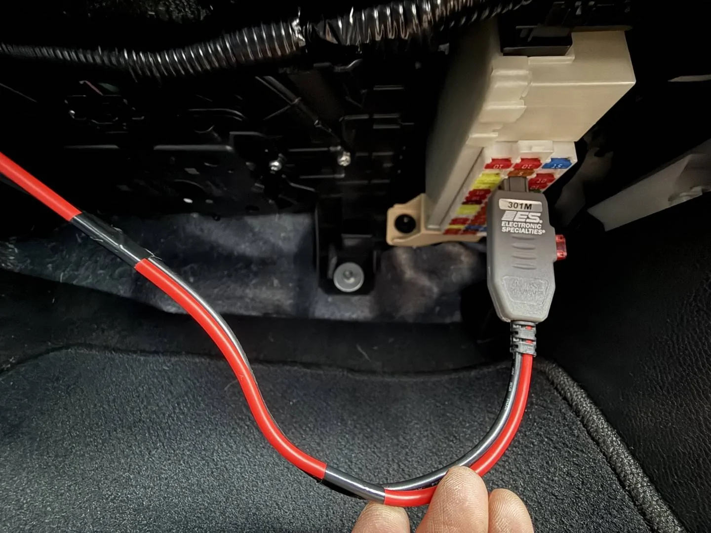

Then, hooked up my Fluke 289 logging multimeter (greatest dmm ever made imo) to monitor and log load on the circuit using a ESI Fuse Buddy 301M:
2024 Tacoma Powering radar (and other gadgets) from TSS. Dongar preview (USB-C power adapter that hooks up to your lane trace sensor computer) 1745015387893-su
2024 Tacoma Powering radar (and other gadgets) from TSS. Dongar preview (USB-C power adapter that hooks up to your lane trace sensor computer) 1745015485037-fg
The circuit, which powers the TSS Lane Trace system, reads ~.56A. Adding the radar bumped it up to ~1.0A at rest... Plenty below the fuse’s 10A rating:
All TSS features like adaptive cruise control and lane trace assist work normally ?‍♂. Blowing the fuse (or ripping it out) while driving produces a 'system malfunction error' on the instrument cluster and TSS functions stop. Everything returns to normal after replacing the fuse. Testing will continue using higher loads like multi-channel dashcams or load simulators at the USB module (which we already added overvoltage & overcurrent protection features) to see if anything happens.
Spoiler alert: nothing happens, but thought the community would like to see it in action! In conclusion, using the plug at the Toyota Safety Sense lane trace system is a super convenient dashcam powering solution for trim levels that don't come with an autodimming mirror circuit (or wiring provisions for the OEM dashcam) from the factory... TSS has been standard equipment on all Toyotas in USA/Canada for the last 4-5 years so I'm happy to say we have an easy and low-risk dashcam install solution for any new Toyota/Lexus out there ?
