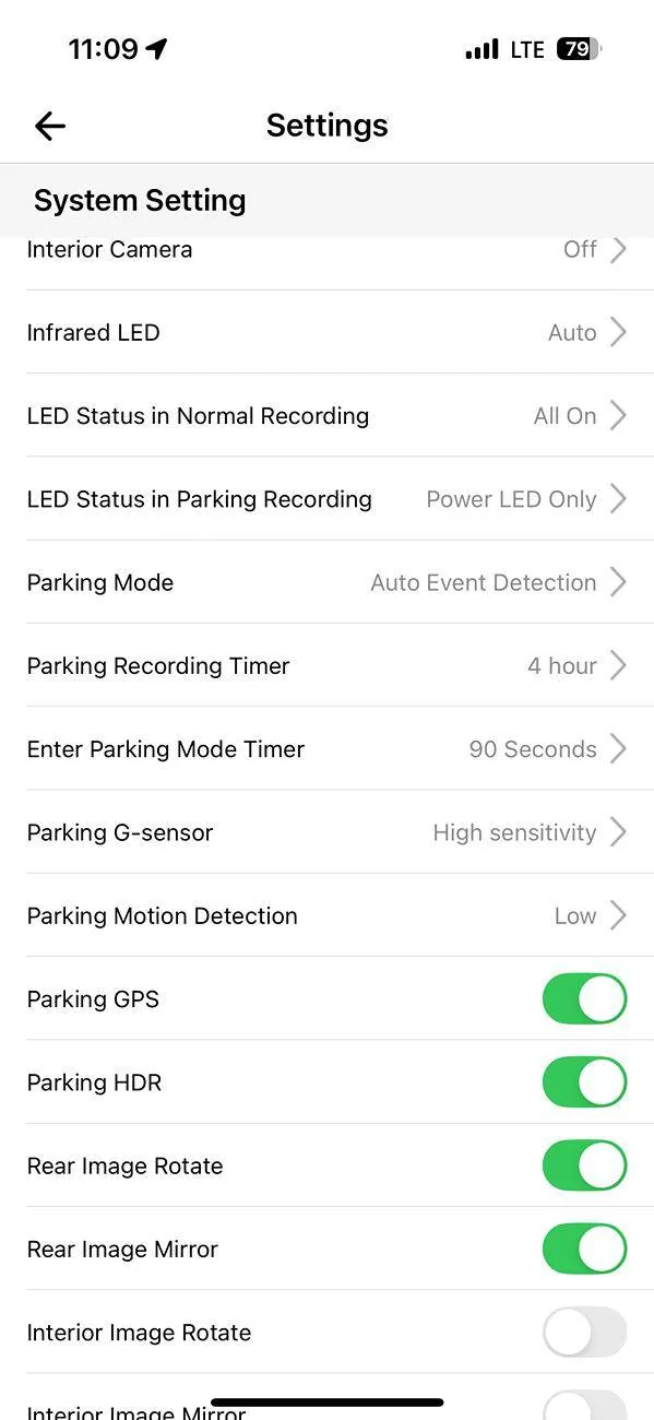

So, I’m in a busy parking lot ritght now, and with the engine running, parking mode kicked on for me. These are my settings.
2024 Tacoma Dongar PRO adapter and VIOFO dash cams parking mode not working IMG_0631
I have pretty much the same settings. But in today's latest test, I changed the parking motion detection to Low to test out the motion theory. But I'm getting mixed results. Here's the timeline:
