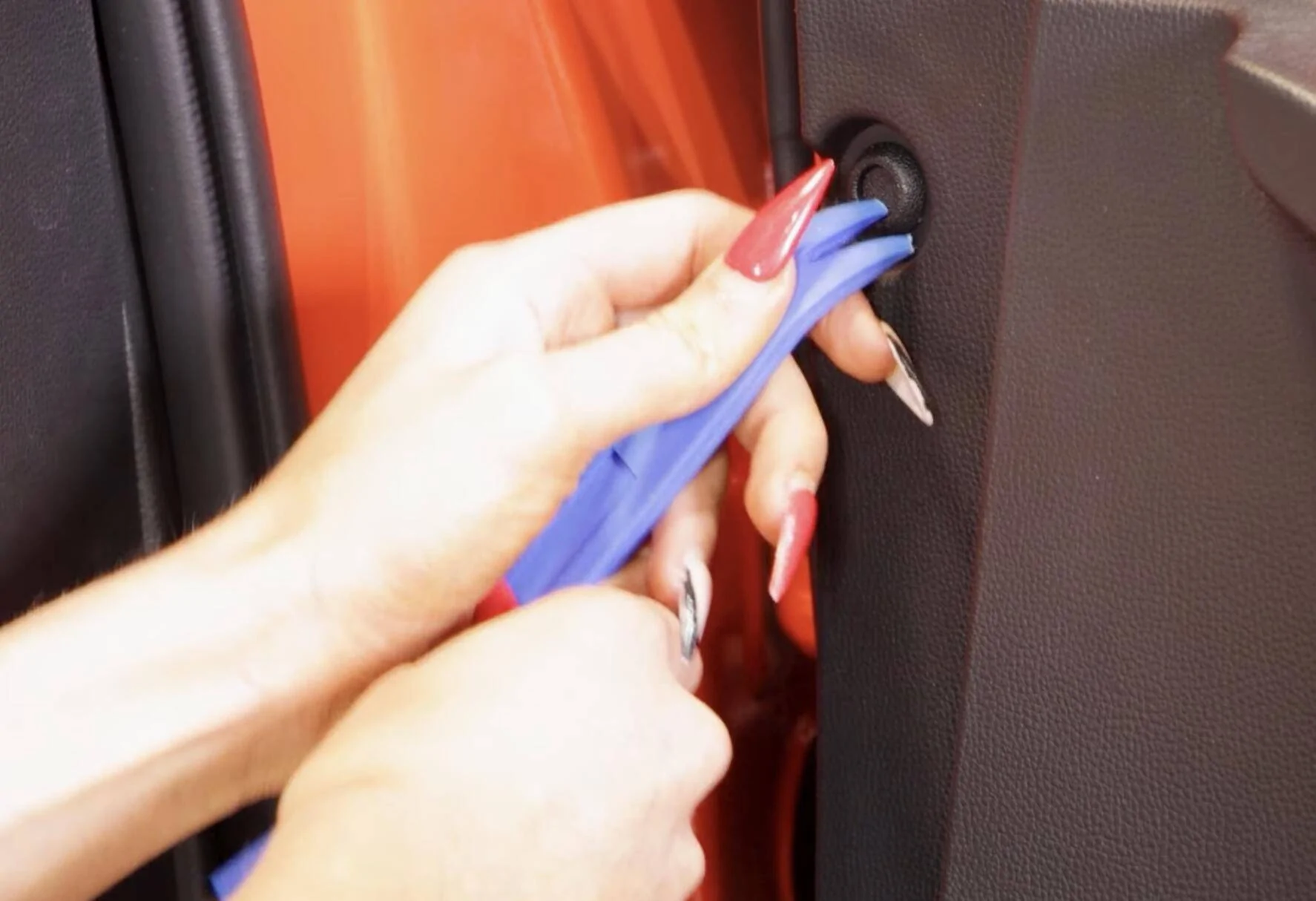

There is a video on yt to show how to get the door cards off:

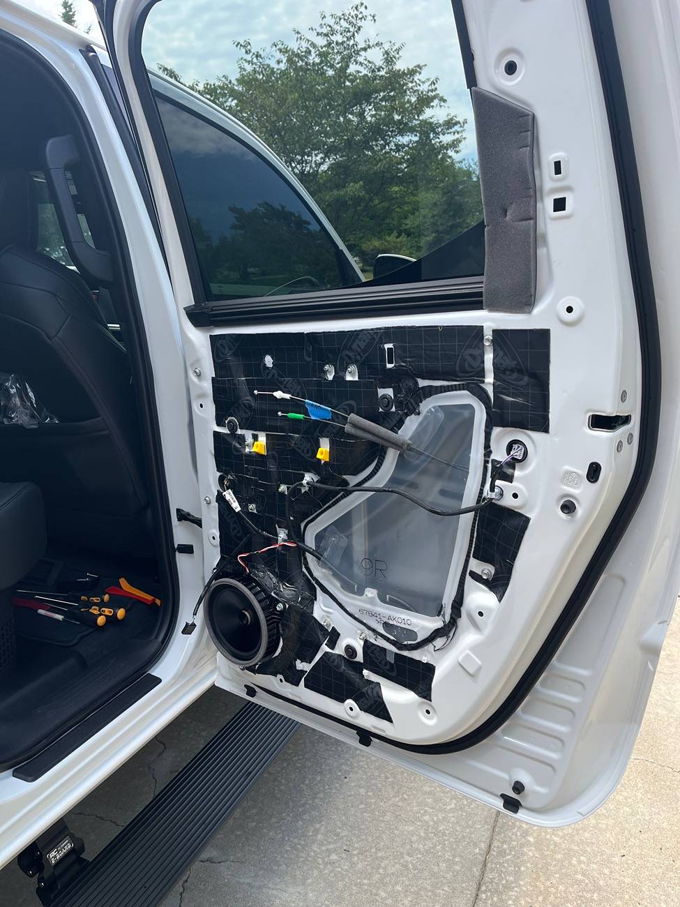

Pop off the door panel and slap sound deadening all inside and especially around the speakers. My rattle is gone now.

I watched the video in post #4 again and only have one question.....
If you have fingernails like that, why do you need a pry tool??
