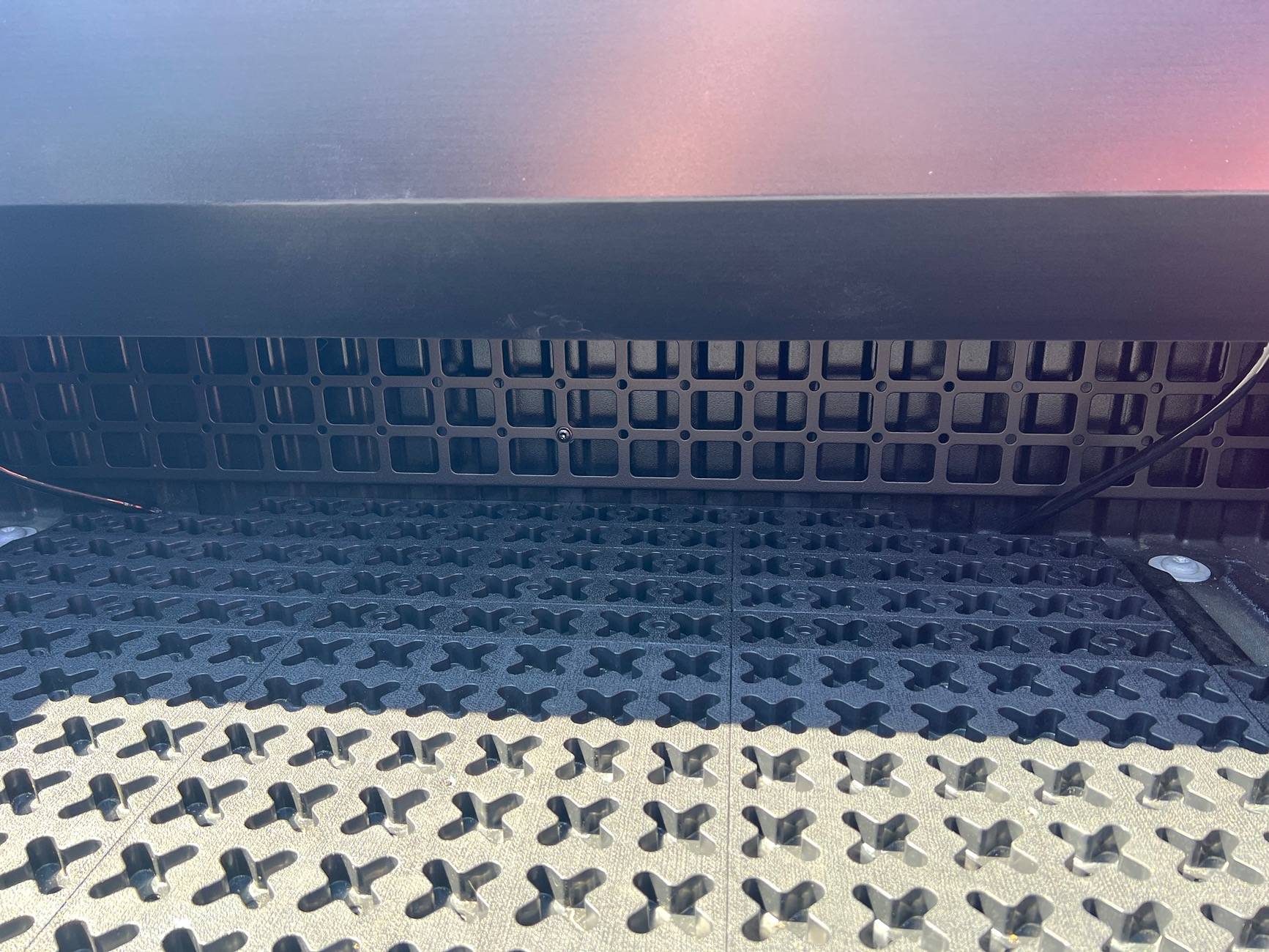

Install molle panels first. You won’t have access to install the front one or to the forward bed rail bolts it the cover is installed first. You will also lose most if not all use of the front molle panels. I installed the Toyota panels though and a Retrax.
2024 Tacoma RC Hard Rollup Tonneau Cover + Molle Panels - Install in what order? IMG_4984
