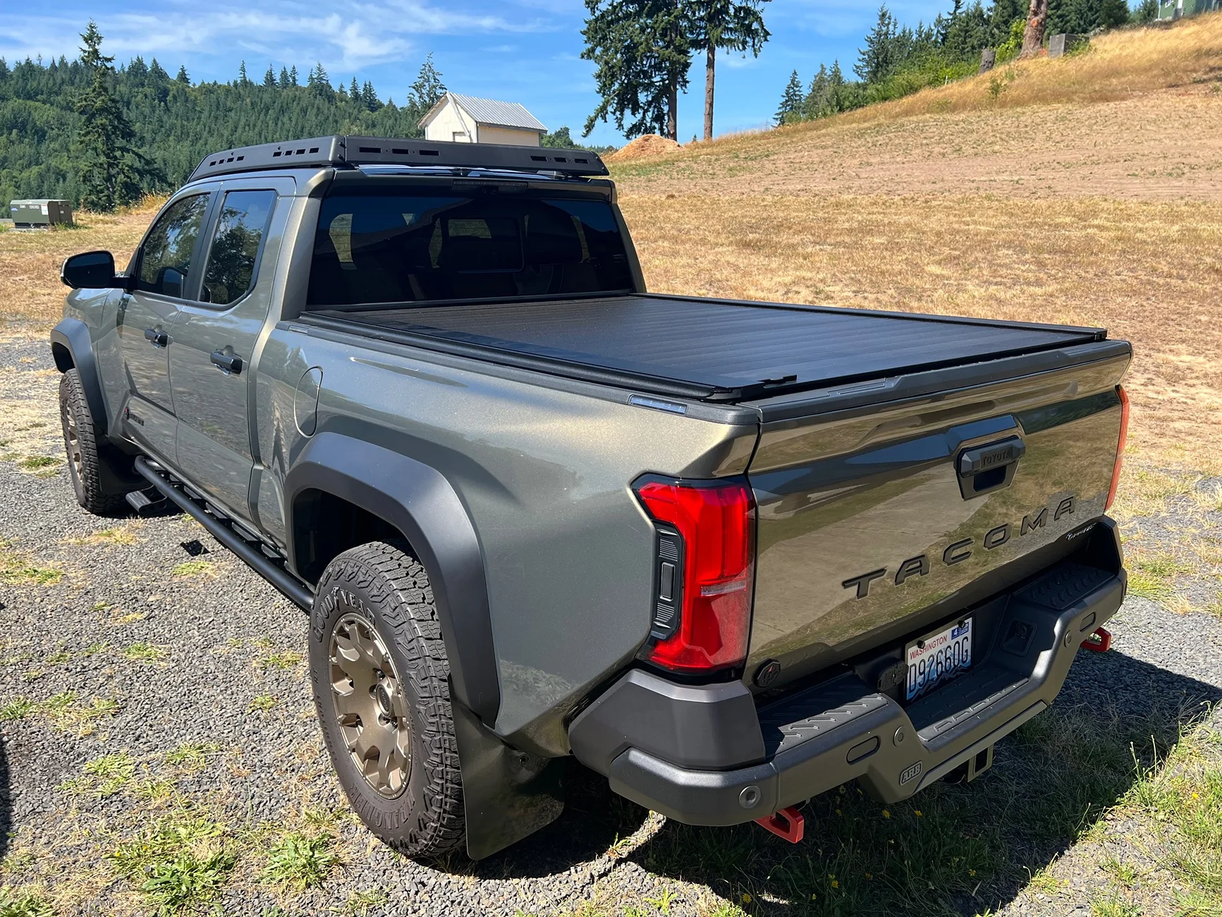

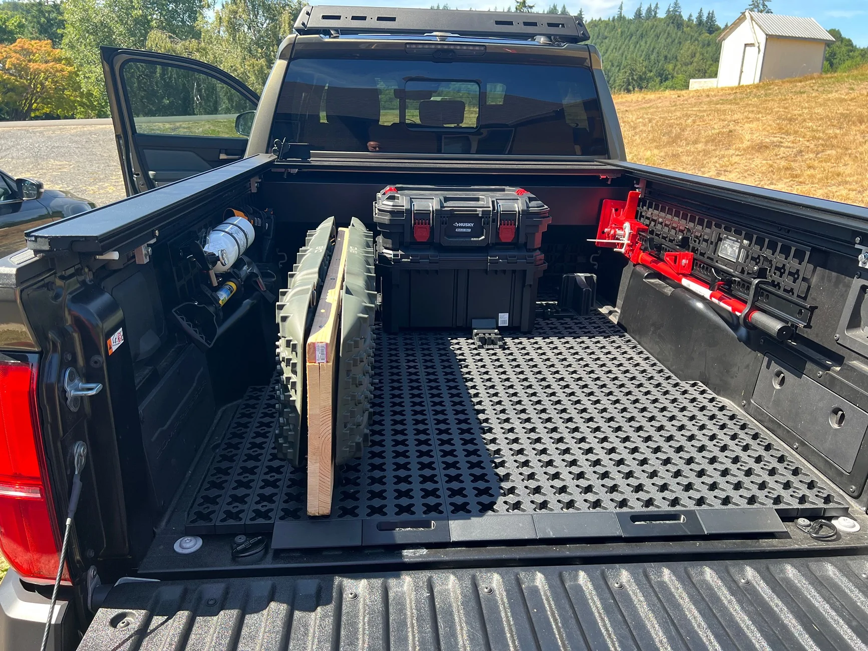

I installed the OEM panels and a Retrax Pro without issues. I don’t know how the factory mounts tri-fold mounts though.
That is one nice setup! Yeah wish i had known about this prior to purchasing the OEM hard cover. Would've gone with something similar to this. Cheers for the reply!

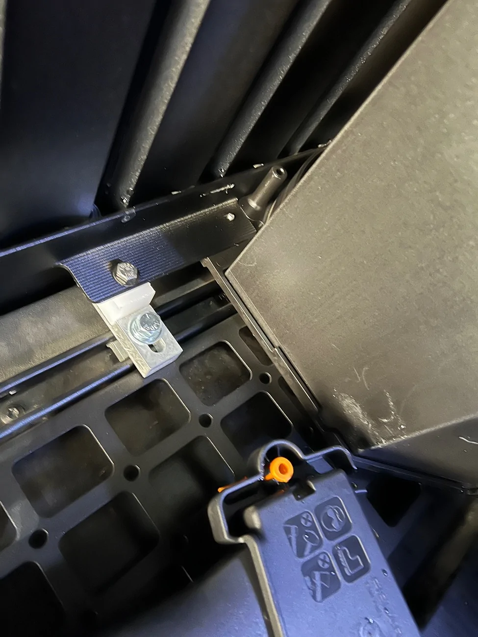

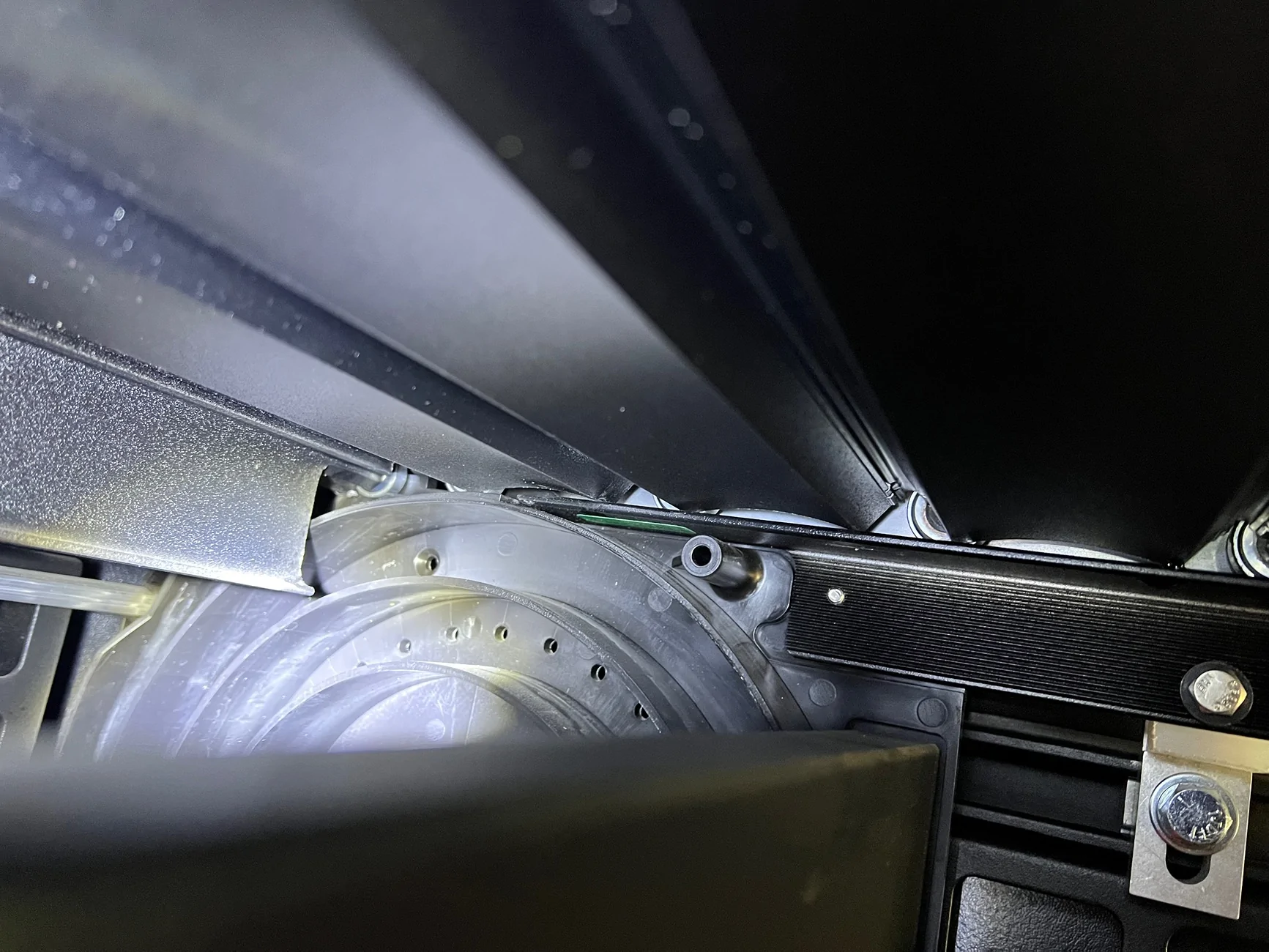

So the Molle tucks behind the canister (to the sides) I wasn't sure if the canister would interfere with the Molle or not. I would somewhat have to remove and re install the cover to access the corner portion of the Molle or can I just slide it between the bedside and canister? Thanks
I think you’d have to remove it. I installed the molle panels myself but had the cover installed. The panels install behind the bed rails and are pretty much flush with them. You use some of the bed rail screws for the installation. You’ll also have to drill a couple of holes in the bed.
