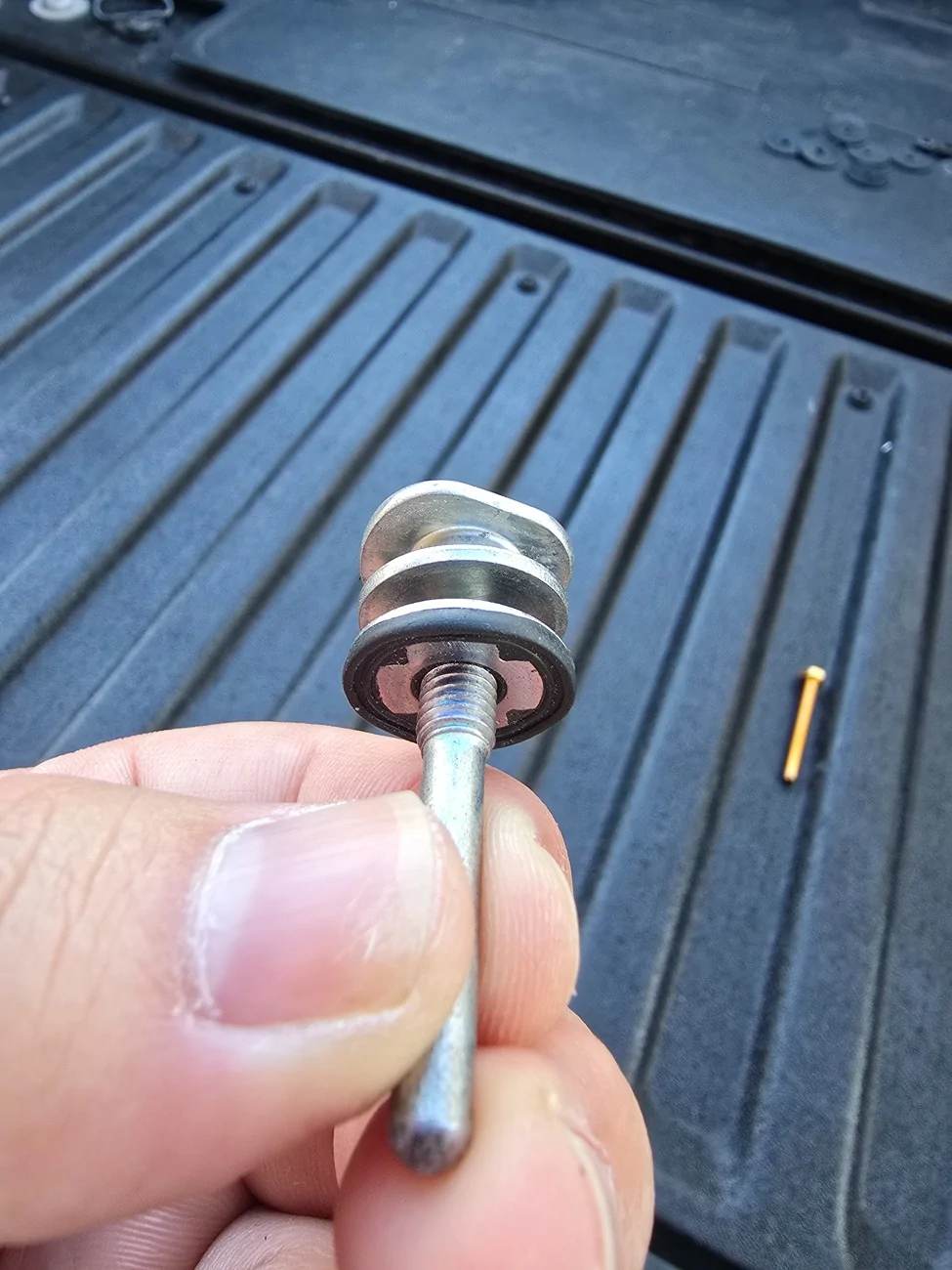

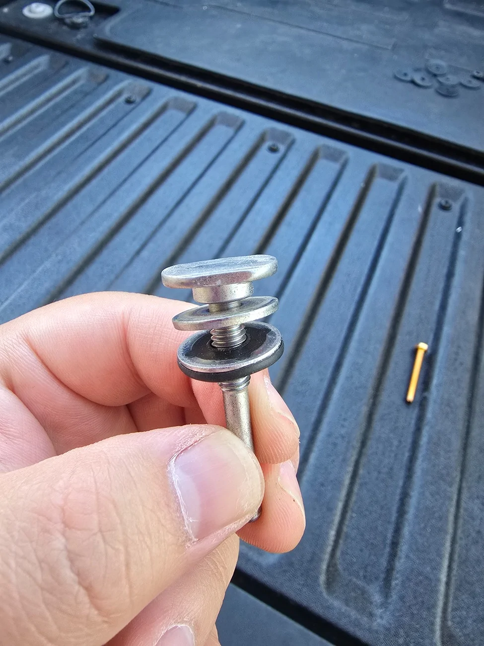

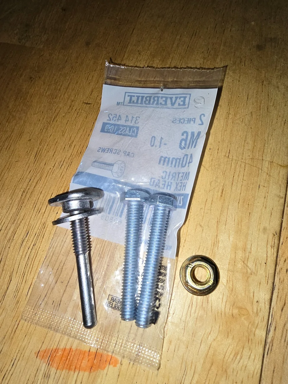

The best picture I could find online of a similar bolt is below, but the ones on our trucks have a much longer stud at the pilot end of the threads, probably 4-inches total length from head of bolt to pilot end. I am going to try order this bolt in the meantime and then will try a custom solution if this doesn't work.

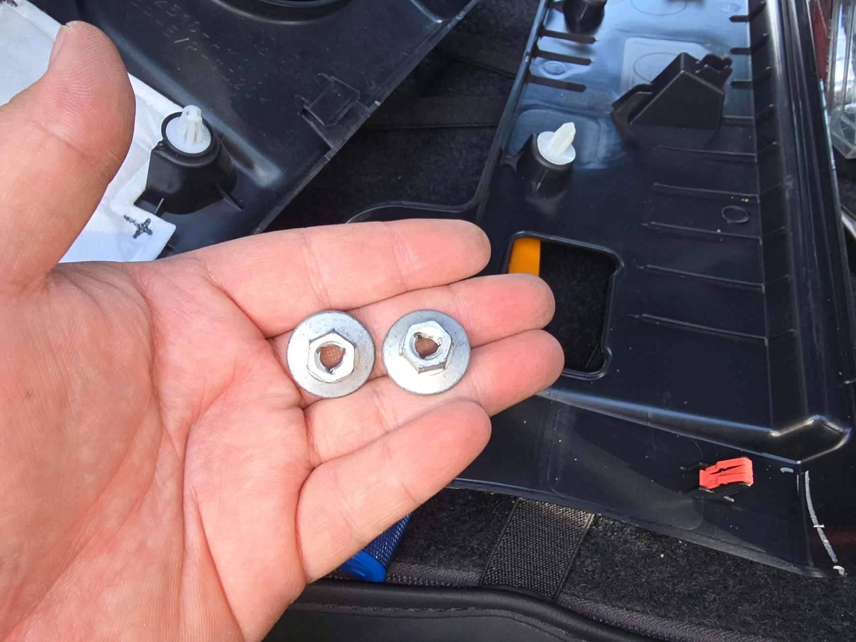

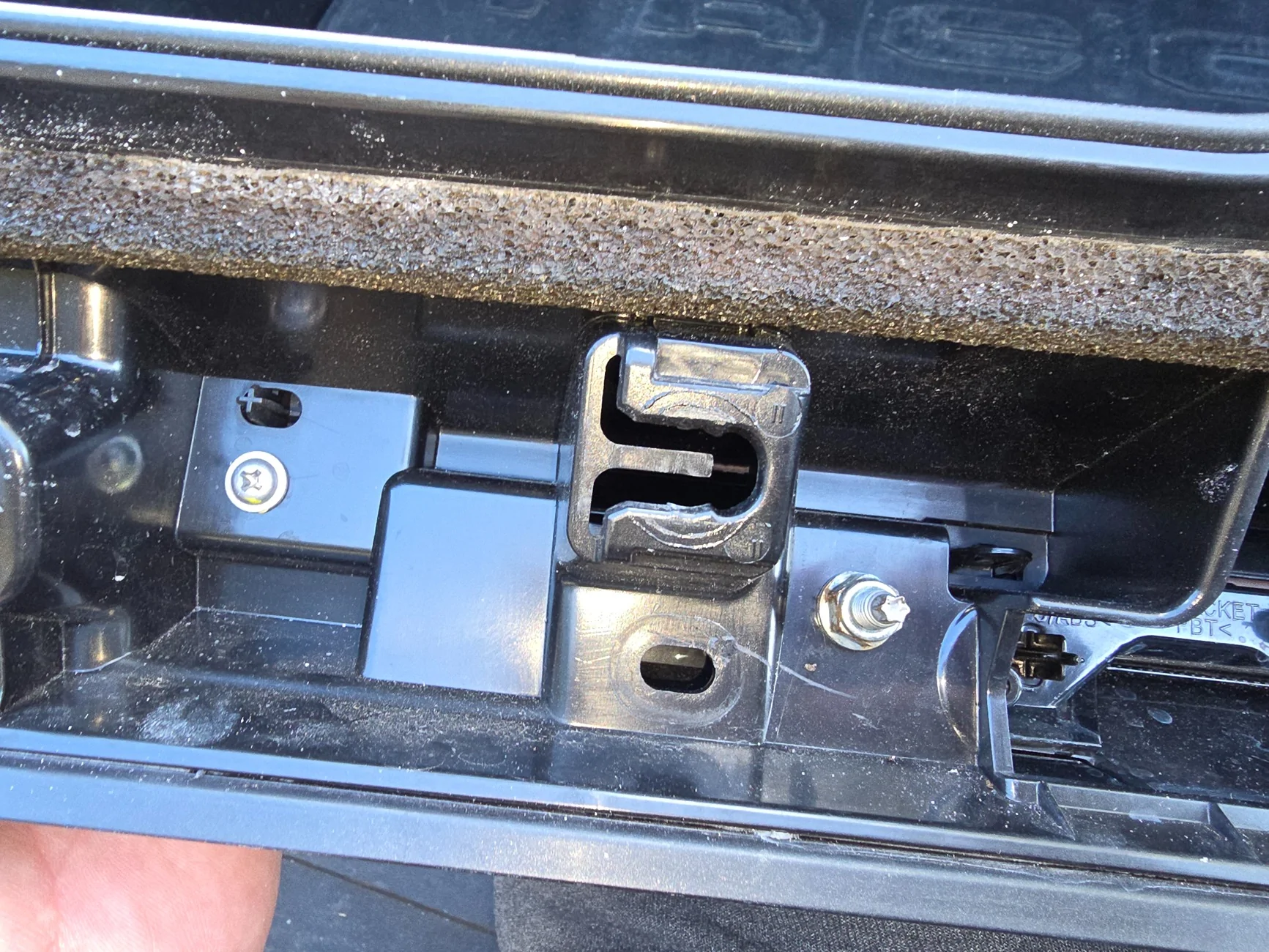

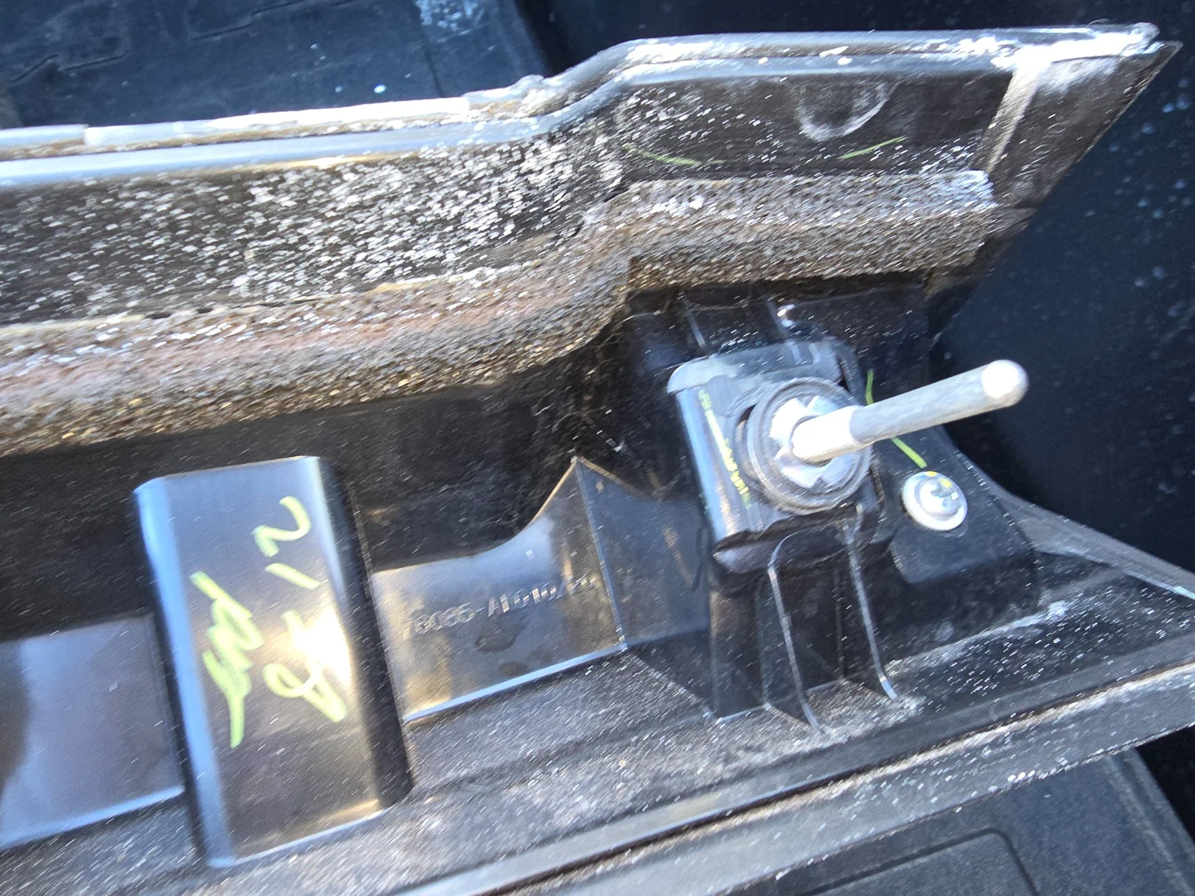

A picture of the bolt/stud from the backside of my spoiler is below. It is very similar to the hood scoop bolts in that the integrated washer directly below the head creates a space for the bolt to grab onto plastic trim. The spoiler bolt has a rubber washer below the integrated metal washer that seals against water intrusion from outside the cab. They are secured from inside the cab with these trippy looking flange nuts. Flange nut hex head is 10 mm. Google says the Toyota spoiler bolts are typically M6x1.0 threads although i am unsure if this is correct.
