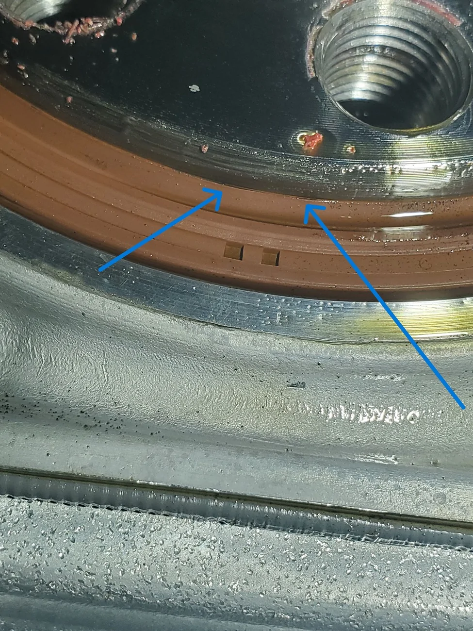

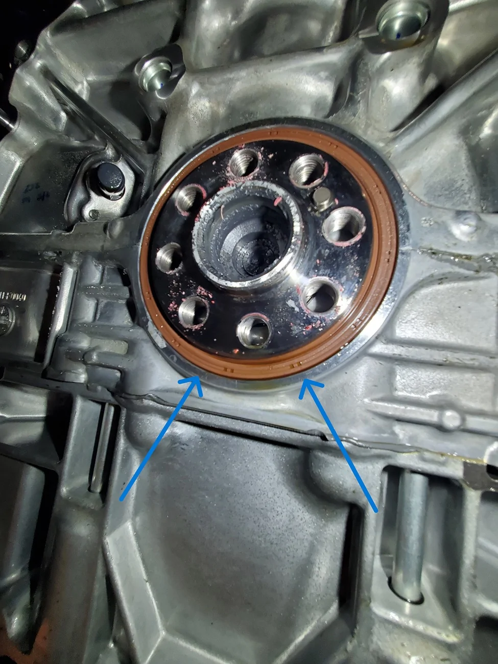

EagleTalon
Aug 27, 2025
2025 Toyota Tacoma Off Road
Truck repaired and back together. They road tested it , drove 30-45 kms and it’s blowing oil again.
Wow, yeah the rear mail seal is probably not it. I wonder if it’s too much crank pressure that’s causing it to blow and leak oil. Bad PCV? Piston rings?
